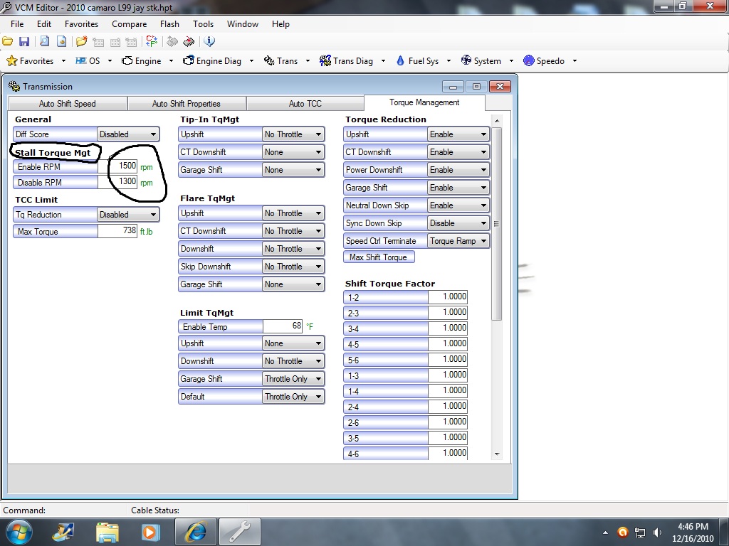

a6 has no launch control,, all you are feeling is the trans stall torque managment, the ecm is just shutting the throttle off to keep the tcm happy with whatever numbers you set in the stall torque mgt table,,, this table needs to be modified along with others when you add a stall converter otherwise even with a 3000+ rpm converter the ecm will keep the throttle only open enough to keep the rpm at these values.

Maybe launch control is misleading, ok, stall torque management. Hey, then it can be adjusted, in HP tuners anyway.

it is only torque mgt it can be set up higher but your stall converter determines your stall speed, it is just a safety measure in the ecm/tcm for the stock converter torque mgt,, it isnt launch control

That's the way I am leaning, that it is limited by the converter, but it still acts like launch control.
When I do it, I'm at the line with brake on, engine at 1300 rpm and the throttle on the floor. Then all I have to do is dump the brake.

yes it does work!! Holds at 1300 with no push.
Almost feels like pulling timing or shutting down fuel.
I am interested in knowing if this can be tuned for higher launches also.
