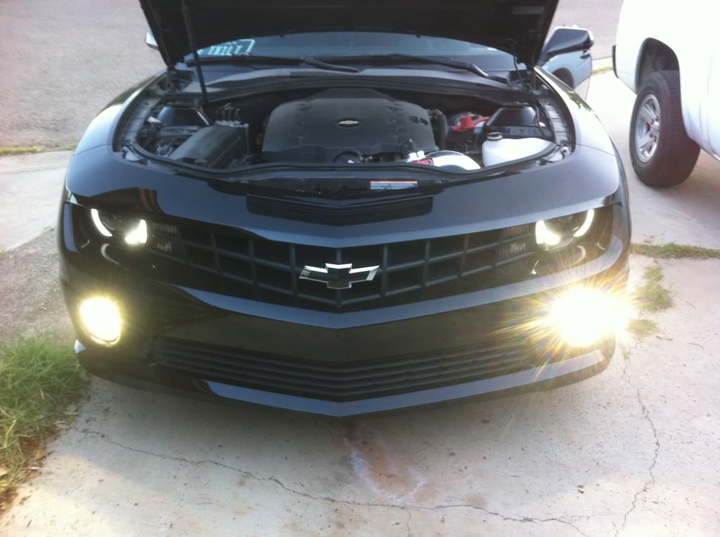

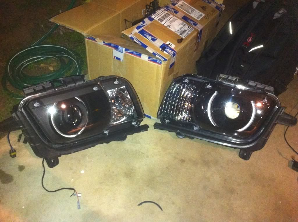

I installed mine with the AAC Harness. Everything works great. But, it isn't easy if your not used to soldering stuff. We weatherproofed the plug with sh*tloads of black elecrical tape. I can't stop staring at my car either. Lol I'm sitting in the waiting room of my doctor's office just staring at my car outside. Awesome.
Here's a few pics...
Here's the oem RS light on the right and an eagle eye headlight on the left.

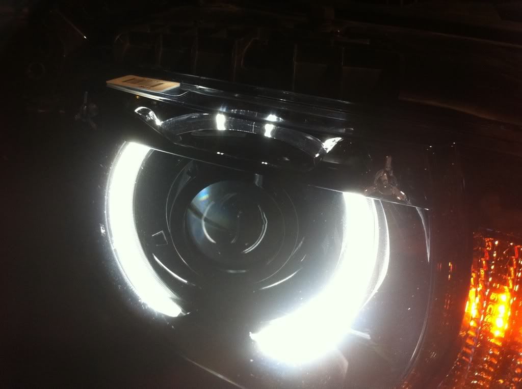

Here's a new mod I did, like Erk before me. I cut the left pin on the orange bulbs (the left side when 'sylvania' is facing you) now I can run my halos just like an RS. Thanks Erk! If you notice on the pics on top the orange lights are on. Now they're off. And blink only.
