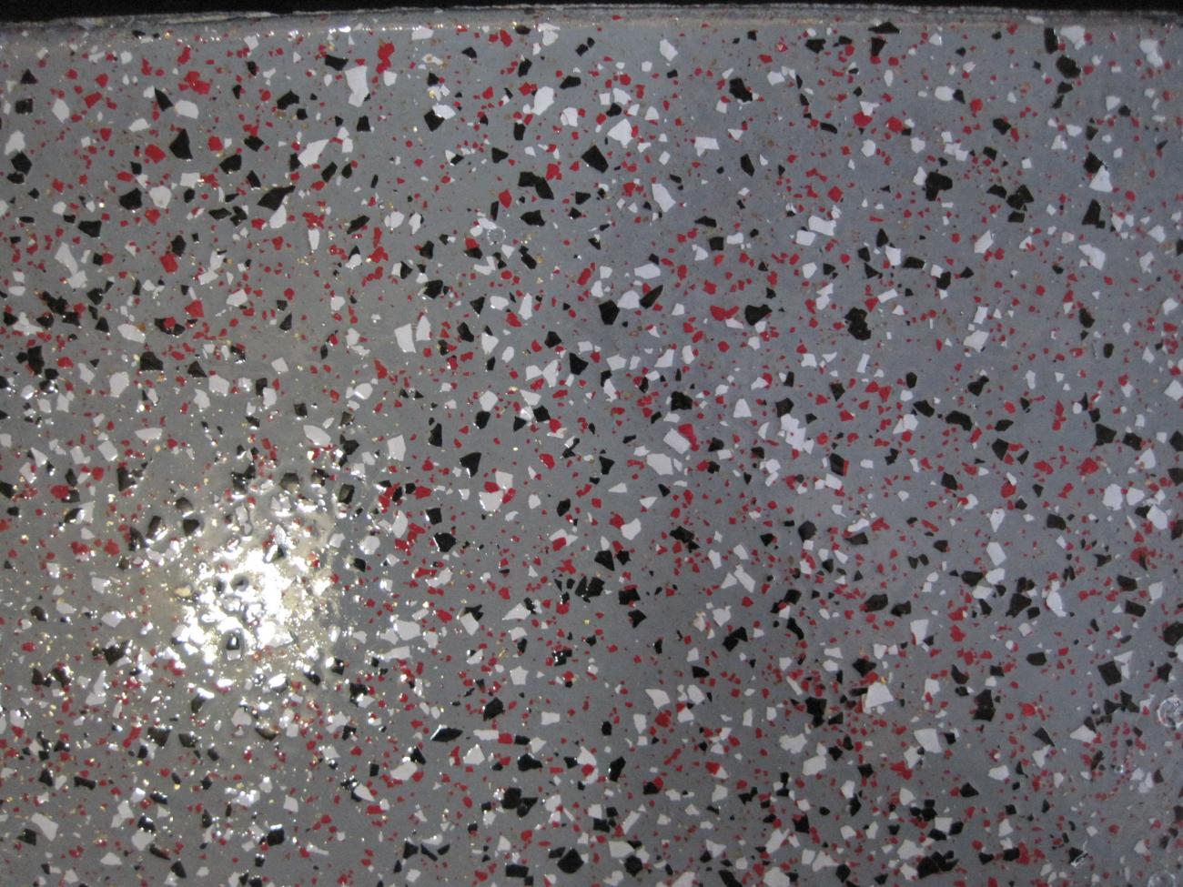

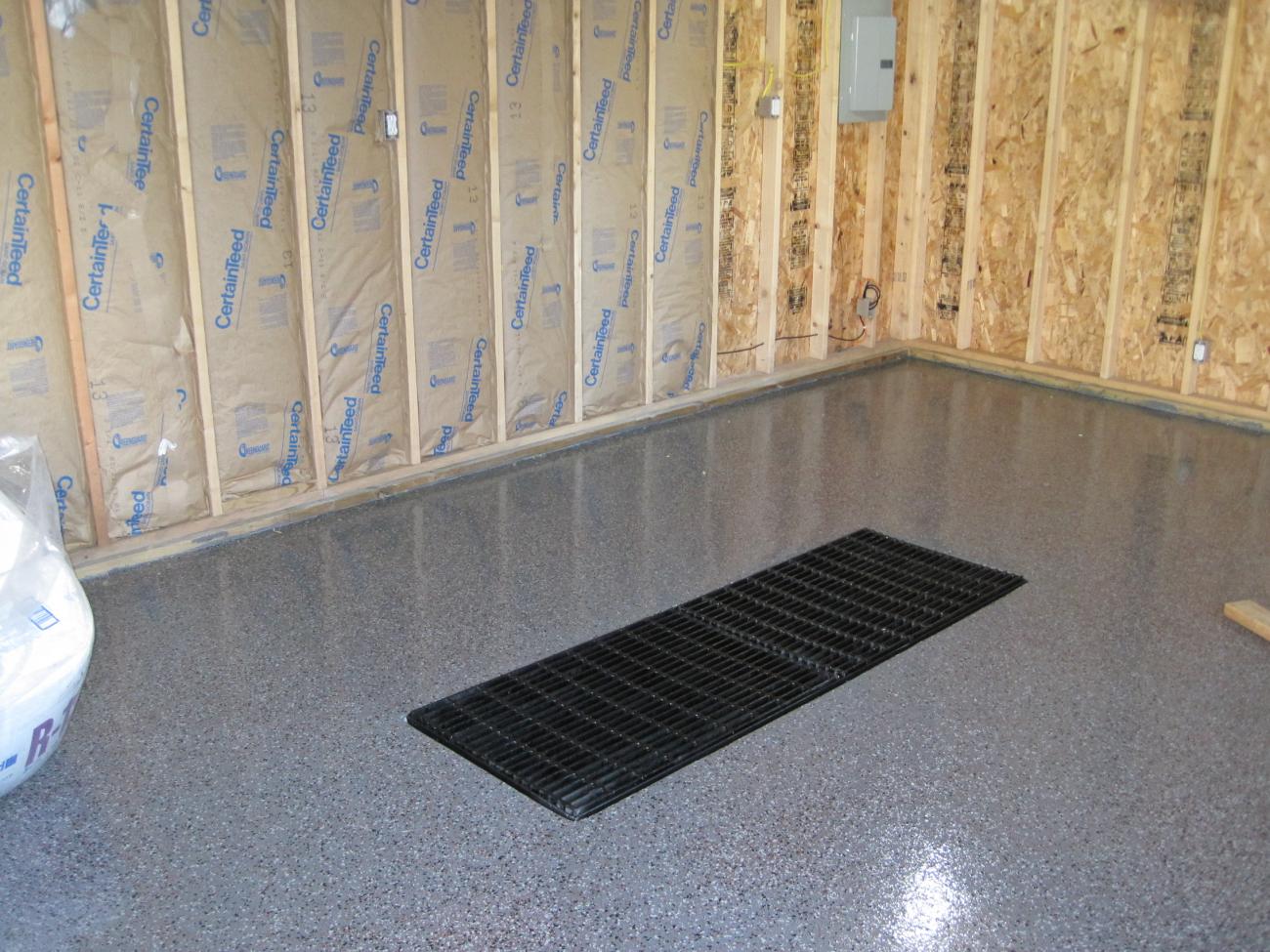

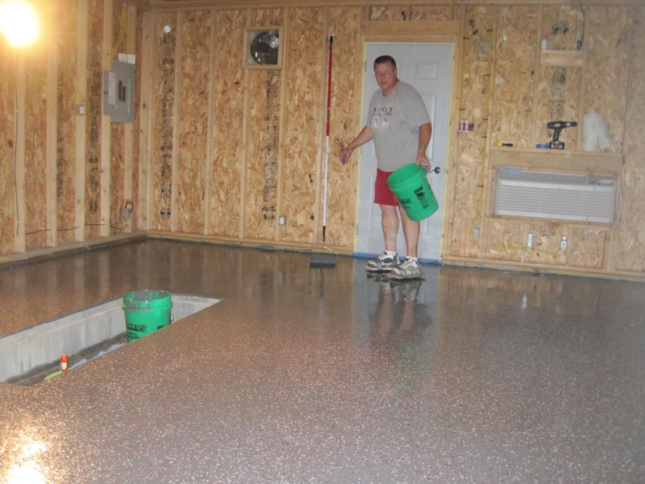

I think I researched dozens of different types of epoxy coatings and finally went with a product from the "originalcolorchips.com" company. I used the 2 part solvent borne epoxy called Devan 224HS. Then top coated with their solvent borne urathane. You can call them directly and they are very helpful. By thinning the expoxy slightly, I was able to allow the first coat to sink in to the concrete and have enough for a second coat before spreadoing the chips. Same goes with the urathane topcoat. I personally would stay away from the Menards/Home Depot rustoleum kits. Here is a link;
http://www.originalcolorchips.com/st...products_id=97
VERY pleased with the results;
Here's a video of the final garage and some pics;
Use some old golf shoes or micky-mouse some 2x4's with nails so you can walk on floor while coating AND while spreading your chips.

Man, that floor looks awesome!
