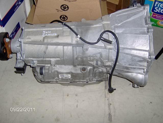

See this hose has the push pin still on it.

Originally Posted by SUX2BU View Post
You don't plug it in to anything. There should be a clip that the end of the hose clips into, Same thing down by the tail of the trans. It's a dual purpose hose. It acts like a vent and an overflow. That's why it has two ends, the one up high is for venting, the one down low is for overflow.
Like the drain plumbing in a house. One so that there is no suction. Sweet.
Yes sir.
Sounds like you have never been under your car. I spend almost as much time under cars as I do in them.
Here is where I got one of those pics.
http://www.gmhightechperformance.com...o/viewall.html
No i've spent some time under it, that pic just didnt look like what i remembered..but now that Im looking at it, it is a camaro...Well I've been under it to put headers and exhaust on it and now i just installed a 3800rpm FTI converter. I've probably done more work to mine MYSELF than most..
Thanks for the link. I figured it was just a vent and didnt connect to anything
