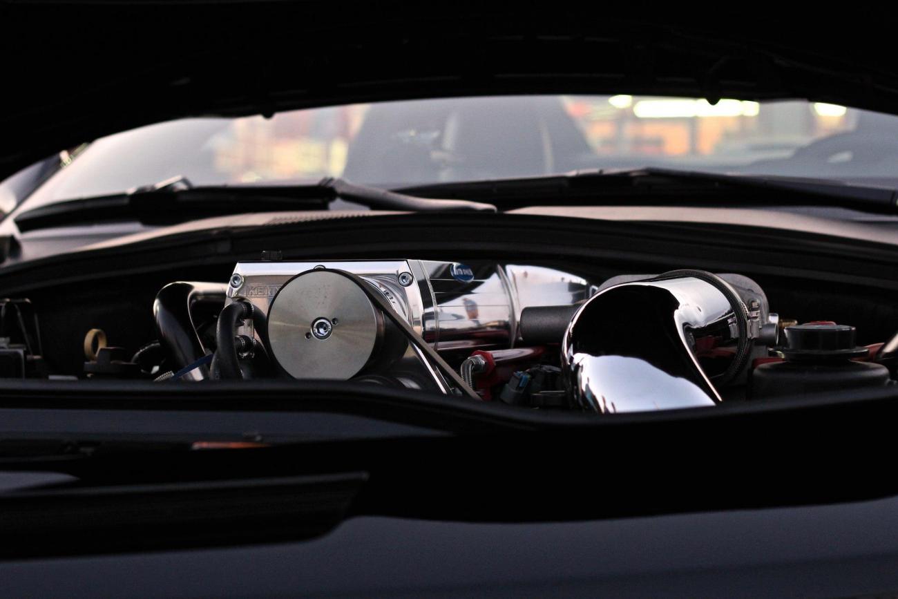

Heat Soak isn't that bad with the KB when you compare them to other PD blowers (running meth helps too), and IMO it's definitely the best looking one out there. They make tons of power (my L99 with headers, exhaust, and KB put down 536rwhp and gained 20rwhp with tuning meth for saftey (didn't even finish the tune to see how we can push it because I have a new build plan already). Only issue with them is the stock intake tube it too big. Ted from JRE can get that taken care of for you though.
Here's some eye candy for you.
