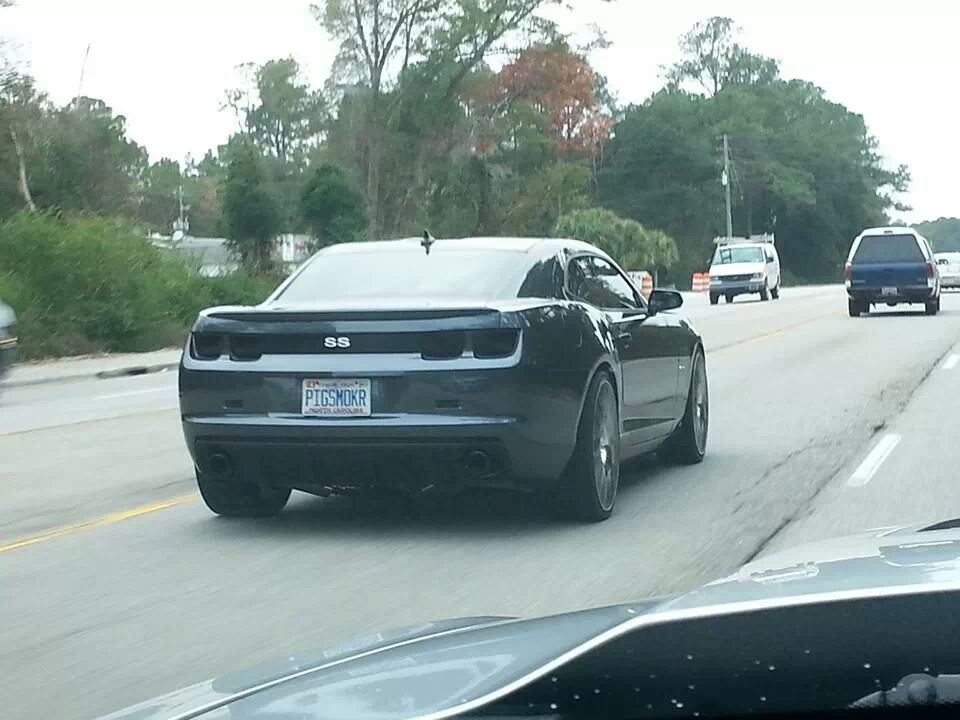

Hella nice build going on... Love the plate....

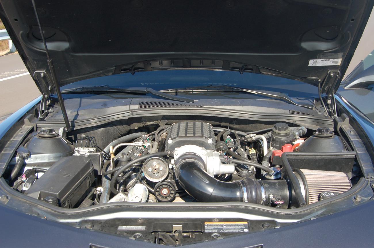

Getting all the kinks worked out sense the new motor. made some good numbers but still having major belt slip issues at 5500 rpms. 8 rib belt kit coming next and then should make some more hp.

How are you making 15psi without the 8 rib on?

With od cog and 3.2 front pulley. Having major belt slip issues still though.

I'm surprised you even saw that much with the amount of belt slip that had to be present. You'll get some slippage with the 8 rib too, just not as bad. Your next hurdle is going to be all the air packing up in the blower itself. After 13/14 psi chasing boost on that blower is a waste.

Yeah I'm trying to figure out if I want to make 800rwhp or more if it's smarter to just ditch this Magnuson and go with an f1 or a 4.2 kenne bell vs spending another $1500 on an 8 rib and still having the Same issues.
