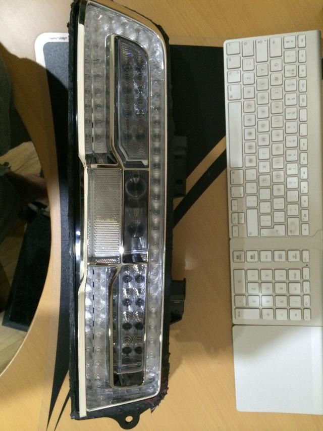

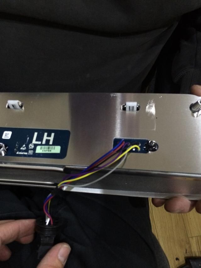

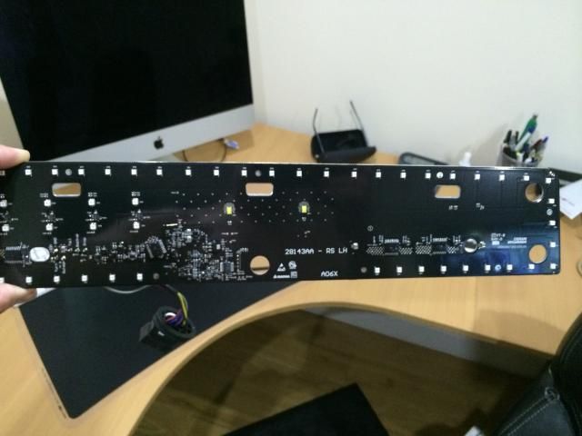

So today I went ahead and opened my 2014 RS LED tail lamp unit, I used a Dremel and cut around the lens between the black plastic and the lens and just very patiently took my time.
Here's the results:

Old 12-30-2014, 04:49 PM   #25
L7EWB
L7EWB's Avatar
Drives: 2014 2LT RS
Join Date: Nov 2014
Location: Essex
Posts: 42
Originally Posted by GDSPEED View Post
This. I want to see if its possible to make the area which doesn't light up (the inner part of each taillight) into a second turn signal...not sure if its possible though
After opening the lamp today I don't think what you want to do would be possible as there is hardly any space in the area that doesn't light up and every led is on the board.

Old 12-30-2014, 05:07 PM   #26
christianmotox
christianmotox's Avatar
Drives: ( . )( . )
Location: San Diego, CA
Posts: 2,827
mmm, so there are no LED's on the right side of the board only on the left side (im referring to the turn signal)..
it would be nice to see a sequential turn signal effect on the stop led's and a flashing pattern for hazard lights or show mode...
Lots of ideas to try.
