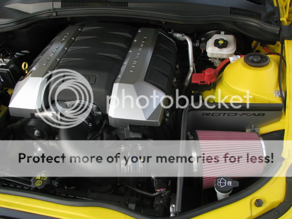

There are many choices out there! Here's a link to the description of the Roto-fab CAI system. If you scroll down to the middle of the page you will see some close up pics of the components as well as a good description explaining what makes our system different than the others on the market.
http://www.camaro5.com/forums/showth...install&page=4
