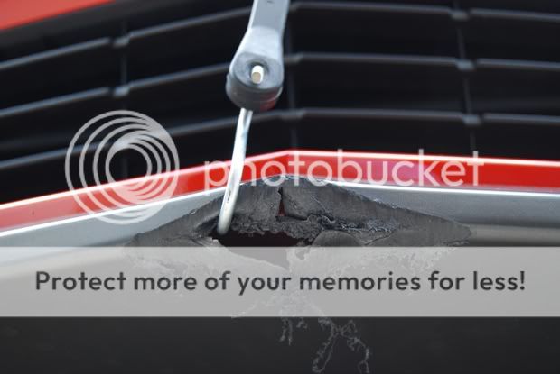

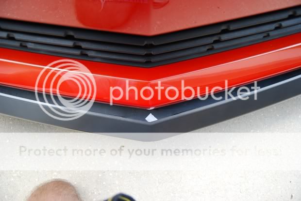

Front spoiler really loose!
As I was driving on I-75 yesterday I heard a thump, thump, thump, thump …………Quickly diagnosing in my mind; is it the pavement? tire? I don’t think so. I changed lanes, slowed down, and it stopped. I sped up again and it started. This time I noticed the hood vibrating violently. I slowed and looked for a good place to pull over. I pulled over and before I could get out a woman in an SUV pulled over in front of me. She said she was glad I stopped; she saw something hanging on the front of my car and wasn’t sure how to get my attention. I saw the center of the front spoiler was a couple of inches away from the car. I thanked her for her concern and told her what it was and she went on her way. The spoiler pulled away due to the air flow and was hitting the pavement! I got back in the car and tried to figure out what to do. It was 3 miles to the next exit and then I could take local roads back home. I wondered how fast I could go without a problem. Wait! I have a bungee cord in the trunk. As luck would have it, it scraped the road enough to create a convenient hole to place the bungee hook and the 15” bungee was the perfect length to hook behind the front grill. Bad way to start the weekend. I made it back home without the need to wait for On Star to send a tow truck. I’ll contact my dealer Monday and see what happens. With the spoiler still on, there doesn’t appear to be any other damage.

Across the front? The best I can tell without tearing it apart is that there are 8 plastic rivits along the back with two bolts in the back towards the center and the two bolts (one on each side) in front of the tires. The only thing holding it on toward the front is the adhesive.
It sure looks like they installed it without removing the front facia. I found a previous post from CamaroScotty that says there should be 16 rivits. I guess I need to watch them take this one off and then watch them put the new one on when they get it.

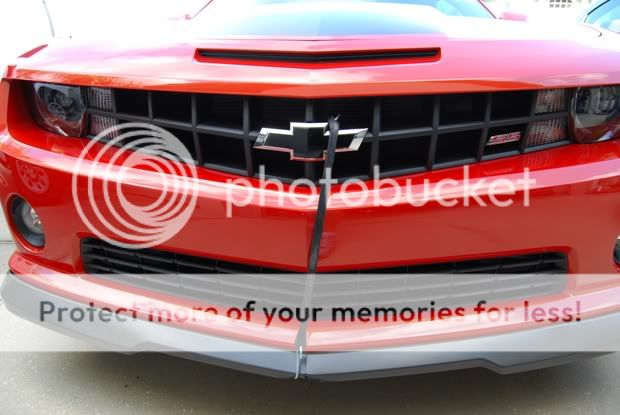

OK, this is interesting. I was looking at Camaro X's first picture and it dawned on me that my front GFX piece is mounted differently. Or it's made differently. Camaro X's looks like it was mounted under the existing lower body panel; mine looks like it was installed in front of that panel, and it partially wraps it. I also have a slight gap between the GFX and the panel right at the point, which makes me think that the dealer bent the GFX to make it fit that way.
Does that make sense? Anyone else have it mounted that way?

Posts: 168
Here are a couple of pictures.
It looks like it is mounted in the right spot, but the center looks like it is higher then the fascia. The proper mounting is just below the radius of the fascia at center then it will have a gradual downward slant out to the sides.
Also if you "paint to match" the ground effect its suppose to void the warranty of the ground effects. GM only supports the factory grey color. (09-08-51-002)
that gap in the center...looked like your dealer worked from the sides to the center/middle so they ended up with a "slack" in the center that they dried to massage.
