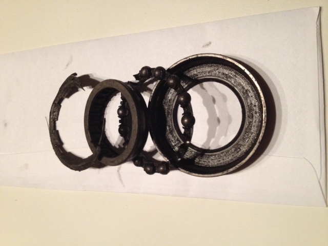

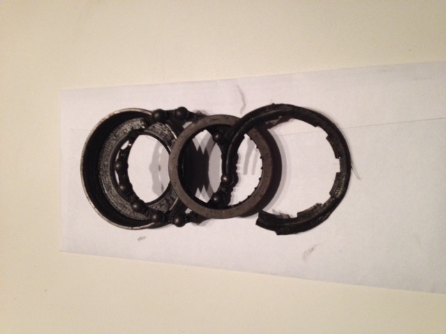

Not sure about the rattle, but in my experience, a bad throwout bearing will squeal loudly with clutch engaged (clutch pedal up) and go away when pedal is slightly depressed.
well figured out what was my issue. throwout bearing fell apart. my noise happened when the clutch pedal was up and clutch engaged. it was a loud squealing noise and would go away as soon as i pressed the clutch in a little. the noise would come and go and for awhile there, i thought it went away for good, but i had already placed an order for a monster clutch and scheduled the work. so today it was there at SNL performance and the clutch, flywheel, slave, pilot and throwout bearing replaced.
