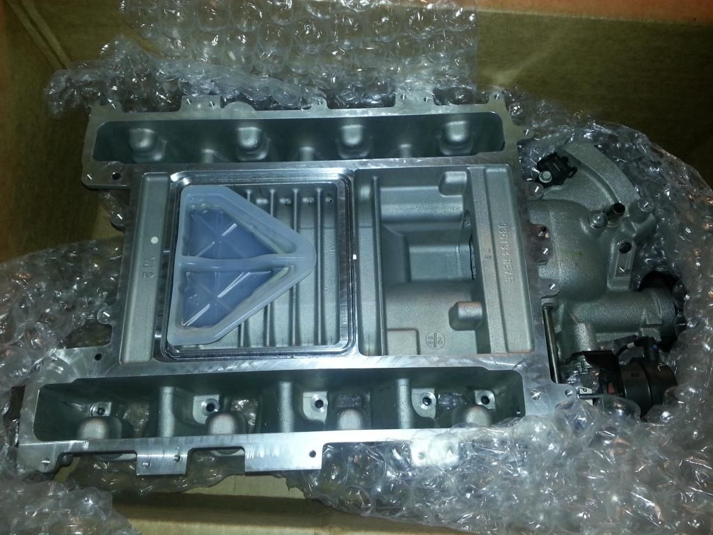

Just out of curiosity, did you happen to leave in the wedge in the blower?
Just want to make sure...

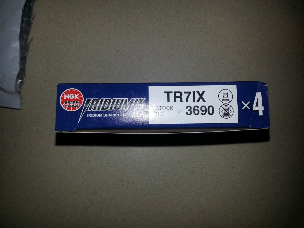

Stock SS plugs won't be correct. You'll want to install and gap these NGKs (mine are set to .040)
They are specifically for this setup...
Not sure if the ZR1's AC/Delcos are incorrect -- that may be up to ADM to say. I know the ones I have were spec'd for this kit...
-Don

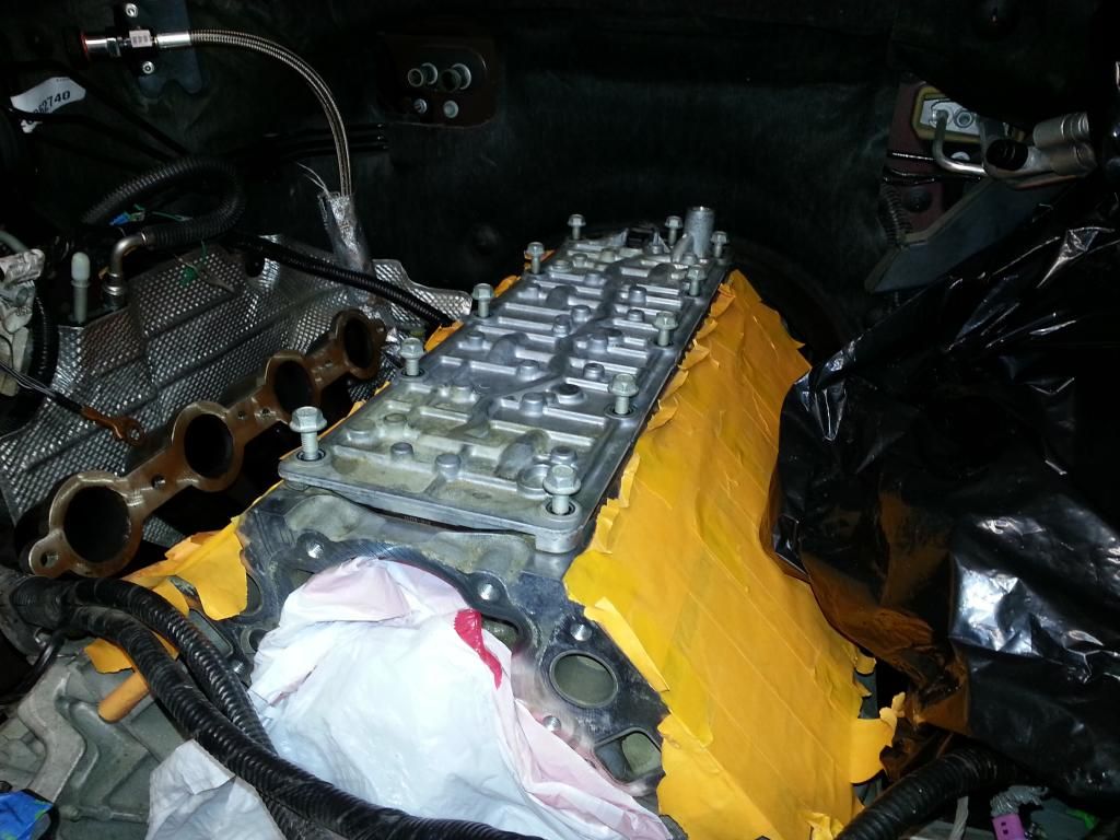

I know some have the SS pump in until they make more power. Before going that route, you'll want to verify the 'little' things first -- once those are done, then you can verify the fuel delivery. You'll want to make sure you have what the 'kit' was designed for (and since you're a 'stock' L99), it would be best to make sure of that -- Is AFM disabled and do you still have the L99 valley cover on (Lifter Oil Manifold Assembly LOMA:

My blower did not have the wedge, so it is open and clear. I got AFM disabled when I had my headers installed earlier this year, but I do still have the factory L99 valley cover in place. I did not install the DOD delete kit. The instructions from ADM indicated that it should work fine retaining it and that the LS3 valley cover was not a requirement.

NP, the valley cover is not a requirement -- just asking.
I can't comment on the plugs -- since I went with what was recommended -- Andy will know for sure on those.
Good to know about the blower dust cover -- just eliminating 'unseen' items to be sure. I've seen where those were left in and it killed the performance...
