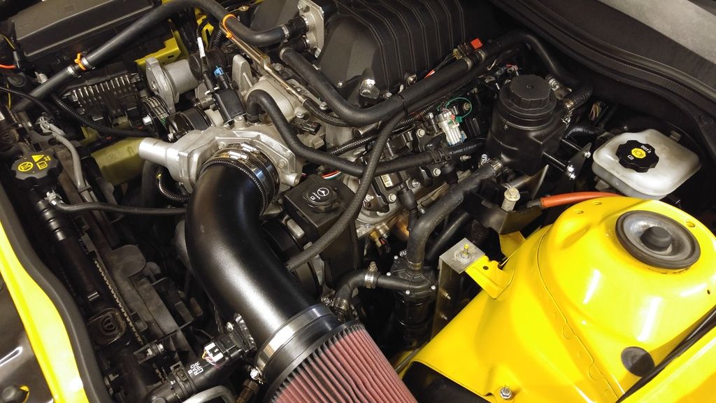

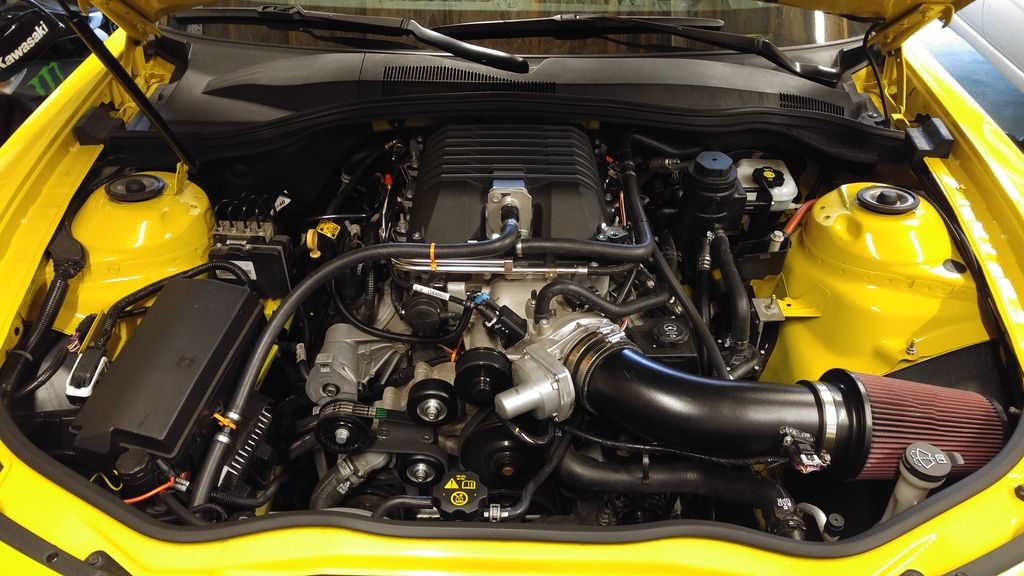

Post up picks of the engine bay,Lets get a visual on whats under the hood.
I want to see the Intake setup and install as well as the belt routing etc.

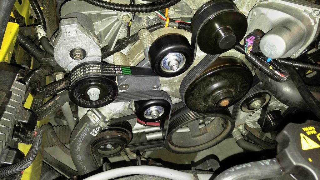

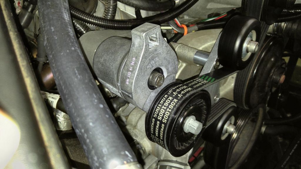

The belt I have on the car right now is the one recommended on ADMs website. It took a lot of wrangling to get it on and it felt SUPER tight so I ordered a slightly longer belt. However, having run the recommended for about a week now, the tensioner adjustment indicators appear to be within the proper range as indicated in one of the pictures below, so I'm sticking with it for the time being and keeping the slightly longer one I purchased as a backup.
Throughout the tuning process Alex said he did not see or hear any indication of belt slip at all, so he felt it was safe to rule that one out.

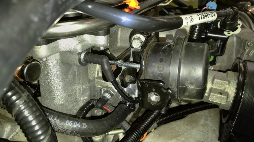

As far as checking the bypass valve to ensure it is closing 100%, can that be done without removing the intake/supercharger lid and looking? Can I just disconnect the actuator arm and see if it moves back into the closed position any further and then adjust the controller mounting accordingly?

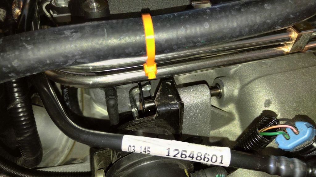

If that is the current setting for the boost bypass, that is way to wide open. It should be just a fraction on the set screw. If that is not closing, you're leaking boost. If you see mine, even without the tool, you can get it close. You'll need to loosen the bolts on the boost valve and make sure the arm is not pulling the valve open, which it looks like it is.
The pump does not need to be reoriented . It appears to be upright
I'd correct the boost bypass valve and make sure it's set correctly.

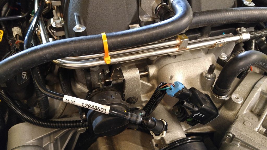

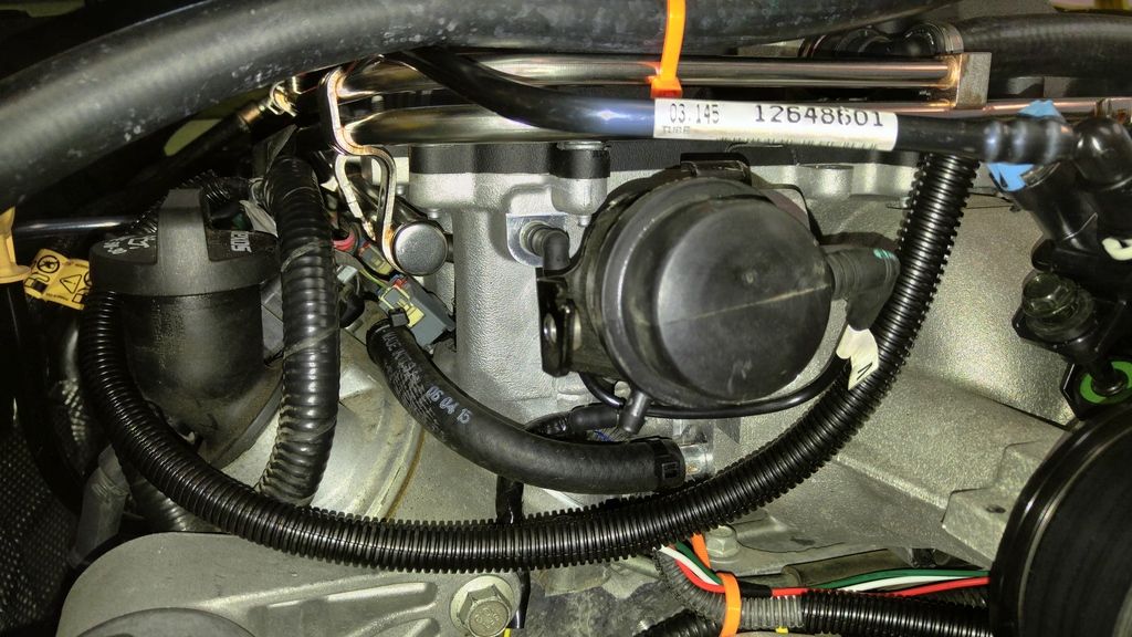

Mine:
Yours:
I bet boost is bleeding off...

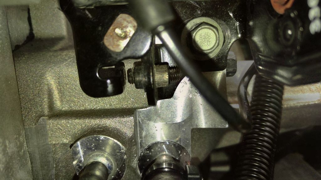

Hey Don, thanks for the input on that. I found the portion of your install that went over that so I went out and tried adjusting it. I haven't done anything with the adjustment screw but I did ensure that the orientation of the boost bypass had the actuator at its default closed position - it would not move any further back. At this point I tightened down the bolts while doing my best to position the adjustment screw just a fraction away from the bracket on the arm as shown below.

Looks like its still too far away. You need it to be closer to the set screw. I physically hold the valve shut loosen the bolts again and try to adjust the vacuum switch so the set screw kisses the arm on the valve. That will get you close. Then adjust the set screw 1/4 turn in. Do that until you get the tool...
