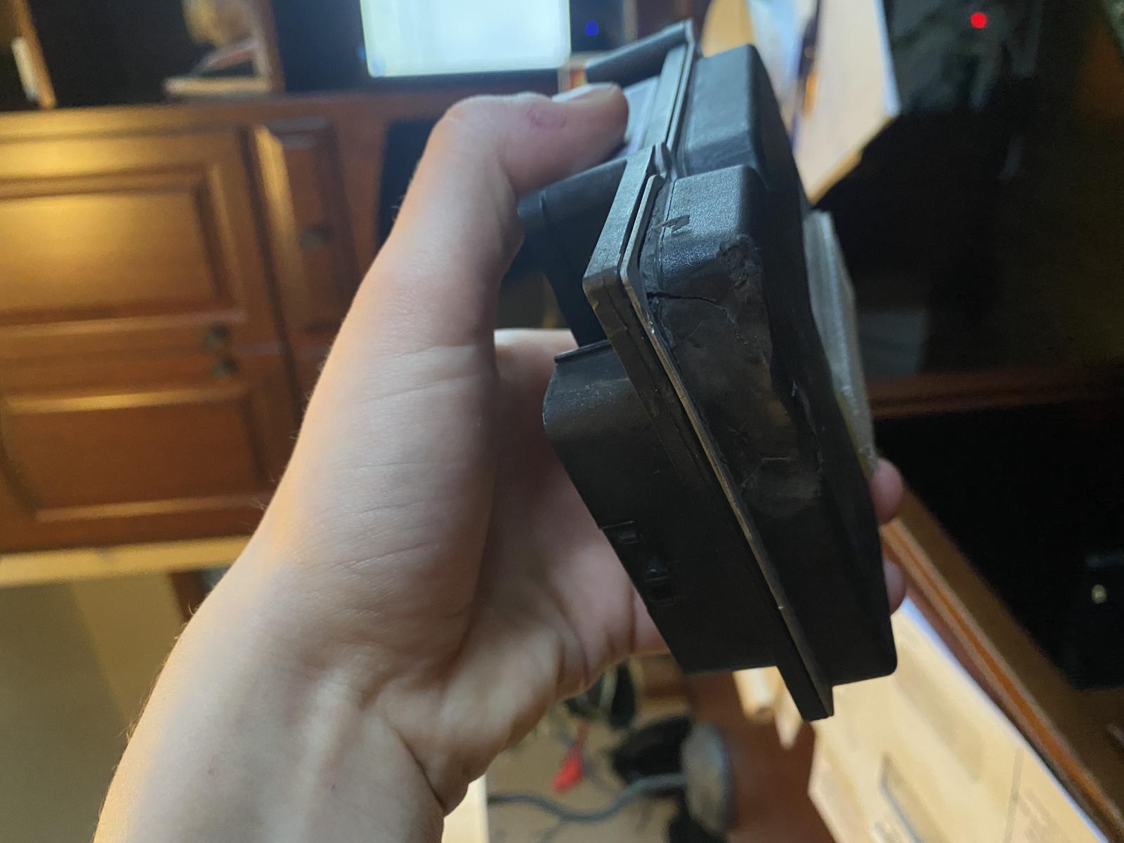

I ordered a used ebcm for $30 on ebay. Upon removing my ebcm I noticed the bottom corner that was not visible is cracked. I believe the owner before me that originally did the swap must have busted the module when pulling motor. I installed the used module without programming and all is fixed!
Brandonlin152 is offline   Reply With Quote
AWESOME! Man it really makes me feel good when I can help someone!

As much as the advice that turn out correct was important, it was good you updated the thread so people could know what symptoms and conditions and repairs might apply to them. As they search for a fix someday.
