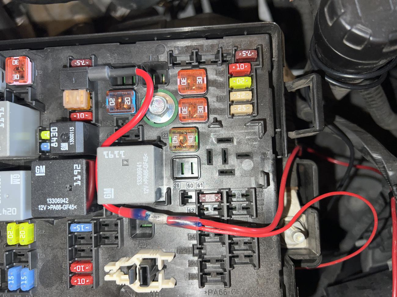

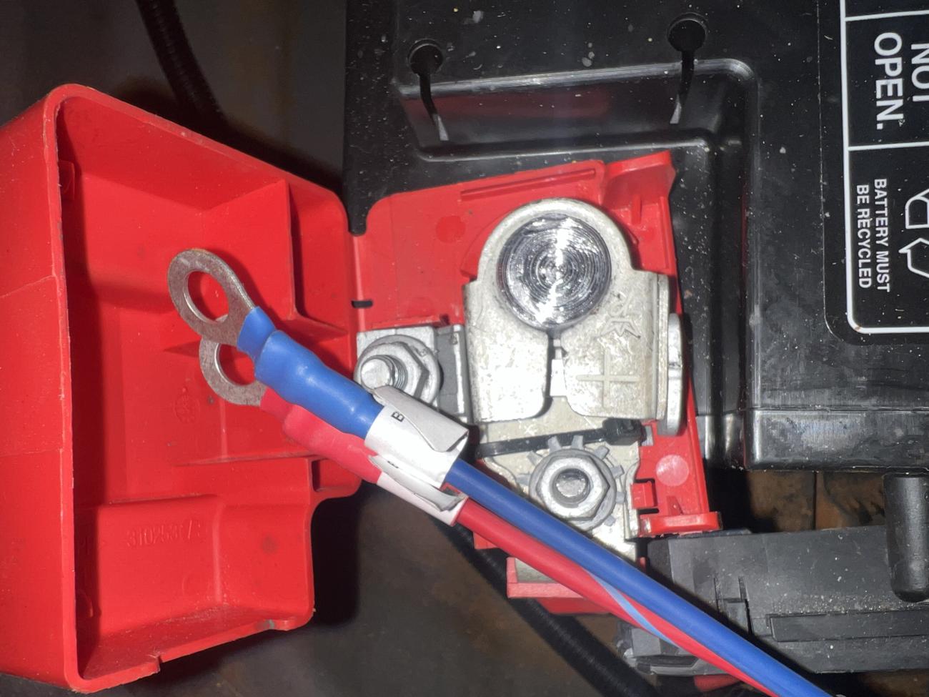

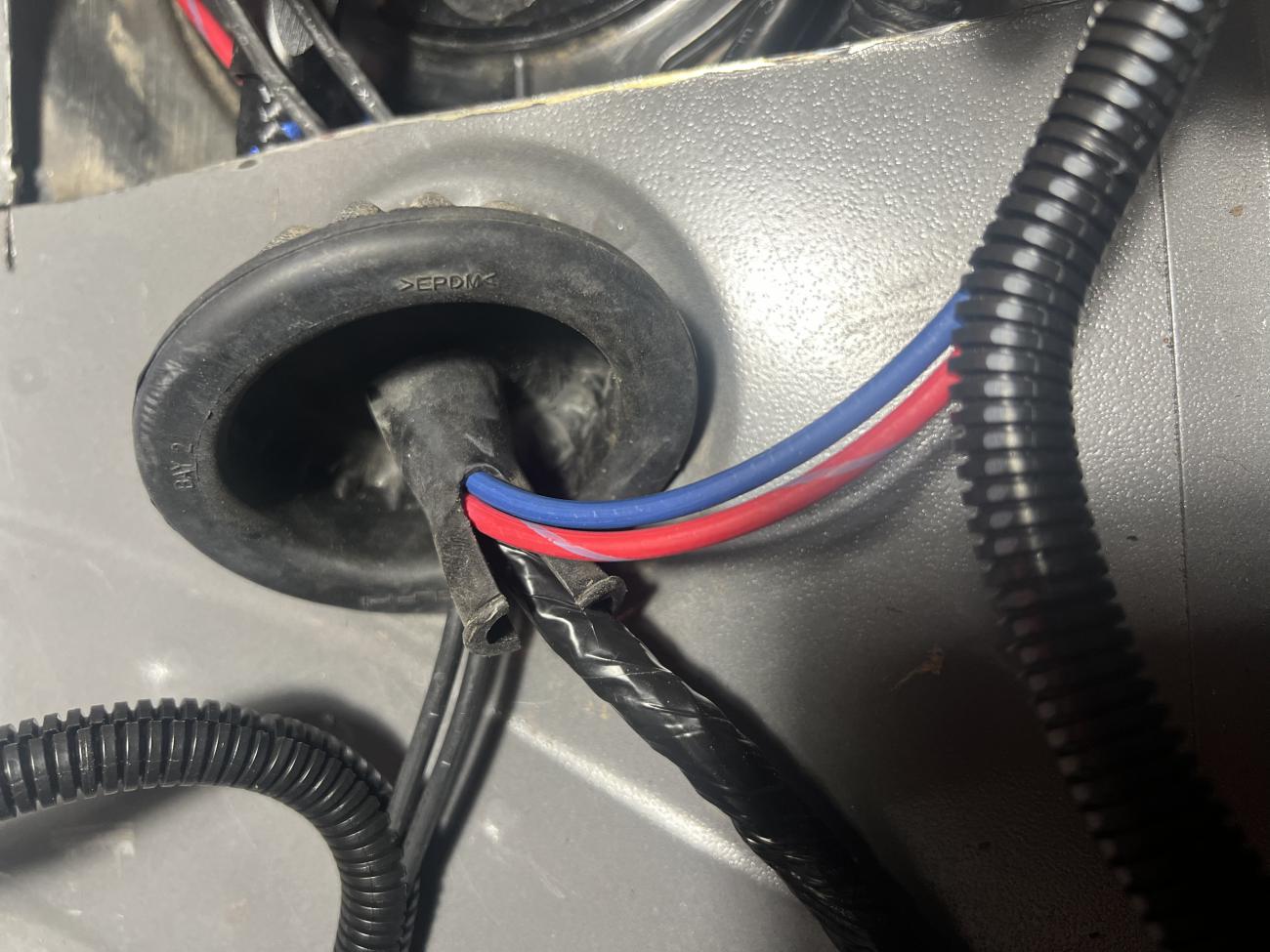

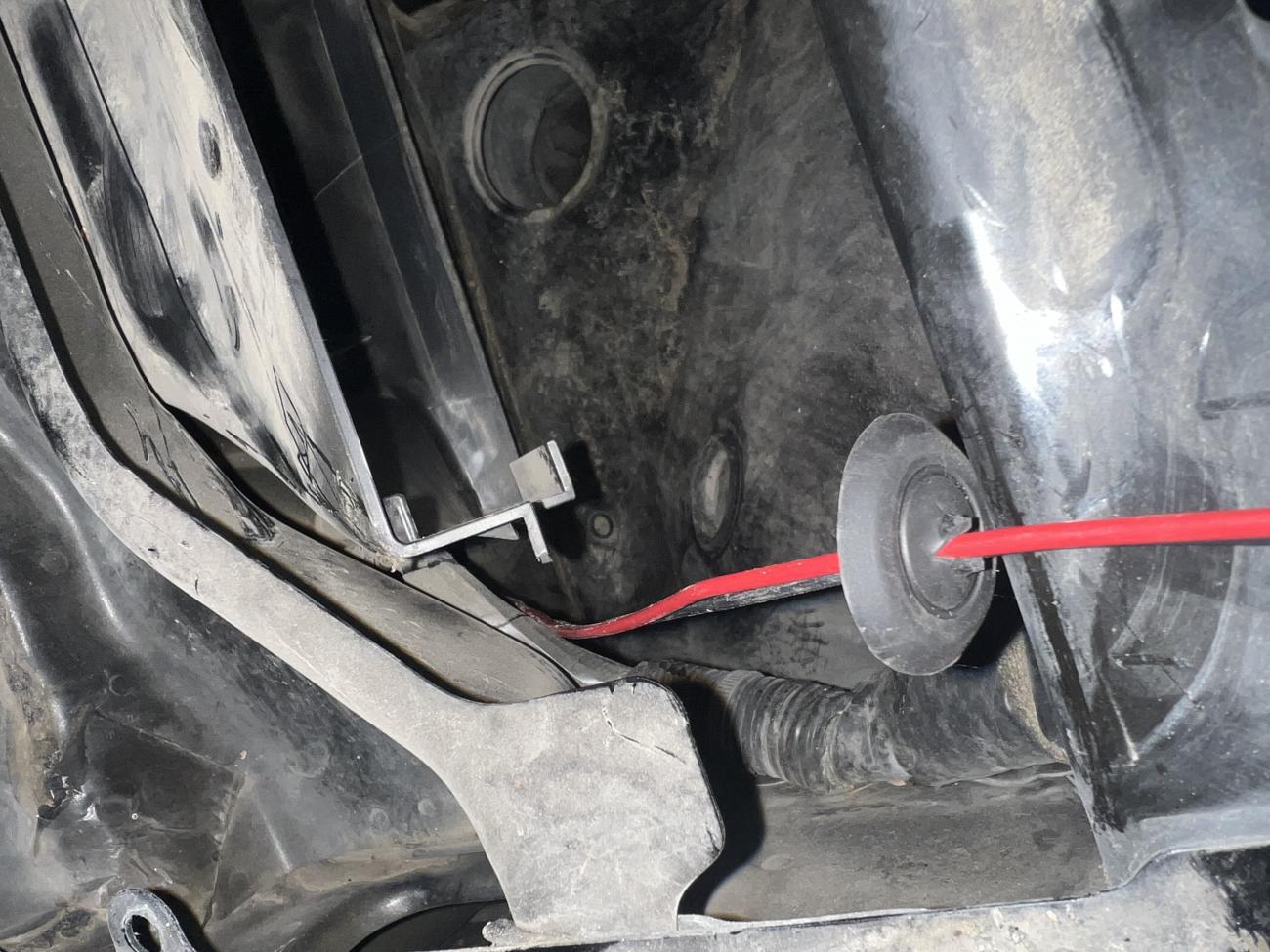

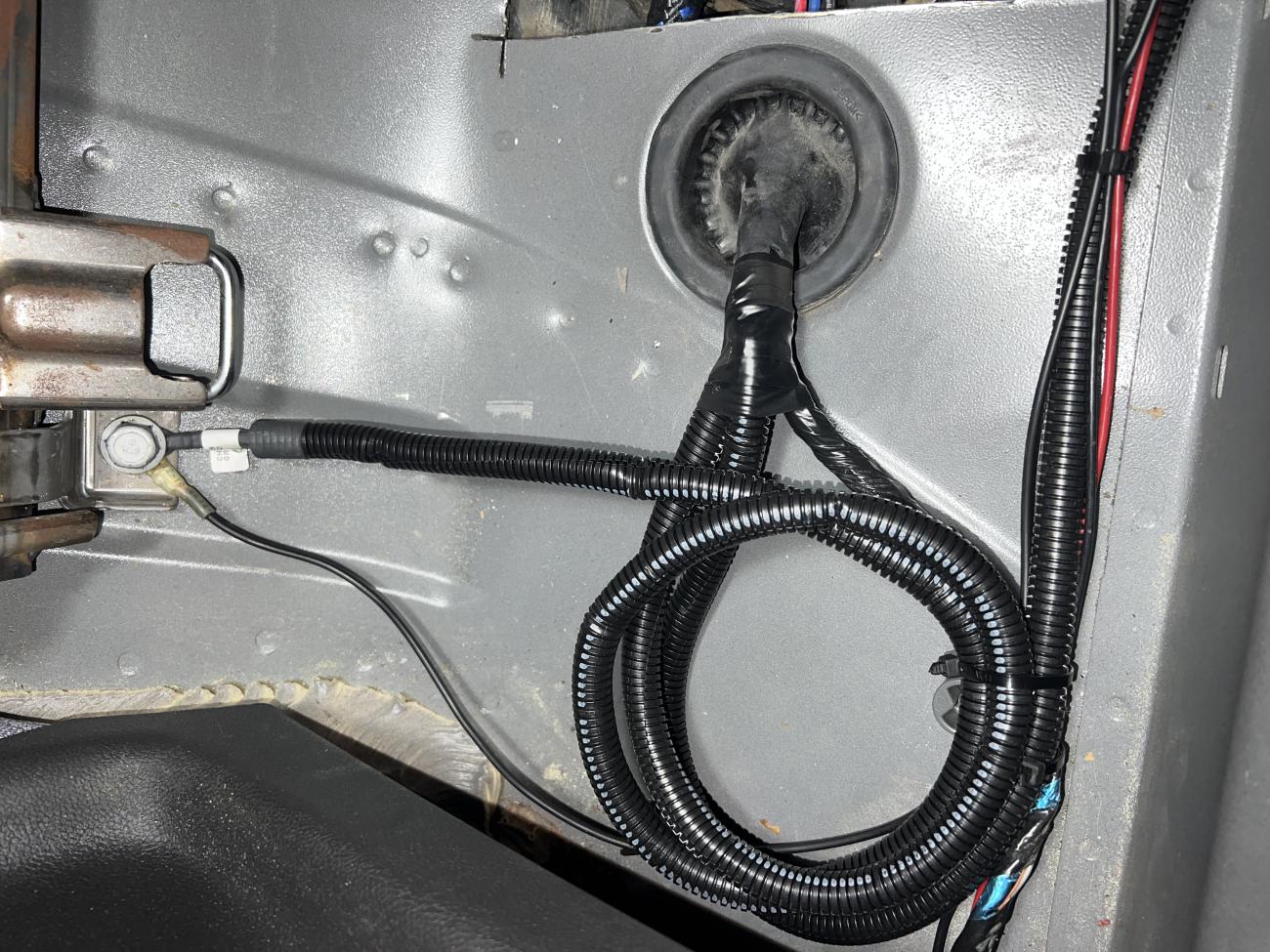

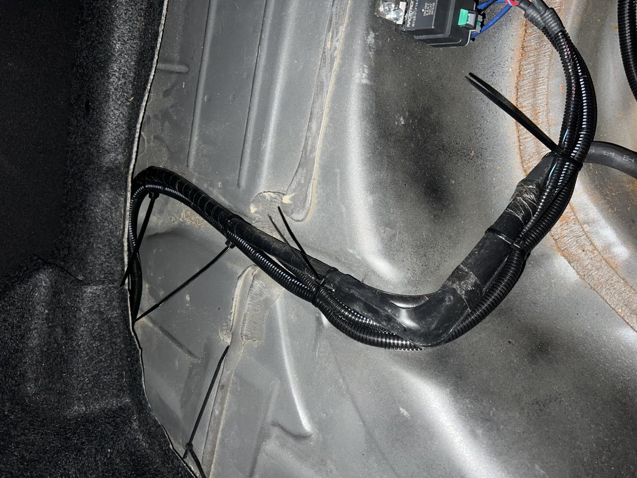

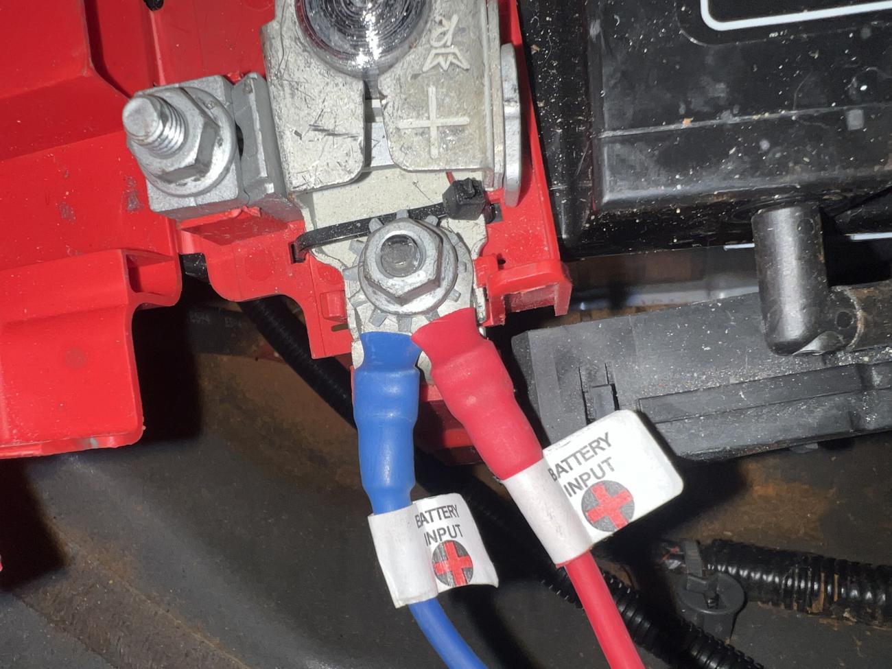

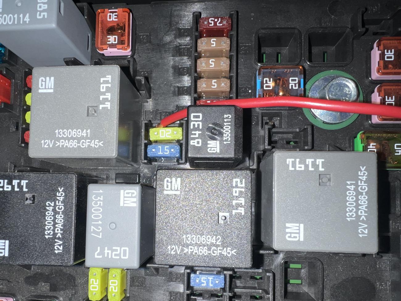

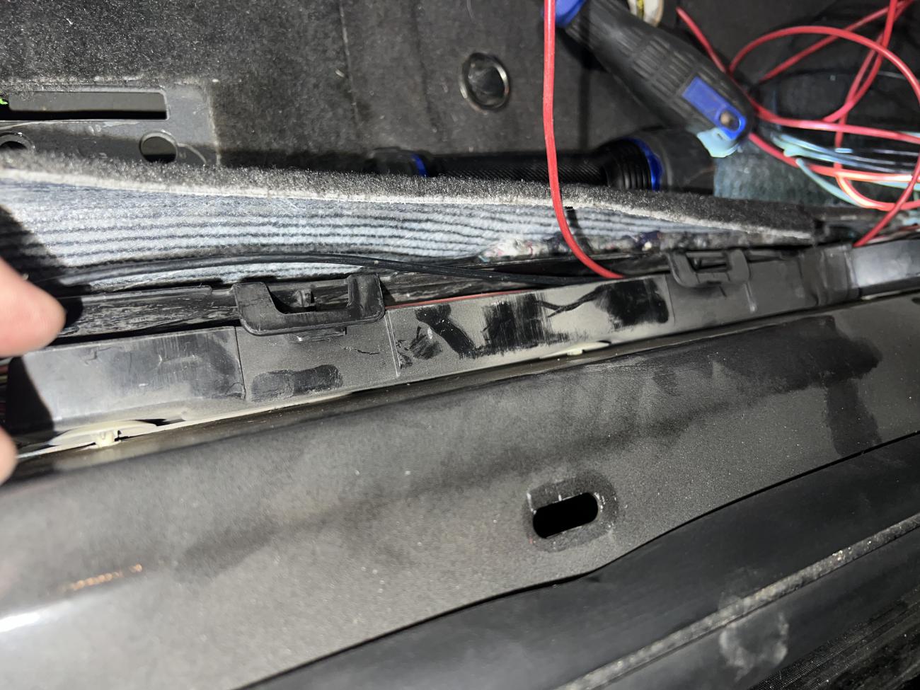

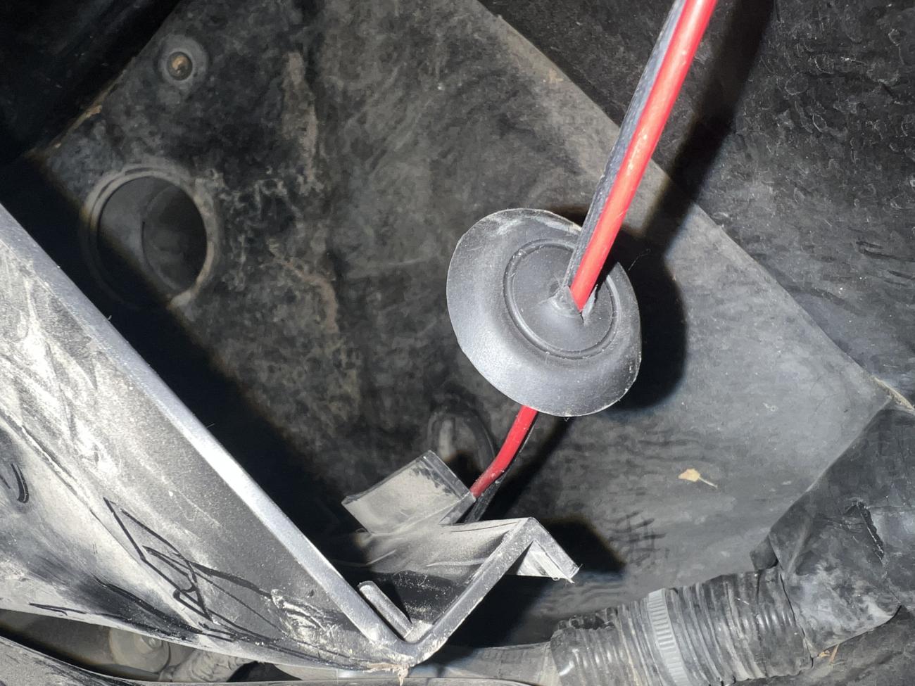

10 Started by installing my relays in the trunk wheel well and tuning wires under rear seat. Hooking up big blue and red and the chassis grounds to the seat bracket.
11 Hooked up the blue and white sending unit wires and zip ties along the main red power wire from battery.

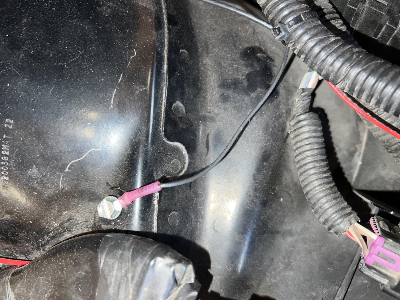

12 mounted my Hobbs switch by my power brake booster on a block on fire wall I have to hook up a few other vacuum items for supercharger also and I’m meticulous when it comes to what I see! Also will be using as a ground not hot circuit to power secondary pump circuit…

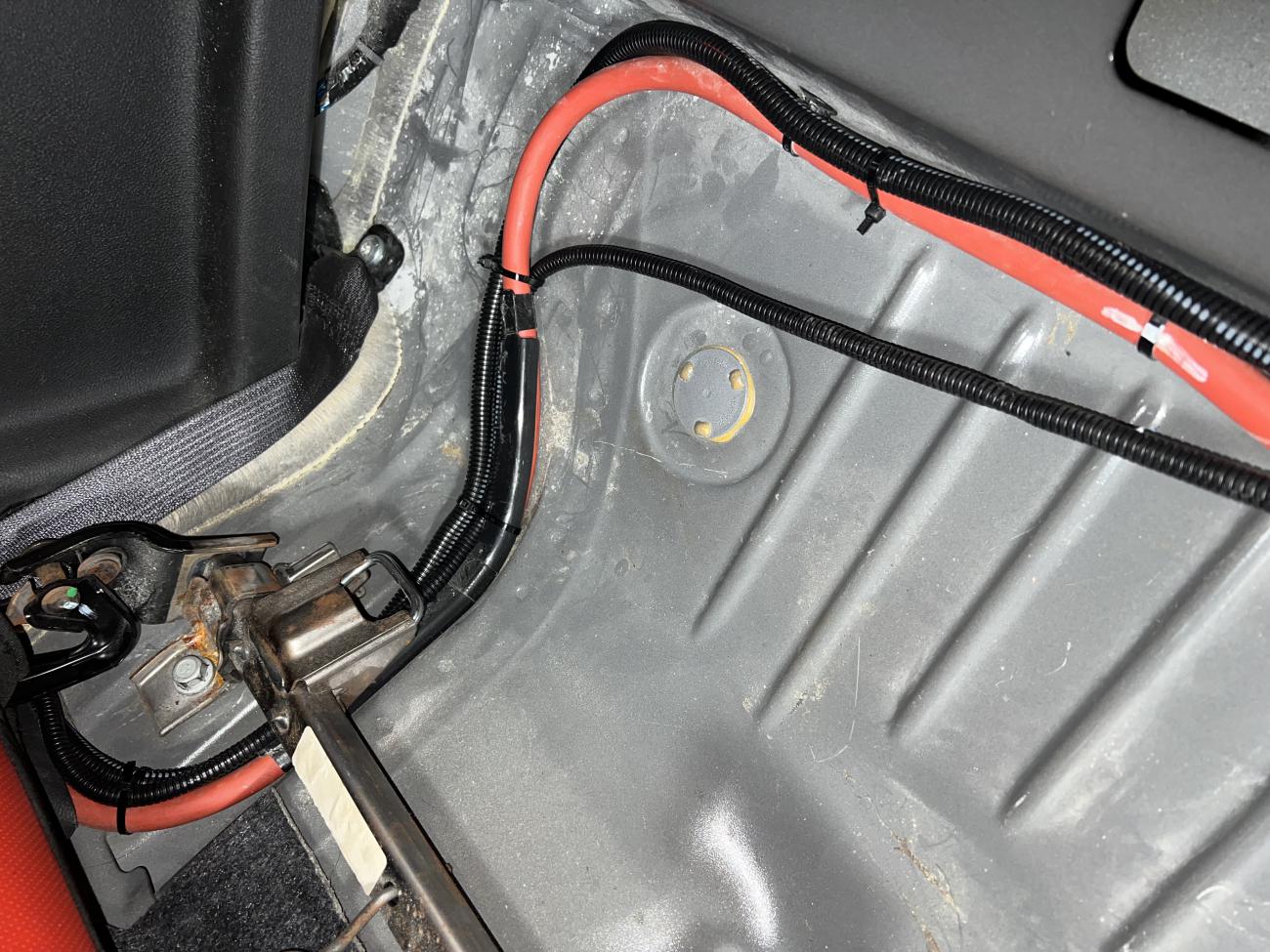

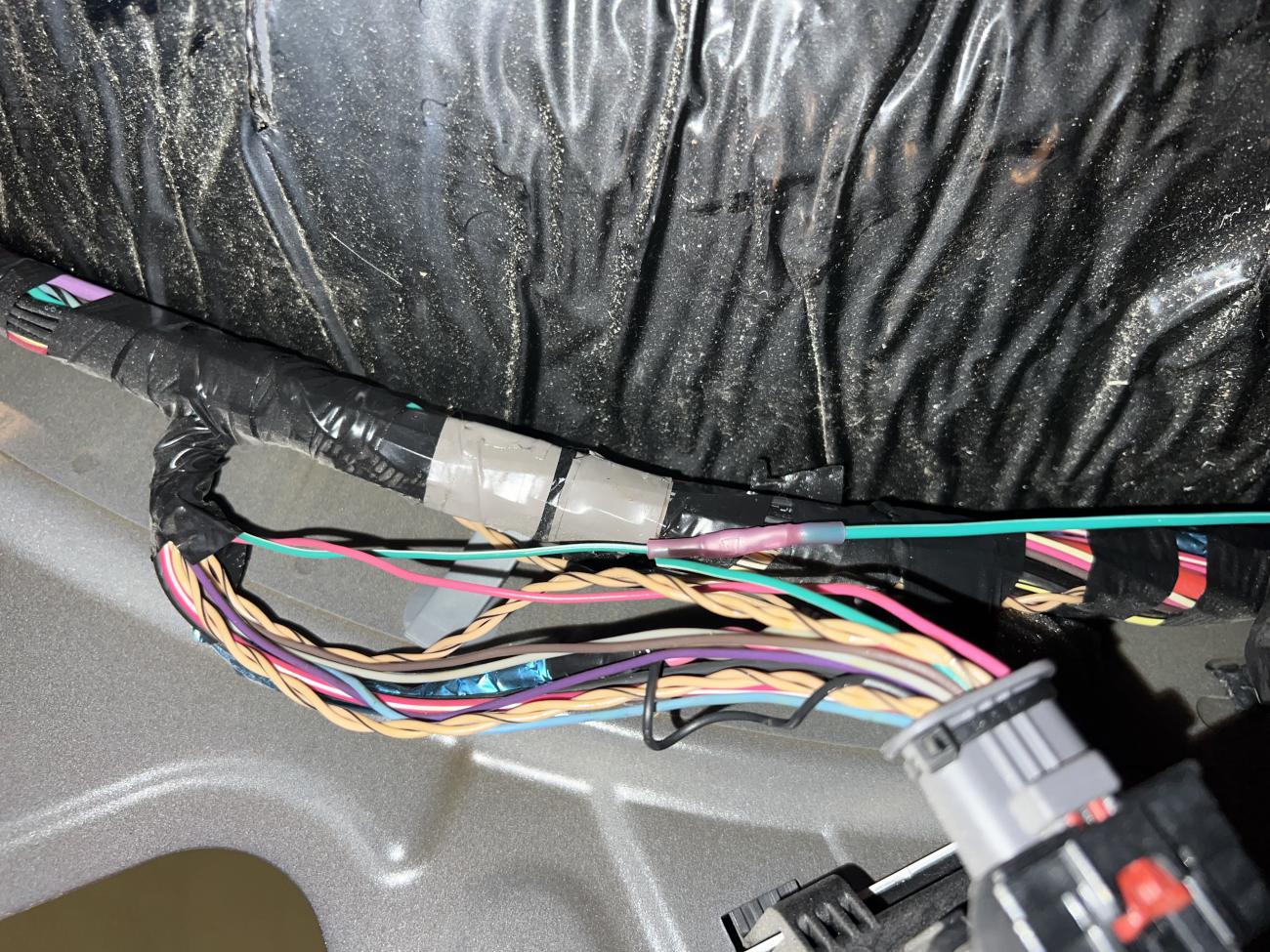

13 Then ran a black and red wire from engine bay to back seat use wire way by passenger seat and utilize the pug by AC system and Cabin air filter to run wires.
Black wire is ground for Hobbs secondary pump relay and red is for both relay power from ignition source out of fuse box.

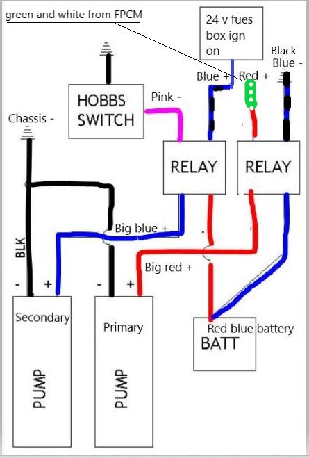

wire diagram
Hope this helps
Updated

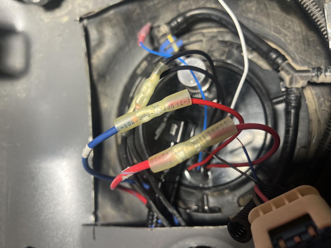

13 For the wiring on the pump lets start with the main wires. Blue and red + positive off relays with ring ends to battery hook them up last. Two big red and blue are for the pump main power out of harness the go to the two reds coming out of pump. The two black wires out of pump go the chassis ground - supplied by agp as well I hooked them to the seat bracket bolt.
14 For the relay control wires I used the Hobbs switch as a ground to activate secondary pump pink - wire. The blue with black striped + and red + are the positive to relays brought a red wire from fuse box in engine bay and off an ignition on fuse to power what key is on, the black with blue - to the chassis ground under seat bracket bolt as well.
To me this was much more simpler than the AGP instructions had laid out and is why I made a diagram, Might be the Engineer in me but much more simple to understand.
Next Ill get into the HP tuner but my car is running and the second pump sounds bad ass as the fuel runs through it and returns and my pressure is set about 44 PSI!!!

Note that I switched to the green and white wire and now have prime, I like it much better...
Will update flex fuel installation soon. It is working and reading 10.2 corn on gas in fuel in my HP Tuner

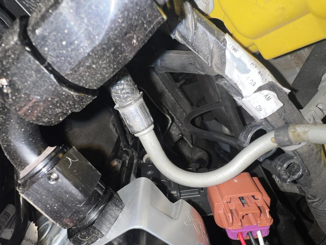

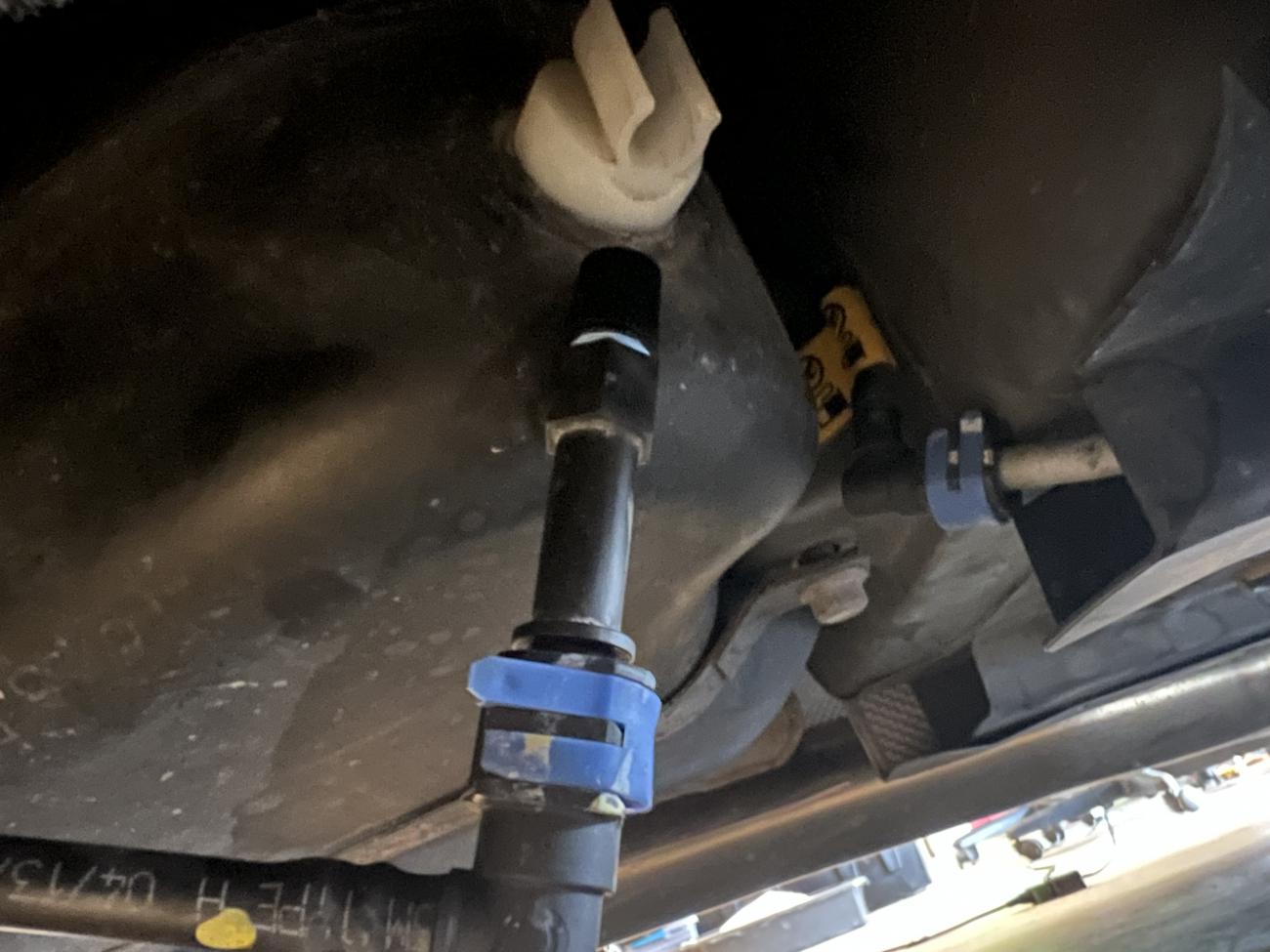

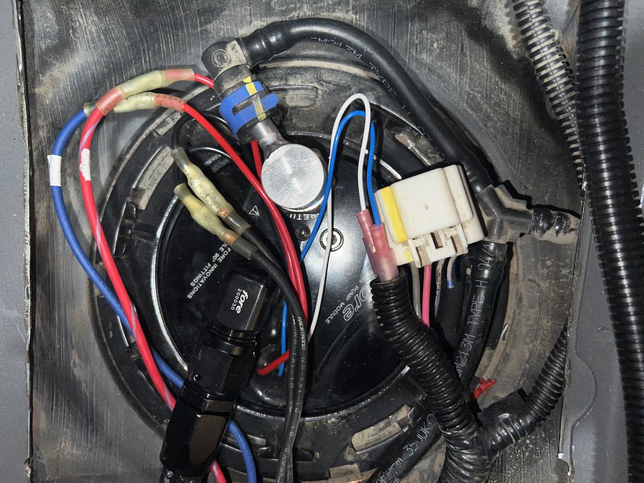

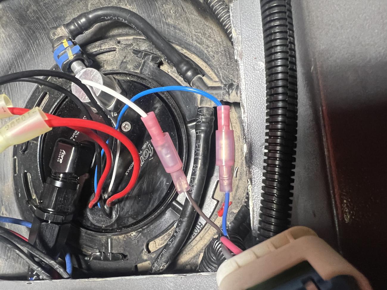

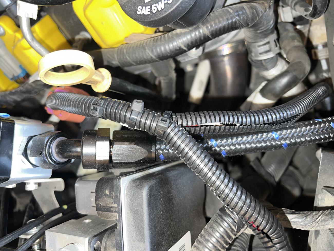

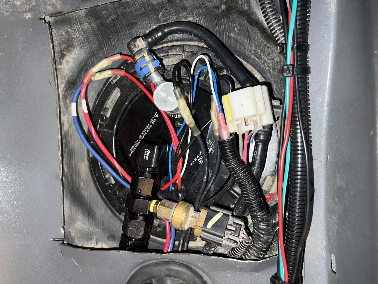

FPCM Green White and Fuel sensor
Just a few updated pics, Moved the sensor up to the pump and checked HP Tuner was reading great... It was easy and just caped the old line that is return line now. $16 in parts off amazon!
Also a few pics of the flex sensor install.

Pics green and flex
