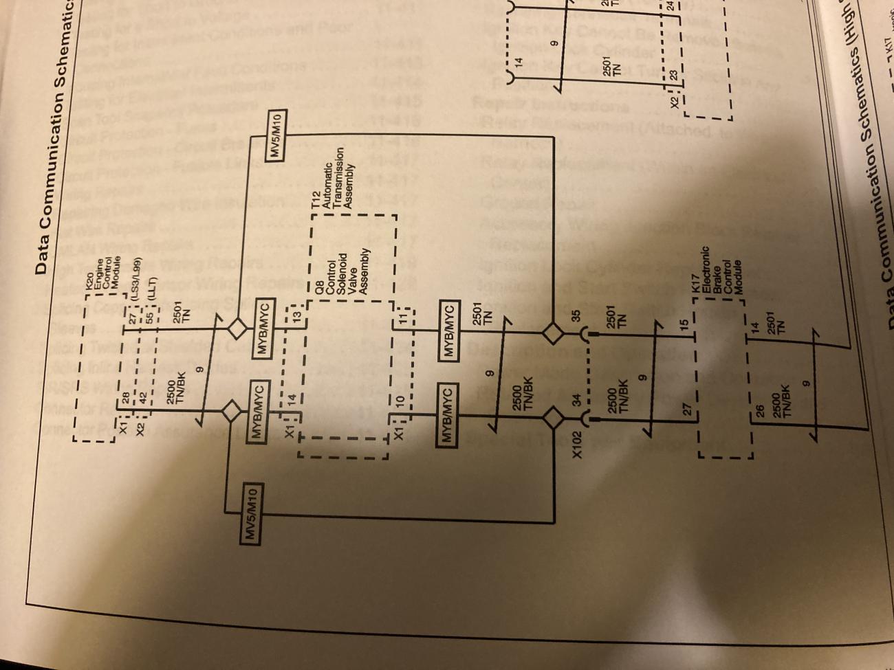

The best I can tell from the picture of the broken pin, that is actually pin 14 which is the data wire coming from the ECM. I have to mirror the image since the manual pictures the other side of the connector but I think I figured it out. If I’m right then that should be your problem.

I don’t know that the numbers stamped inside the connector necessarily match the wiring diagrams in the manual. In the first picture of the connector that was posted, it has an alignment mark that has to be lined up to check the PIN number on the harness side.
I agree that the wiring color needs to be checked.
You are not going to have any luck trying to reattach the pin. Maybe a slight chance it can be repinned with the harness removed from the transmission.

I'm not 100% sure on how the data transmission works, but if it is pin 14 from the end connector view I posted, you might be able to spice the wire from 14 into the wire from pin 10. I THINK it would still allow everything to talk on the network.

Here is the 16 pin socket & connector. When I click on the tcm this is what lights up. I wonder if your B+ circuit is broken because of this pin.
