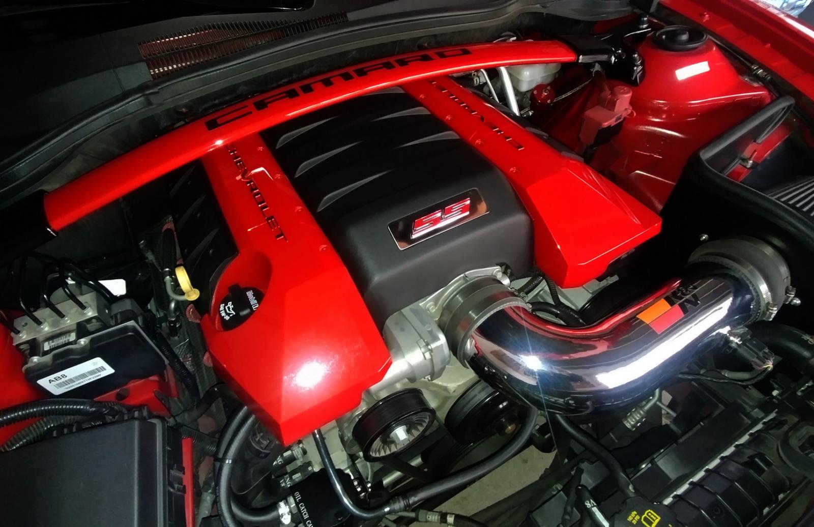

Id like to add one to my engine bay, even its for minimal benefit but I have an early 2010 and im pretty sure almost any I add to a 2010 requires me dropping suspension to install and at that point, the minimal benefit isnt worth it.
I have a 2010 and yes I had to drop the front springs to drill holes and add the TPIS strut tower brace adapters as you can see in my pic above in the beginning of the thread.

Is it worth adding specifically engine bay chassis braces?
Originally Posted by Bee View Post
Yeah, those of us with 2010's and some of the 2011's have to drop the front suspension to drill holes in the towers. I had to take off the wheels, disconnect the front sway endlinks and then remove the front struts...otherwise, there was too much tension to get the retaining nuts loose.
As others have mentioned, it did stiffen up the steering a bit but I would categorize this one as mostly for looks with a small benefit in performance. In the end, I like how it eliminated the gap under the strut retainers.

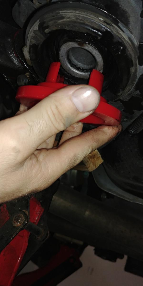

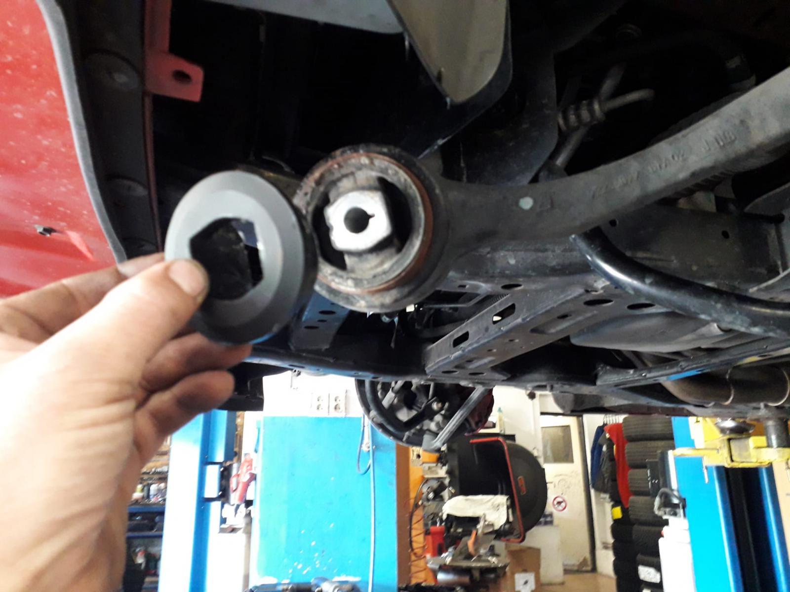

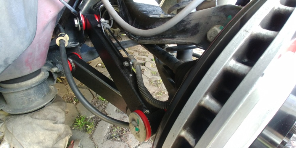

Originally Posted by George-CZ View Post
I did it in a combo together with polyurethane inserts of the entire rear axle mount and front radial rods.
And it was a night and day difference.
Attachment 1149122
Attachment 1149123
Attachment 1149124
Attachment 1149125
Attachment 1149126
Are those stickers you added after paint? Thinking about painting mine and wanted to do something other than just painting. Also was curious about those inserts. Would like to get rid of wheel hop but don't really want to increase noise or make the ride harsher. That looks like a decent go between to do it part way. How hard was it to do yourself?
