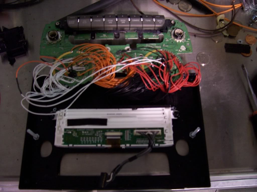

I have contacts both locally and oversees, to make PCB's, dash pieces, everything. Its the assembly that is the most time consuming. Each LED from the stock board has to be moved over, as well as connectors to retain the stock board and link it to the new dash board. There are about 125 wires that go from the dash to the retention unit, and each end of those need to be soldered, and thats just the one piece. If I have all the parts in front of me, it still takes about 20 hours to put it all together. Plus the price of parts. I would LOVE to see someone come out with anything close.
Keep in mind, this isnt the regular, simple plastic dash kit that we are all used to. I wish it was that easy.

Just out of curiosity's sake (not that i don't believe what you are saying) but why do you have to move the LED's from the stock board, rather than just use new ones, and leave the original board in tact? is it just for keeping the remote box as small as possible? I can tell you have the BEST kit out there, just curious as to the workings.

Posts: 324
The light-blue color, also called ice blue, is VERY hard to find from any supplier. I have searched for days and not found anything. Also, since the stock board still runs the leds, if I dont take them off the old board and put them on mine, the system has to drive twice the amount of LEDS, which shouldnt be a problem, but Id rather not take that chance. The remote box is about 9x7x2. It houses the stock board, all the radio controls, and the stock screen. Just in case you ever need to change setting in the car. Heres a pic of it:
Keep in mind this is the Gen 1 box, the Gen 3 is a bit different, this has just the screen on one side, and the controls on the other, kinda hard to use, the Gen 3 has everything on one side. Ill have to see if I have a picture of it.

Posts: 324
ok i found a pic of the Gen3 box, as well as a pic of SOME of the wiring that has to be done, just to give you guys an idea of how hard GM made this car to do a kit in.
