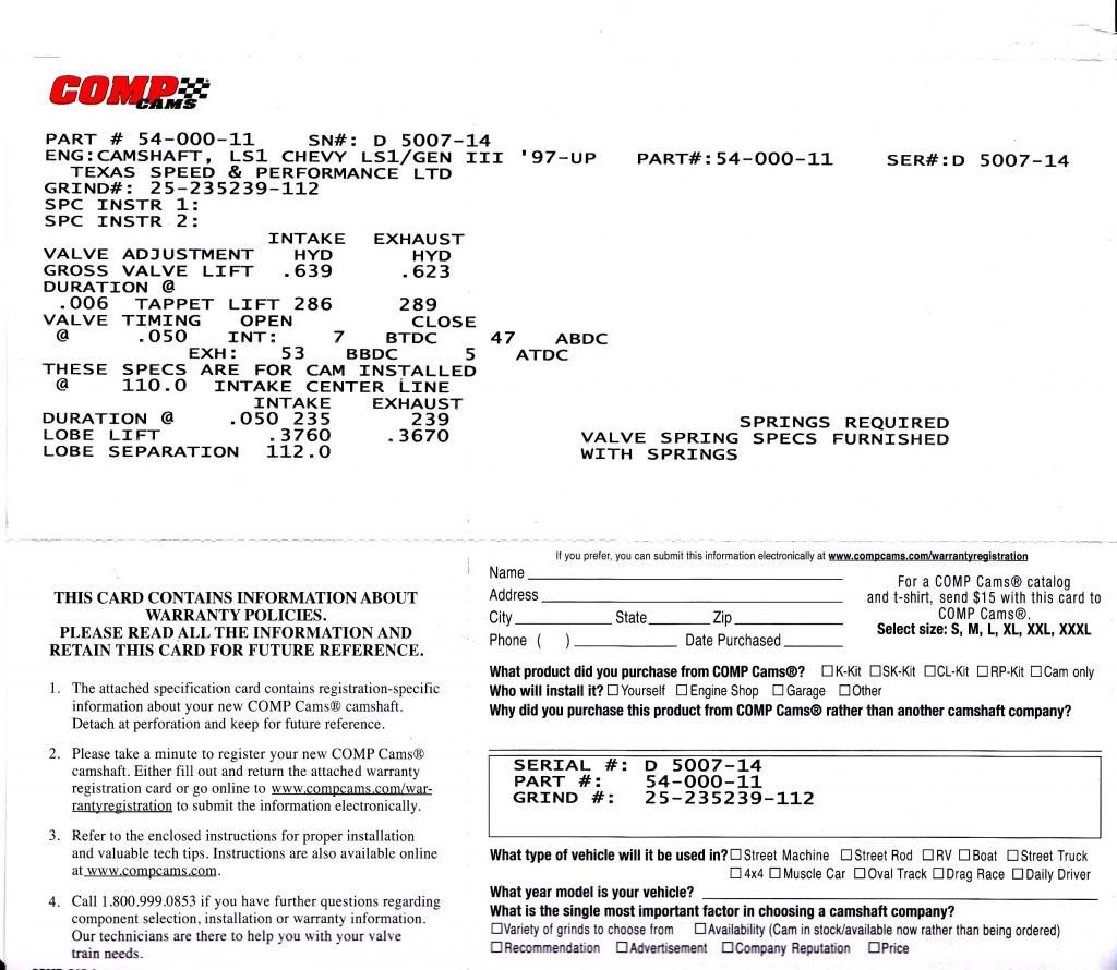

TSP top of the line cam, CAI with scoop, and Stainless power 1 7/8 headers with cats, tune and stock NPP exhaust: 491 h.p., 448 torque .639/.623 235/239 112 lsa
On a honest Mustang dyno, h.p. tuned, running rich to protect the engine of course on fairly W.O.T. it climbs until cutoff on h.p. with no data smoothing on the sheet. I think this cam is the bomb, compare it with any other with the same mods.........even if they are using a dynojet...... and of course I am a old hot rodder......go big or stay at home....... lol

The ultimate cam is one that does exactly what you want it to do based on what you desire.......... and the cams have a lot of variables that require research into what you want...a cam for a blower in the future? a daily driver quality with no noticeable large lope or cam surge? a radical idle and the most performance? or a cross of several things..... here is a article from comp cam who makes most the blanks for everyone who turns one into their " what ever named" cam about just the effects LSA have and timing advance and retarding. http://www.compcams.com/Pages/413/ca...ion-angle.aspx And remember on some cams with tight clearance due to max lift and such for performance you have to worry about piston to valve interference and do not want to mess with timing too much if at all if going with cam that's high lift as our performance cams are very high compared to say flat tappet hydraulic cam and our cams require springs that need to be checked over time, and the cams can be really screwed up if not using the right 30 weight oil with ZDDP in it, I use driven racing oil and used br30 break in oil because I used to always do flat tappet cams a lot in chevy engines and always broke them in as springs need break in too...... I use LS30 now and will remain using it as it is formulated for our engine, as was the cam I chose from a shop specializing in the LS engines. I do not use too little pressure on the springs and sure the heck do not want to use too much as it will eat the cam and lifters and such.
I have a .639 lift on the intake that's higher than the .623 on the exhaust yet the exhaust has a longer duration to allow it to move more out.... things like that matter, and my springs are .675 springs I will spec out about 25k down the road to see how they are living as valve float could be a disaster etc etc with worn out springs as we have.... stock from the factory a engine that has higher lift than anything a old classic muscle car ever had..... And with more real flywheel h.p. than anything they had..... A 454 ss chevelle with the highest ranking h.p. in the day really only put out around 285 rwhp as it was inflated as heck..... imagine it having around 375 rwhp that we have stock in a ls3.... that would have had to make that chevelle rated at 450 h.p. back then have to be.....550...600? who knows.......... So do research is my advice and use a dyno as a tool and use the same one if you ever have to use it to tune for more mods if you can otherwise you way just find the truth about dynos is they can be made to lie and no two will be the same, and if lucky they will be close if they are the same brand and model and the adjustments made right for barometric pressure etc...... I am close to sea level here so it does not matter much some of the adjustments that can be screwed..... And what really matters is a complete package that gets power to the ground if that's what you want, or you may want fuel economy, or a bucking bronco, or a quiet sleeper, or.............. The ultimate cam is what you decide you like the best in advance unless you change it several times and find something you like better, and that's not a cheap proposition. Or easy on the other parts that go into the supporting build.
