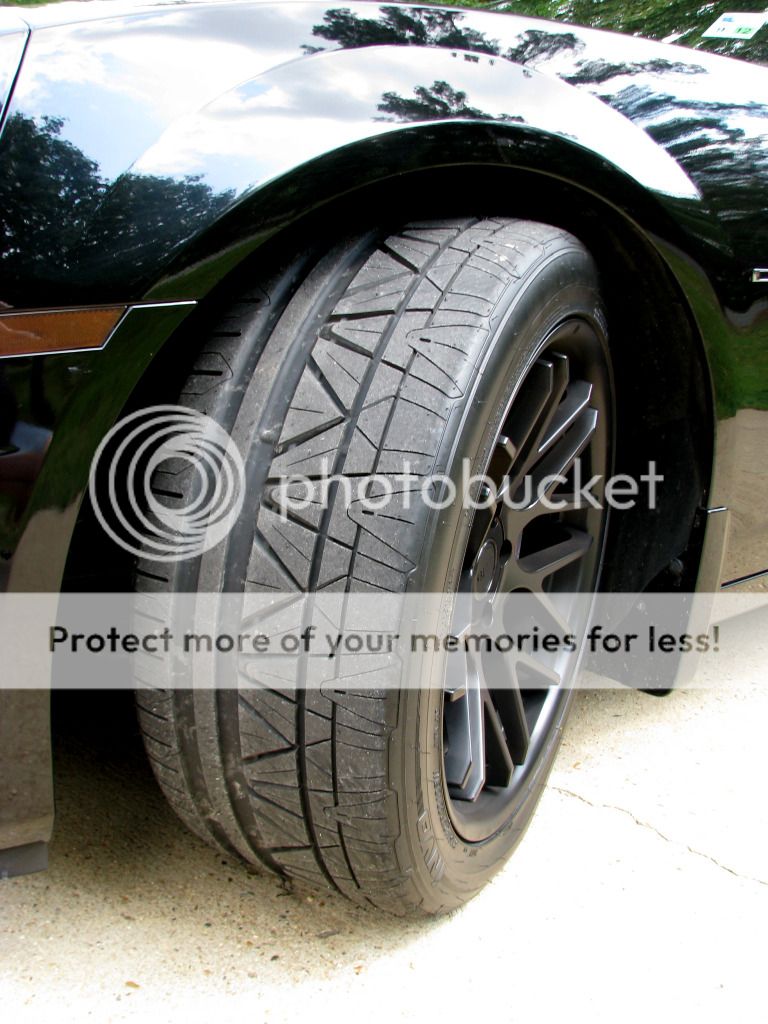

Here ya go. 20x10 wheel with a 275/40 20 Nitto Invo. Looks great to me.
Here is the same tire on a 20x9 wheel and the tire looks too bulgy to me, so I think the 10" wide is perfect.
And here is the 315/35 20 on a 20x10 wheel. Also looks a little bulgy, but still acceptable for the rear.

Just want to know if 10" wheels are too wide for 275s.[/QUOTE]
10" would be ok
*275/40ZR20 106W203-18010.028.6210.949.0-(9.5)-11.02094
50
9.5 " would be ideal but 10" would be ok

275/40/20's fit perfect on 10" wide wheels. Im running 275/40 P-Zero's on 10" wheels up front. With correct offsets the sidewall bulge will sit inside the wheel wells. Mine sit 1/8" inside the well.....my 305/35's on 11.5" wheels out back sit 1/4" inside the wells.

Originally Posted by SUX2BU View Post
"I see" said the blind man.
But i heard that different tire brands with the some numeric like [ 275 ] will fit different on the same wheel , for instance , the OEM from the SS rears will look bulging on a 10'' wheels ,and the NITTO INVO looks just right , know what ?
What you are saying is true but I'm not sure what you are asking.
The OP wants to run Nitto Invo 275/315 on all 10' wheels so I posted pics of those specific tires on 10" wide wheels.
