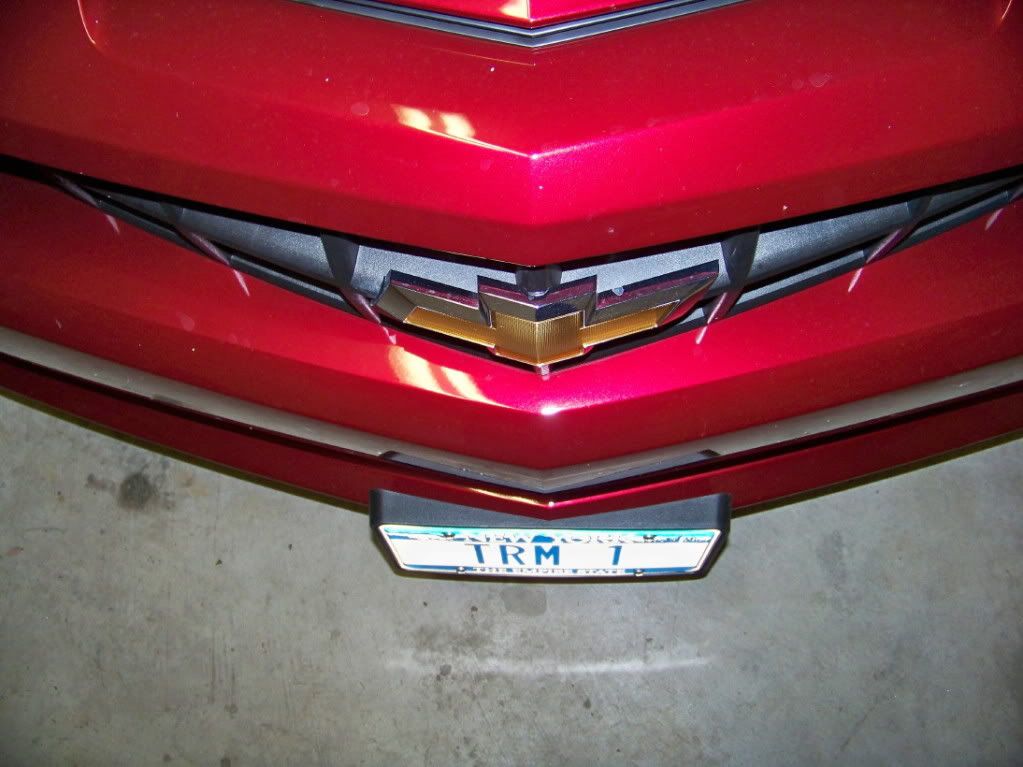

Here are two early shots of a test fitting on the V6. It was designed to fit the V8 originally (cause that's what I ordered), but we are trying to modify it slightly to fit both without rubbing anywhere. Please note that the welds are currently rough because this is a prototype designed for fit testing, not a final production model.
I hope to have some pictures of the test fit on a V8 soon and I will update with pictures and ordering information as soon as it is available. [On a side note, thanks so much to the little "birdie" who is helping out with the test fitting! ]

And here is the final product as installed on a Mustang. [I know, sorry it's a Mustang. Hope to have pictures of it installed my my Camaro as soon as I actually get a Camaro!]

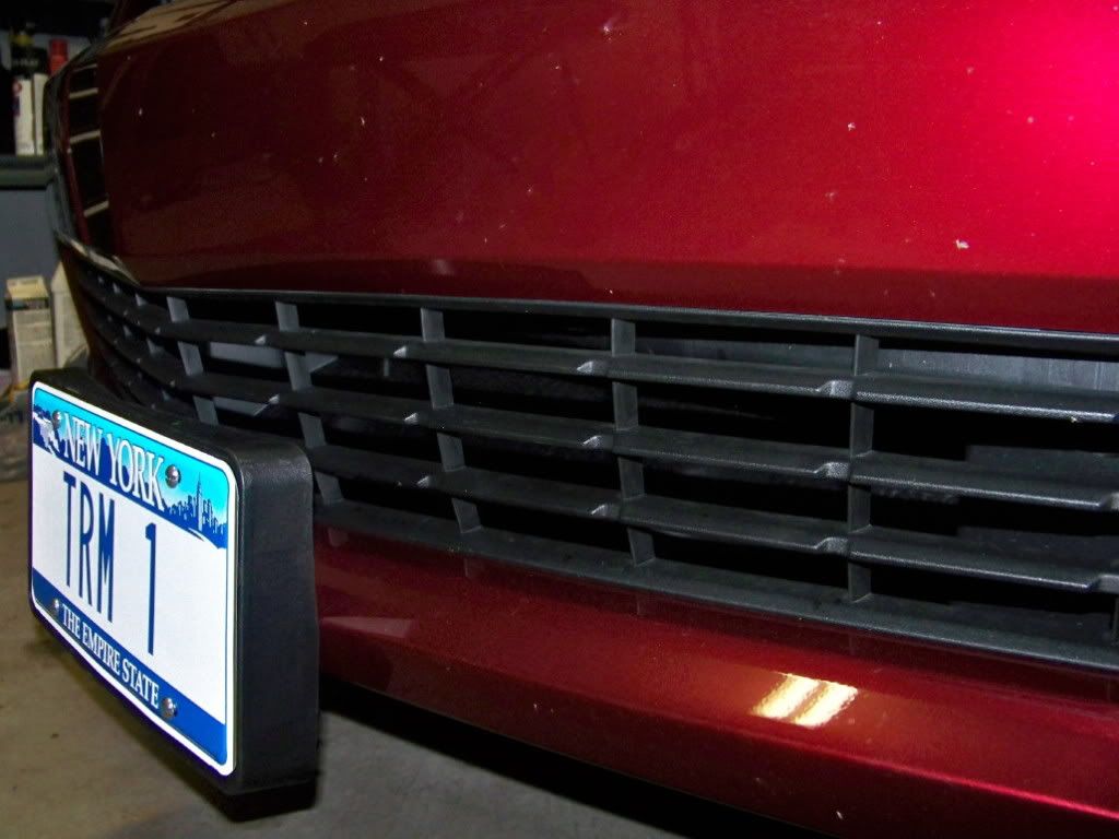

Here are some shots of the test fit on the V8. Looks like a perfect fit.

One question, do those spacers expand as you tighten the bolt or do they just fit perfectly into the grille area?

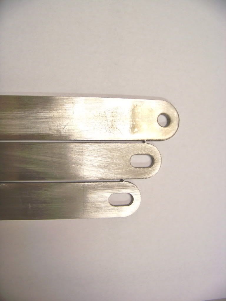

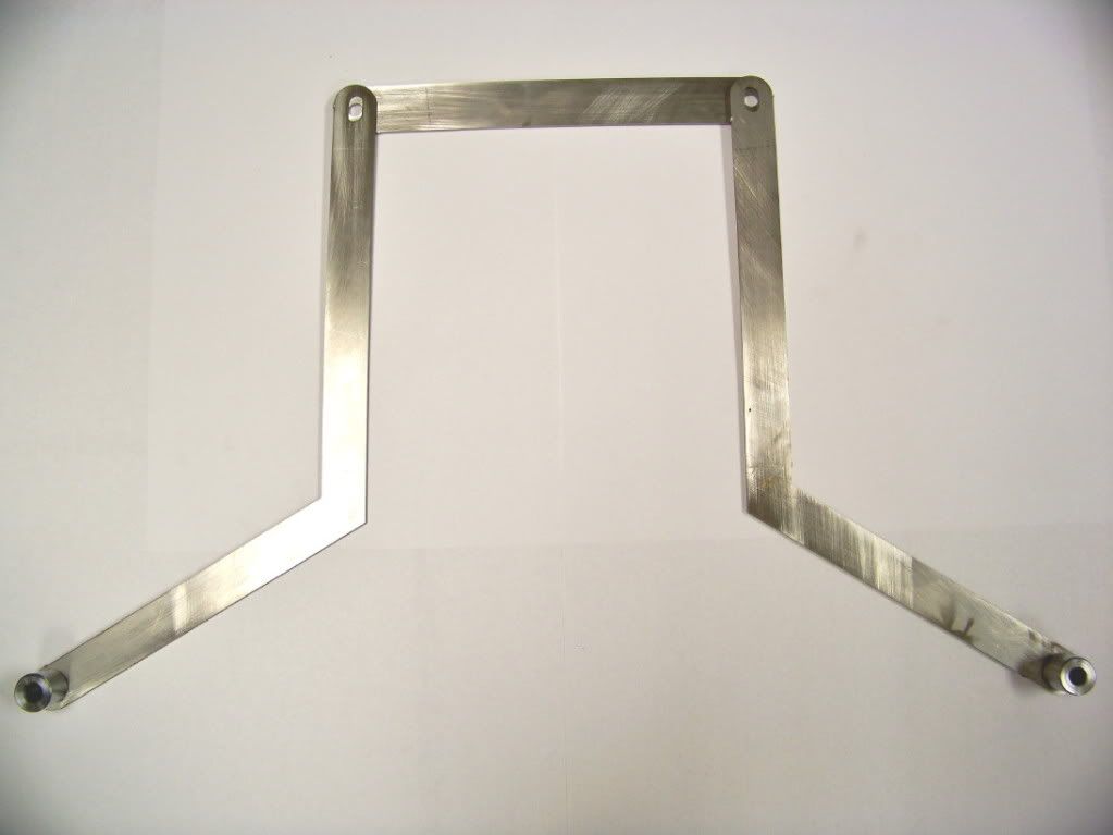

Ok, I'm good to go (temporarily)
First measurements were just slightly off in what I call the "standoff dimension" for the height of my spacers. I put washers in their place until I make new ones tomorrow...

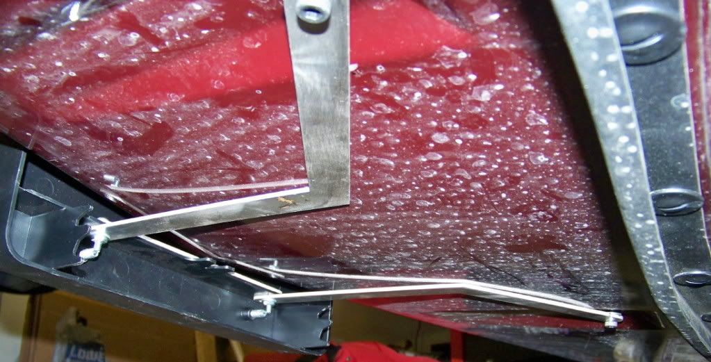

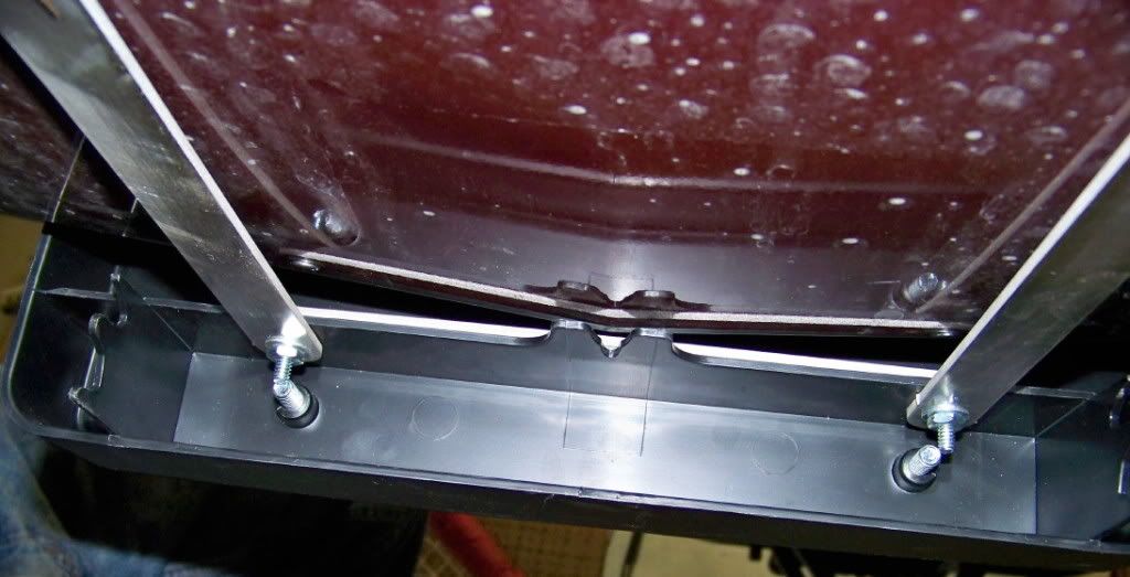

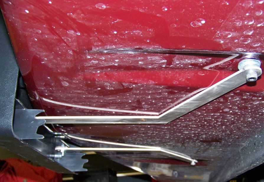

Ok, first step:
Cut 3 required stainless steel strips on your friendly neighborhood waterjet.
Be sure to leave break-off tabs between the pieces.
Break the 3 pieces apart and lay them out representing the final assembly.
Drill two 1/4" holes in the back rib of the OEM license plate holder 7" apart straddling the centerline, 1/2" in from the edge. Assemble the license plate holder, top bar, and 2 main bars as shown with 1/4-20 bolts, washers, and nuts.
Remove the two screws holding the lower part of the front fascia, put the stainless standoffs (washers for now) against the screw holes you just exposed, and bolt up your assembly with two longer m6 x 1 bolts (30mm length min).
Check your assembly to make sure it matches this.

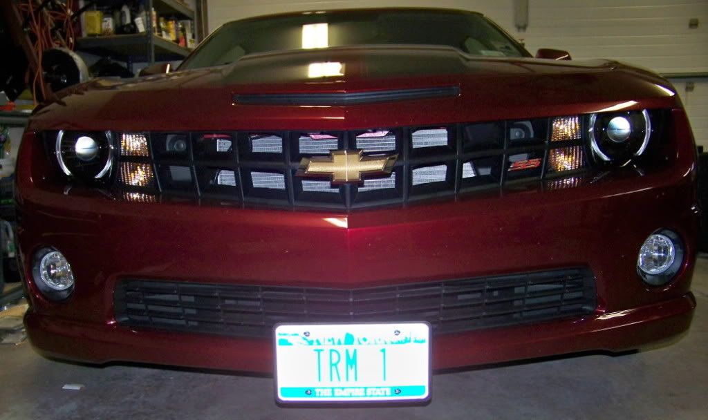

Then simply enjoy the view(s)
^^^^^ The ground clearance is almost 7" to the bottom of the license plate- the picture angle is a little deceiving.
trm0002 is offline   Reply With Quote
