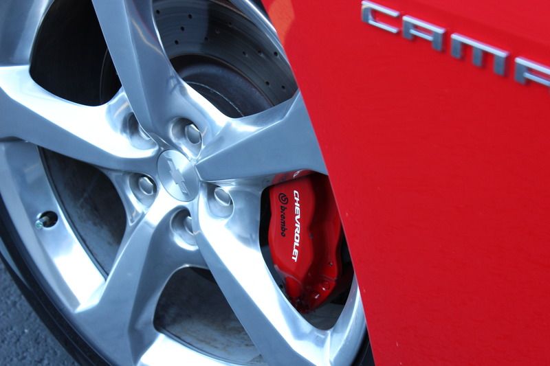

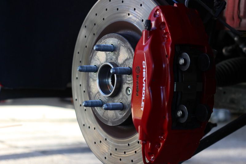

I used duplicolor caliper red, made my own brembo decals, then clear coated with VHT high temp clear gloss coat. They came out beautiful

Did mine-need to get the SS Master Cylinder though.
looks real nice, I still need to paint mine before install
Wow this looks really good. Is this from a powder coat process or from a paint can? Looks professionally done. Wish I could do this. I have a front and rear set of brembo calipers i purchased from EBay a couple of months back that desperately need a paint job.
