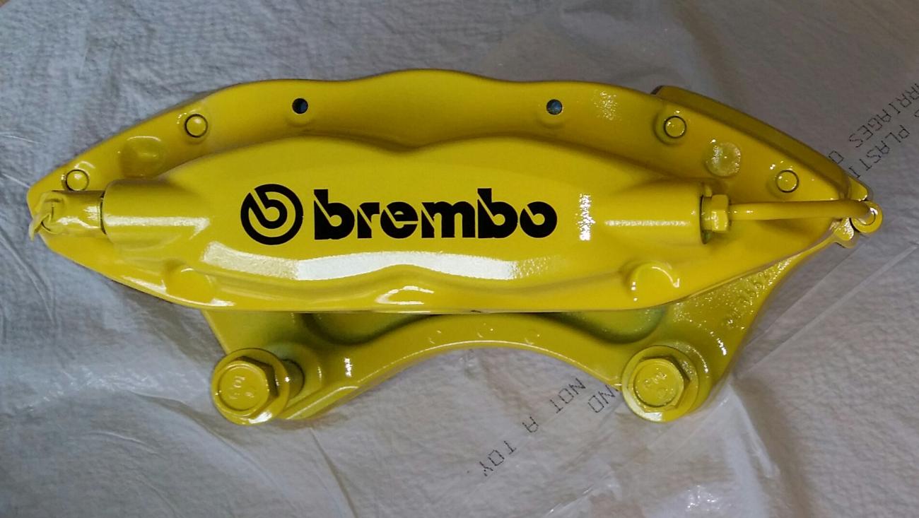

Ok. So I decided to paint mine instead of sending them out to be powered coated. I took mine off the car because I done the Brembo upgrade this winter and did not have the lines hooked up yet. My think is everything went well but the VHT yellow is alot different yellow than my Camaro. Now what to do? I have a paint that matches the Camaro but it does not say what temperature it is good for. If I use a regular paint but use the high temperature clear coat do you think that would work?

Well even though I cleaned and prepped them real good off the car and let them sit in the house over night to dry before I painted them the next day still no good! I sprayed 3 coats of primer with 3 coats of yellow than cleared them with 3 coats still real easy to scratch or chip off paint. I used all VHT spray paint rated at 900° and they turned out looking really good and smooth. But was taking the tape off after 3 days of drying sitting inside the house because the weather is still cool here and the paint scratched and chipped in several places. I am picky and do not want to have to deal with more coming off during the summer months I have decided to take them apart while they are off the car and have them powder coated. That way i don't have to worry about them having any issues and powder coat stands up and looks good for years.

Alot better powder coated!!
