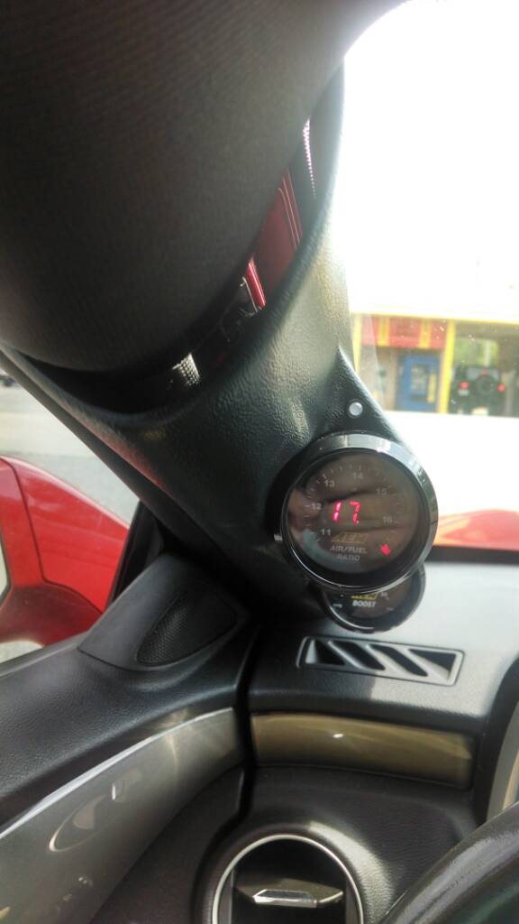

Originally Posted by blake2010ss View Post
This is what mine keeps doing.
Attachment 643591
Just like my gauges, LOL
What's the white point above the upper gauge? shift light?
T-r3x is offline   Reply With Quote
Methonal light.
