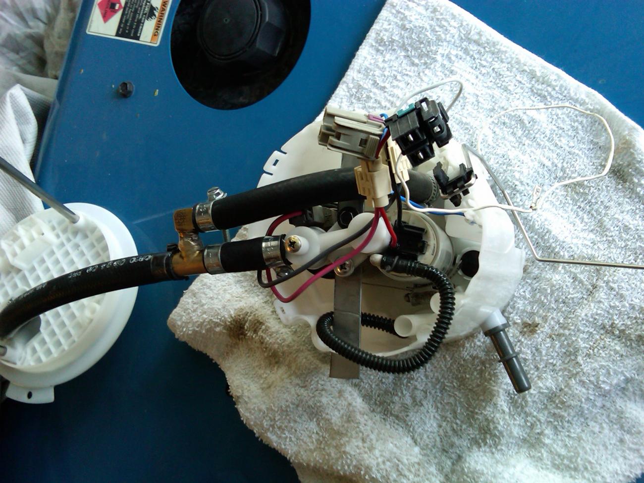

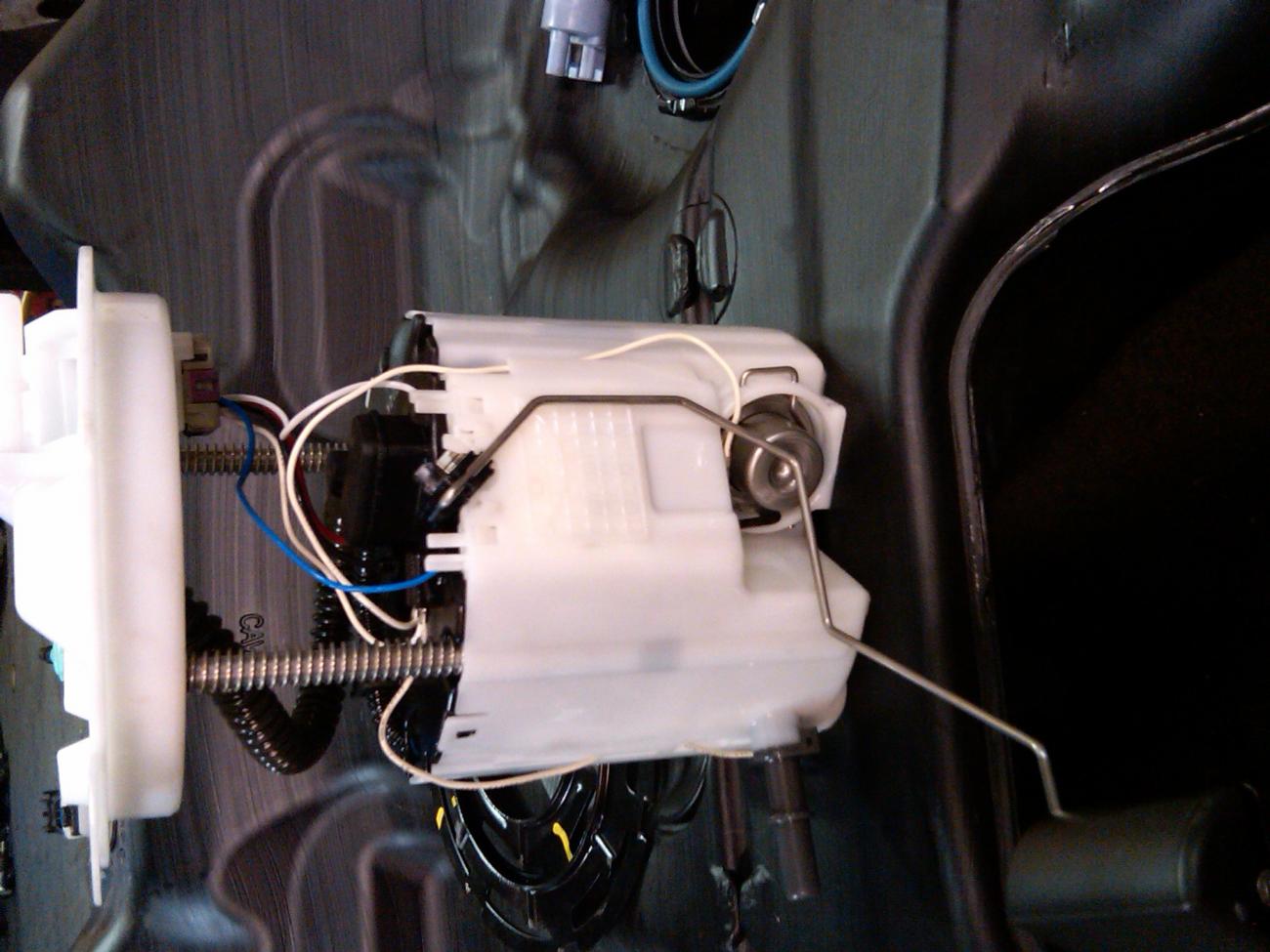

Old 09-04-2009, 03:25 PM   #35
turboed2000
Drives: 2010 Custom Turbo
Location: Las Vegas
Posts: 62
Here are pics of the stock pump assembly and modified. This was a temp mod. It is a lot cleaner now that we know it works. You have to keep the stock pump in there and I used a pump out of a GT40 super car because they are pulse width modulated pumps and supplie alot of fuel.
turboed2000 is offline   Reply With Quote
