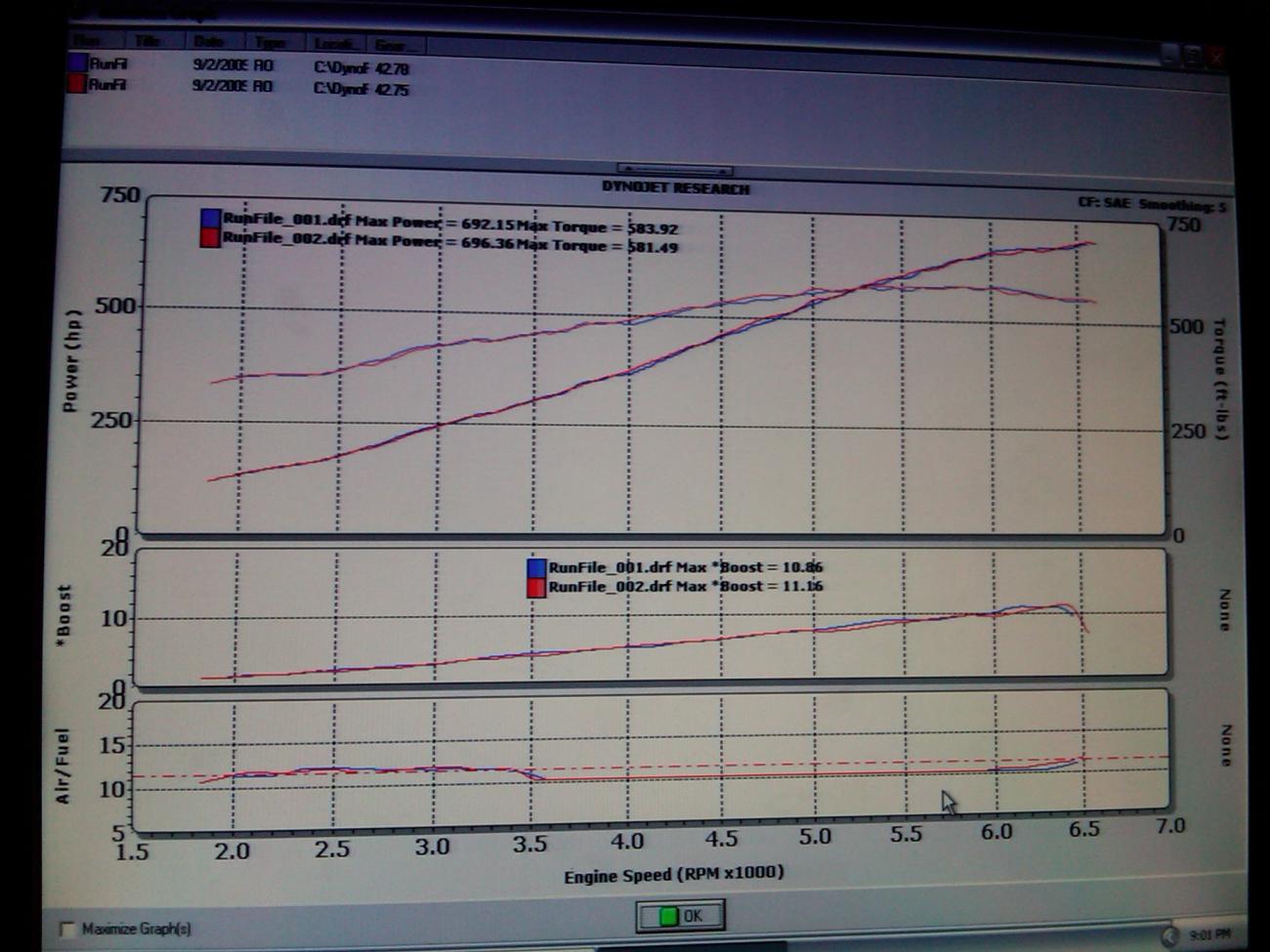

Here are the results after a week of driving and no problems. This is straight off the street with no cool down. This is on meth thats why its so ritch. We did lean it up and i forgot to get the graph. This is at 11* of timing and 180* IAT.

damn, what size pulley are you running? That's some sick power, I believe the highest whp of any new camaro up to date, with a LS3 to boot!

It is a 3.85 pully. As far as I know it is. I dont think any one else has even seen the stock fuel pump. So with out a fuel solution no one else will see this number.

stock spark plugs?

wow hell yea that is some power. nice job guys. that pic makes me twich....

Awesome power guys! I will be curious to see the Duty Cycle of those 80lb injectors once they have solid fuel pressure going to them. Can't wait to see some numbers from the track.

Sorry the fuel pressure issue is fixed in my car. I installed 2 pumps in it. Held perfect pressure finally. I can look at the logs for the duty cycle. It has to be low. We have made over 850 and had room to go on my 03 cobra.
