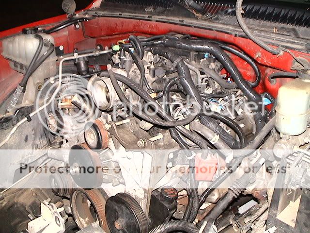

once that was on, just a double-check of all the harness connections was all that stood between the engine & the bay
it took a little more finagling than the V6, but we got it in there
by the end of the day, the new powerplant was on the mounts, clutch lined up, & had a couple bolts in the bellousing.
as you can see, the pulleys need a good sanding

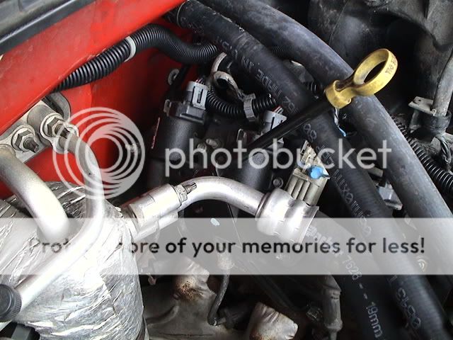

in the process of getting it all hooked up, i ran into a few interesting scenarios...
the harness has an extra a/c plug, which, i believe, is for vehicles with rear air and the connection to the accumulator is real tight on the oil dipstick

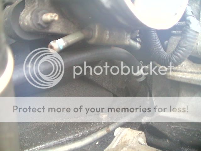

the new fuel lines were just a little bunched up, but it wasn't nothing worth pulling the engine back out & cutting further down for
the hose from the power steering pump to the steering box is a bit longer than needed

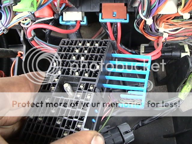

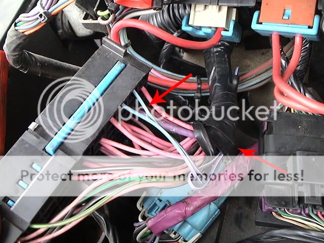

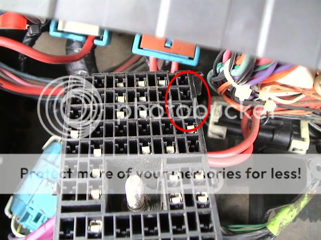

first thing this morning, i get a call from Jared @ Current Performance. he's found something!! apparently, FSCs have some non-typical method of wiring the clutch position sensor. this was something they'd never seen before & accidentally overlooked when building my harness. all it needs is this little guy
i just stole it from my 4.3 harness
to go in the black fuse block connector, jumping F10 to F11
the fix is really simple - just pop the blue retainer out
slide the pins in until they click
put your retainer back in, purtificate it with e-tape, & you're done
