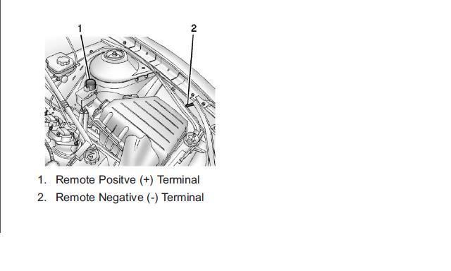

Owners Manual Chapter 10 - Jump starting (in index)
http://www.chevrolet.com/content/dam...ers-manual.pdf

The battery to battery advice is the only option in a car with the battery in the traditional position. Going battery to battery as you did to start the Camaro is probably less effective than using the remote posts as the resistance of the wiring from the battery to the starter comes in to play.
Battery in the back is smart, especially with on star.....the battery will survive a crash and Onstar will still be powered.

This is just a FYI for next time.
Your car will move, especially downhill, even though the battery is dead and it won't start.
Put key in ignition, turn key to start, leave it there. Put foot on brake, shift car into neutral. Ease up on brake allowing gravity to take effect, back car down driveway into the street. Open hood, use terminals under hood to jump start car.
