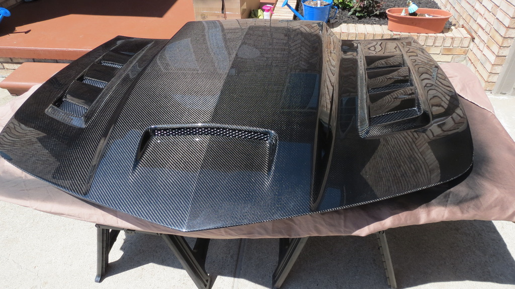

Drivers Side CF Rocker rough installed. These are a rigid part and caution is necessary to avoid over flexing and cracking them. Some minor grinding was required to get the attachment clips aligned and to get proper clearance at certain points. Fit is good considering the nature of the part, still gotta put the screws in at the front and rear. I like the profile, and the pop of the carbon fiber.

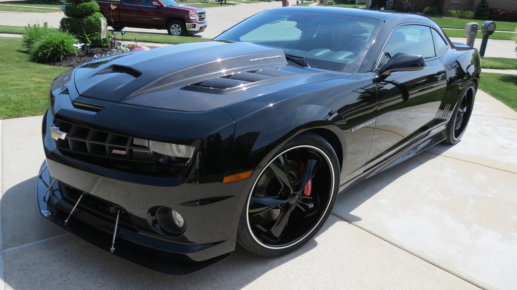

Front Fascia with APR and Shark Tooth

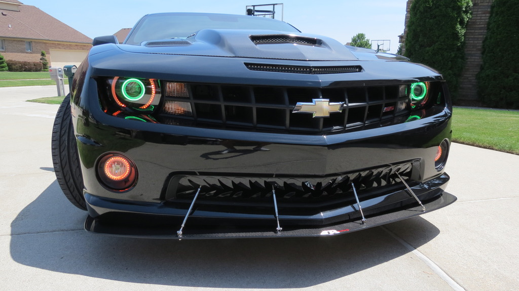

Got my Fascia on yesterday. Added a 2nd set of support rods to the APR. Have dual color Halos in both the Fogs and Headlamps (White/and Amber as Shown), and a Green Demon Eye with a Diffuser Ring added in the Headlamps.

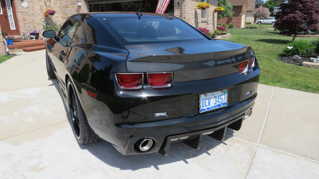

Almost done throwing paint, just got the Whipple S/C Engine Covers to finish. Painting is a real PIA, but at some point ya gotta settle for good enough. Got the Rear Deck Lid installed and fitted. And the Havoc Diffuser with the Carbon Fiber Insert, which I clear coated to make it pop more. Pretty nice stuff, but definitely requires some finessing to make it fit decently.

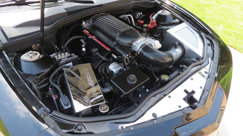

A good day with the paint gun. Finished painting the Whipple S/C Engine Covers. After much experimenting, I used aluminum primer, black base coat/clear coat, clear with silver/blue/violet pearl flake, and a black tinted topcoat with more flake. Will give them a day or so to dry before I rub them out, and install the custom Emblem Pro's "SUPERCHARGER" Emblems, then slap them on the engine. Also painted the throttle body.

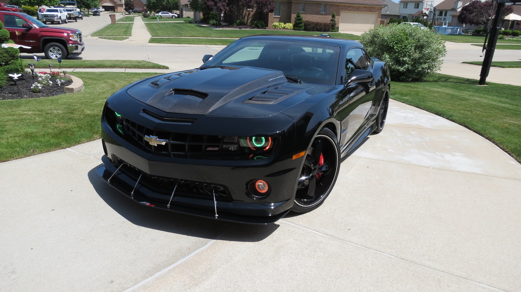

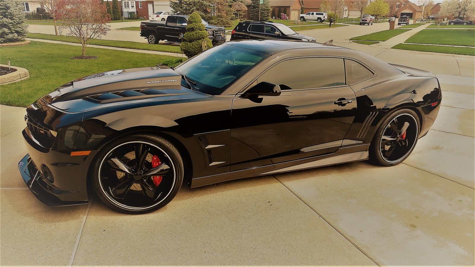

Terminator Hood installed, fit tweaked, and SUPERCHARGED Emblem installed. This hood fits almost perfect - a quality piece and looks just bad-ass.

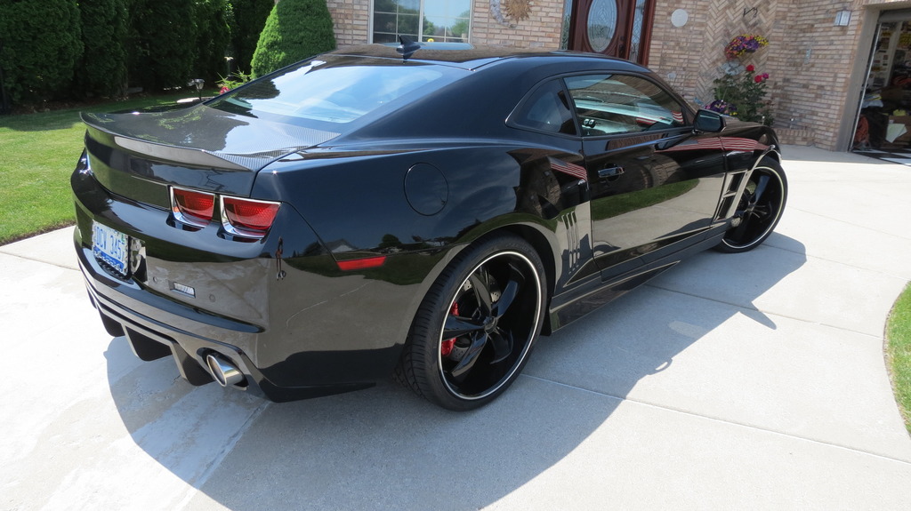

Well - lots of debug as expected. Found a few fasteners in rear that were not final torqued (Duhh-Ohh!). Some are nearly impossible to get at, like the Rear UCA Pivot Bolt (Axle Shaft in the way). Checked everything again to be sure. Got it aligned, and the dealer spent 3 hours getting it within my specs - within 0.1 degree! And was chasing a rear end "clunk" over bumps at slow speeds - this turned out to mostly be that the Rear Coilovers were set too harsh. So I dialed them back, and the car is now wonderful, has a remarkably smooth ride, and a riot to drive. The power with the Blower and Cam is frightening - I gotta learn to drive it cause it can boil the tires at nearly any speed when you keep the boost up. Time for some outings and local car shows.

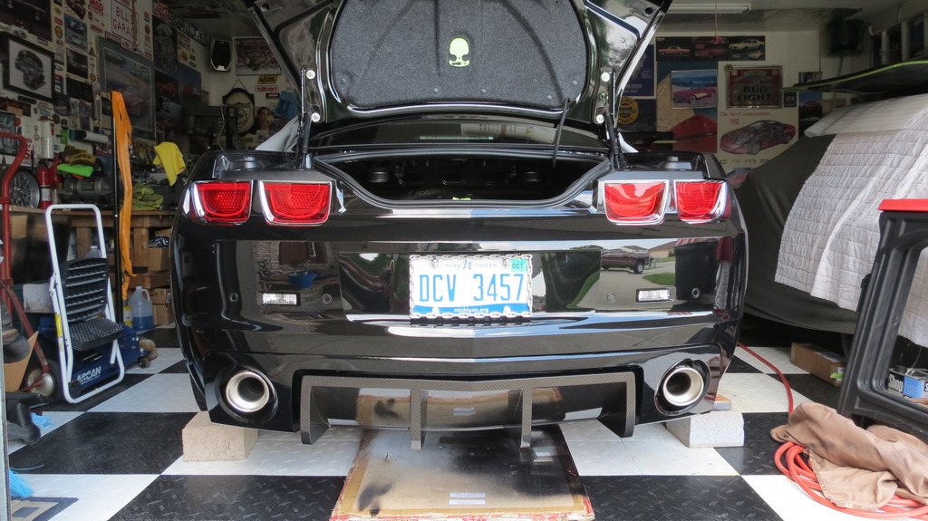

[FONT=&quot]Replaced the BMR Rear inboard style Sway Bar with one from Justice Pete, which mounts outboard for better ride and handling. Nice improvement. Also added a shift light cause when the blower kicks in the rear tires just blow off and the car quickly hits the rev limiter. So when the light flashes at 6K, you gotta pull a gear in a hurry. What fun!
Yeah - I installed the bar upside down, and fixed it as shown here, bolt head down.

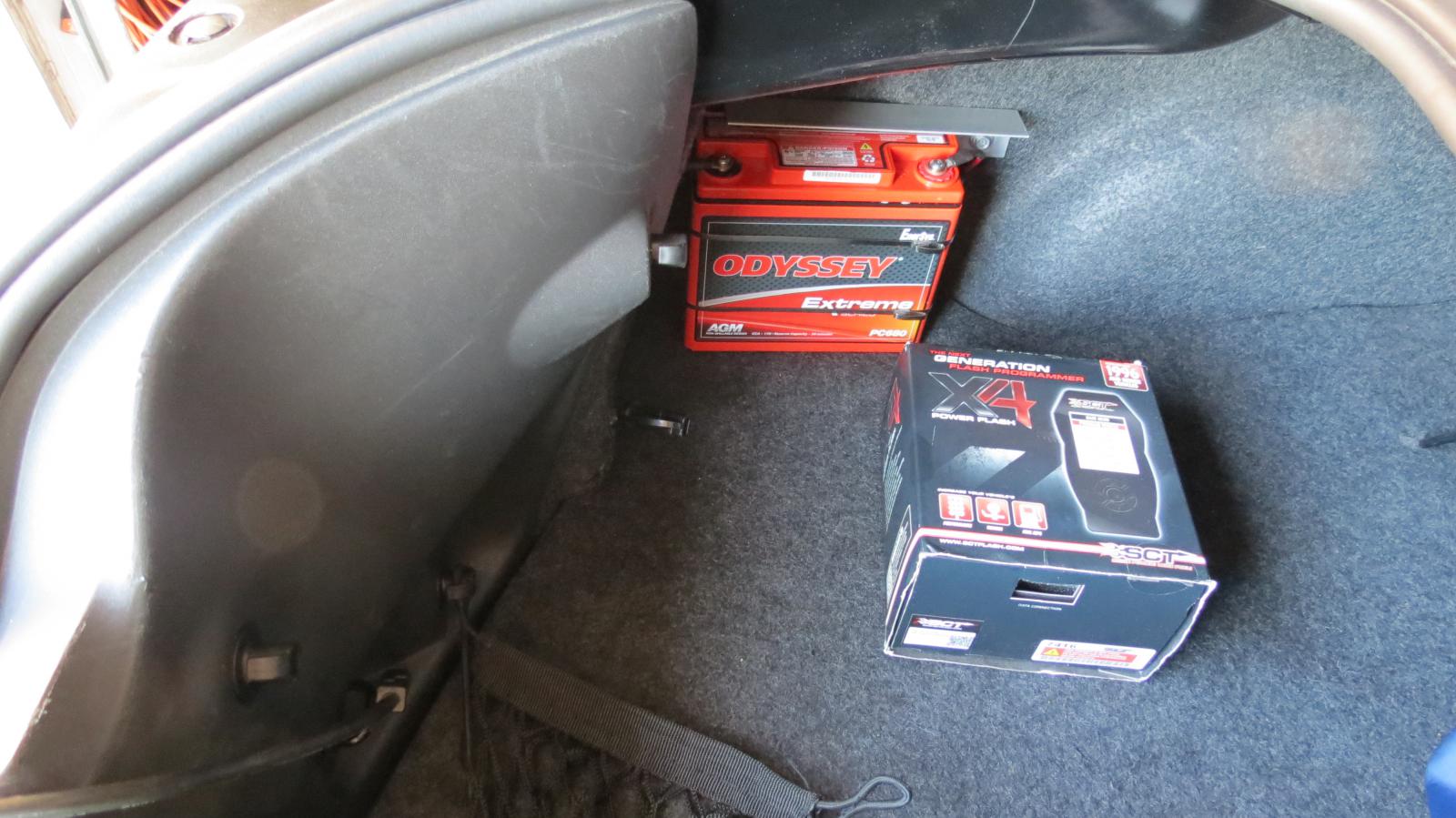

- Added a separate battery in the trunk to power the LEDs. Found 8-10 hours of use at a car show would tax the regular battery too much. Use a charge port in the trunk for quick battery tender plug in.
