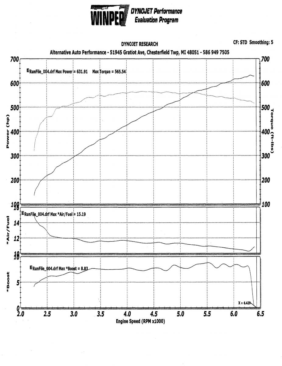

Phase II was a Whipple and a Cam good for 632 RWHP and 565 Ft Lb TQ on the Dyno. Having over 500 Ft Lb of torque from 3000 RPM to the Redline makes for some scary power and now the car is just brutally LOUD! And I thought my other cars were loud. Gotta put on some resonators or something in the exhaust as it sounds wicked, but the neighbors and COPS won't appreciate it.

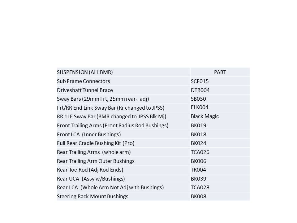

Next is extensive Suspension Upgrades to handle the power. I went with all BMR stuff, and BC ER Coilovers:

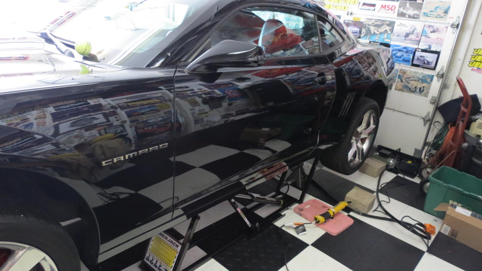

Bought a Quick Jack so I don't get a "Leather Back" from crawling under the Car. Time to tear it all down:

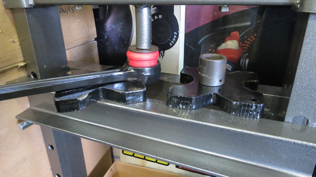

Pressed out the Bushings on the FLCA and Radius Rod - this was a little hairy. I scrounged around in my endless junk parts and found a bearing race to use on the big Radius Rod bushing, and chucked it into my 12 Ton HF Press. Whatever used must match the OD of the Bearing Sleeve or it won't work, and it has to be parallel in the press since the Sleeve is so Thin. Got one out clean, the other did not go so well and I pressed out the inner first and used a Sawz all to just cut the sleeve enough to chisel it out.
The Radius Rod bushings came out clean with a 1-1/8" Impact Socket.
Let's just say they are in there tight, and even with a press you gotta crank it before it cracks free and push's out.

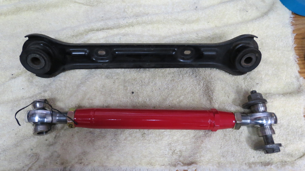

o TOE ROD - Remove the 18mm Toe Rod Bolt at the Hub/Spindle. Mark the Inner Bolt and Cam position on the LCA before removal, then remove the Toe Rod 21mm Inner Nut. The Driver’s side bolt cannot be extracted on the Driver’s side unless you lower the front of the Cradle. Place a Hydraulic Jack under the Differential, and position a pair of Jack Stands to support the Cradle at the front bolts. Remove the Front Cradle Bolts with a 24mm socket. Slowly lower the jack at the Differential and let the front Cradle tilt down at least 1” or more and remove the Toe Rod Inner Bolt and Toe Rod.
o TRAILING ARM - Remove the Trailing Arm Outer 18mm Nut and Bolt. Remove the Inner 18mm Bolt and Trailing Arm. The nut is welded to the cradle.

o LOWER CONTROL ARM - Remove the 18mm LCA Bolt and Nut at the Hub/Spindle. But - Caution, there is some pressure from the spring, but not much. I suggest you use a spring compressor to be safe. Remove the 21mm Lower Control Arm Bolt that holds in the bottom of the Strut Assembly using a 21mm Socket and the 21mm wrench. Mark the Camber position on the Inner’s Bolt/Washer/Frame, then remove the LCA 21mm inner Bolt and Nut, and remove the LCA .

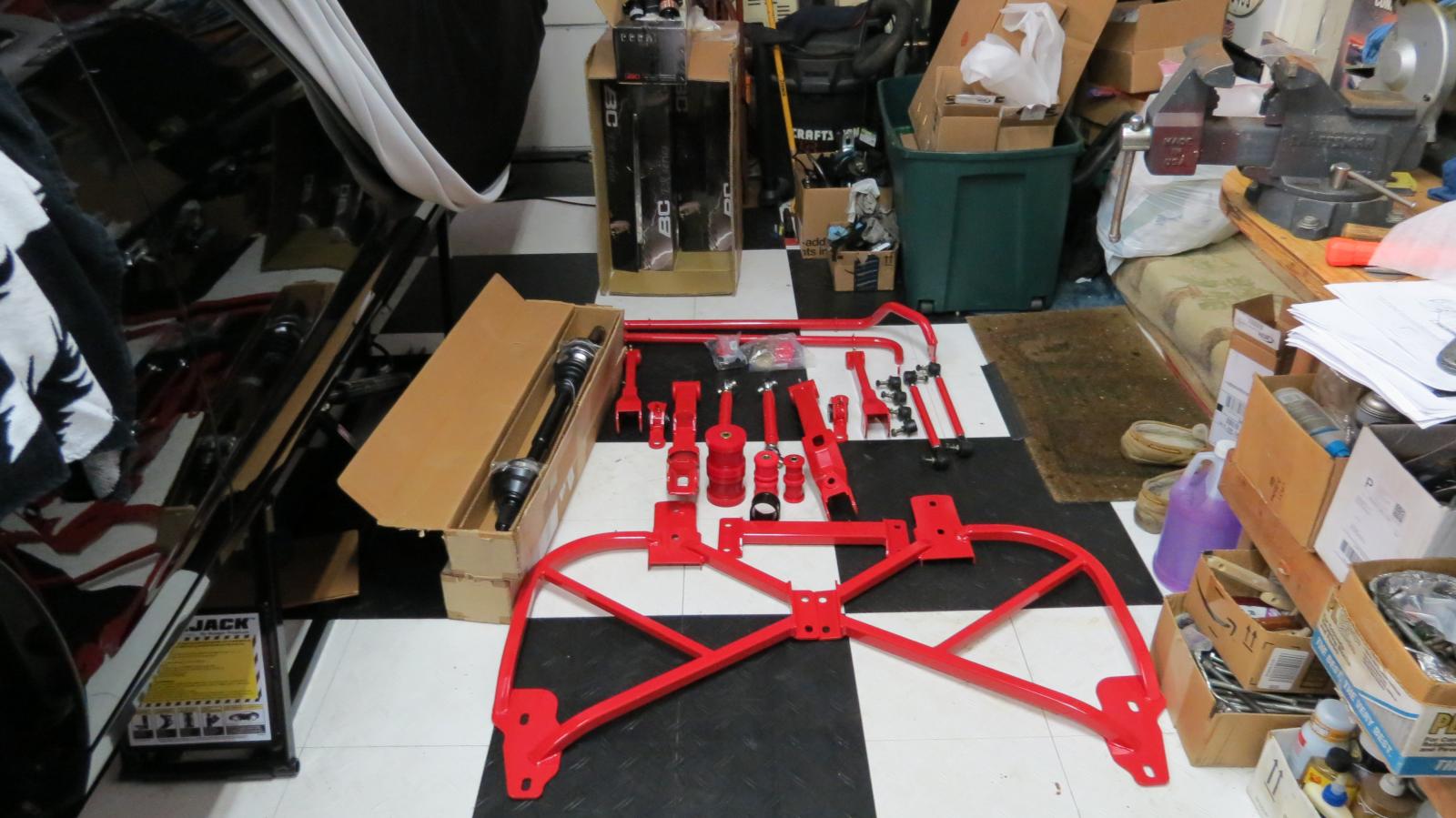

The Goods.

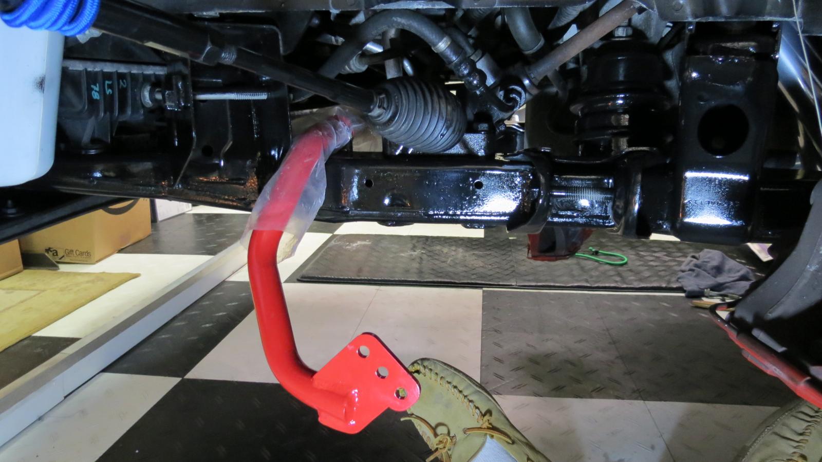

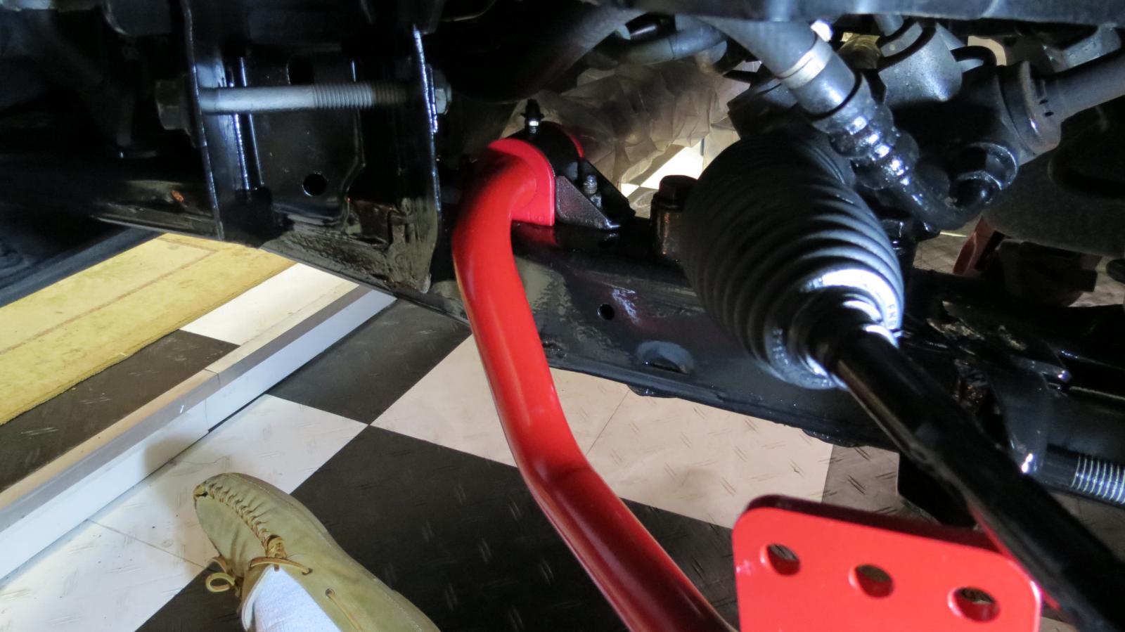

Front Suspension Assembly
This is basically the reverse of the disassembly, but different in certain areas with the new parts.
Front Sway Bar[FONT=&quot] – the BMR SB016 is a bigger dog than stock and a challenge to install with the 3 hole flange on the ends, but not impossible to fish back into the Passenger Side and out the Driver Side. Again, I cannot jack up my engine with a Whipple which would have made it much easier. You just keep twisting it around until it clears the Power Steering Lines, and I did “bend” the one in the Pic up ever so slightly for clearance, and then bent it back down w/o damage. The Saddle bushings get lubed up, slap on the Saddle over it, and install it over the 15 mm Studs OUTSIDE OF THE FLANGE ON THE BAR. Put on the Washers, reuse the 15mm Nuts with some Blue LT, and center the Saddle Bracket cause the slots give a good deal of fore/aft and a little side to side play. I found using a stubby ½ drive ratchet with a flex head and 15mm socket helped get the initial torque, and then used a torque wrench to tighten the (2) 15mm Saddle Nuts on both sides to 13 ft lbs. Pump some grease into the fittings, and move the Bar around to ensure it does not bind. Nice looking bar!

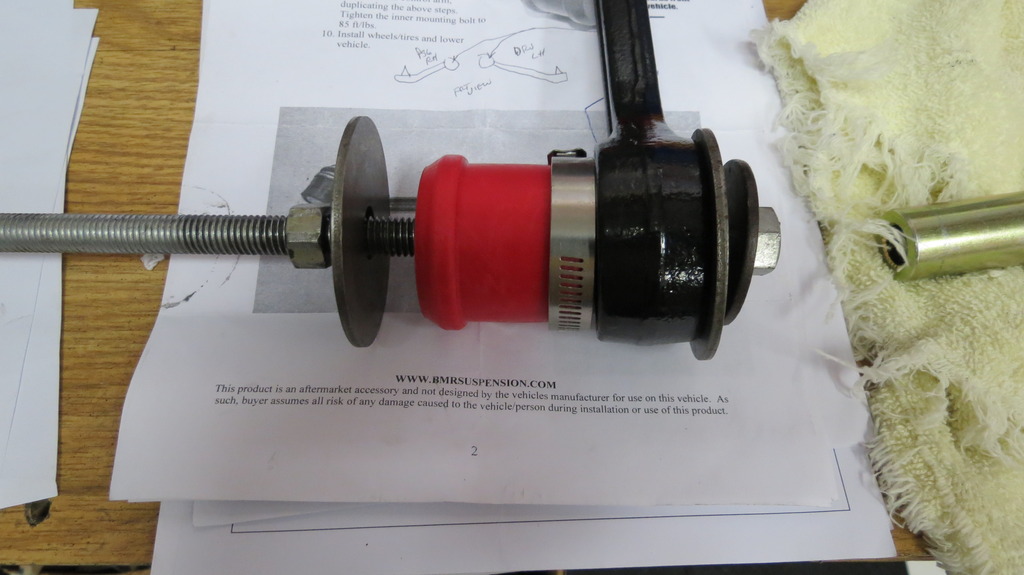

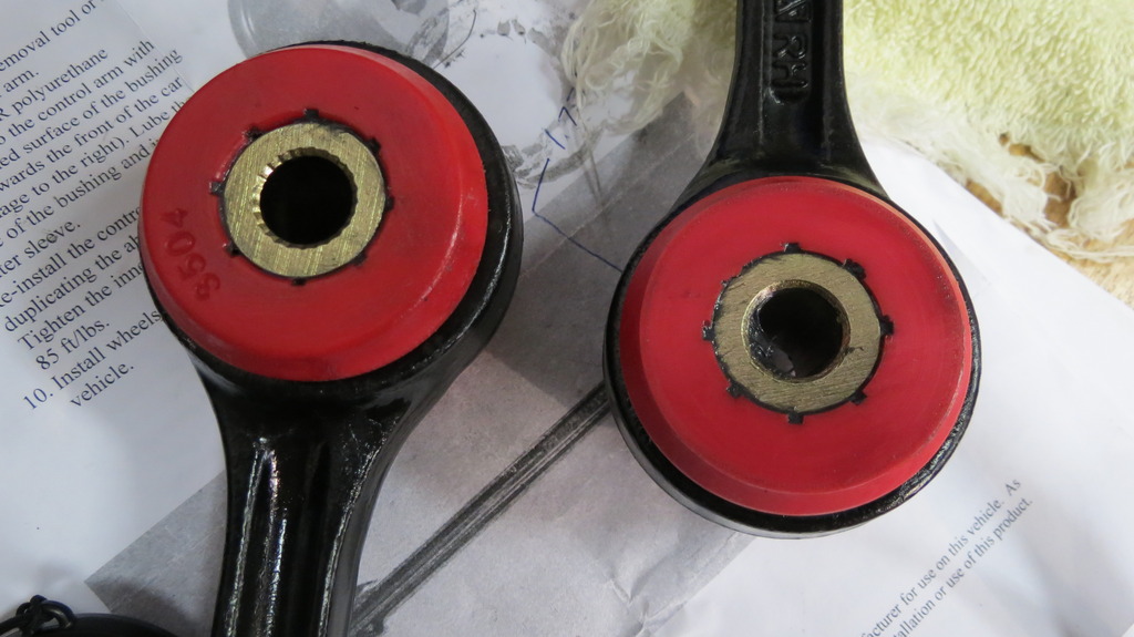

Front LCA Front - Bushing (the Arm with the Large Bushing) – this is easily assembled into the arm, and a vice or hammer can be used. It is a (3) piece bushing with a different center bushing durometer, press or hammer the center in first, then the outers, then the inner sleeve. Stuff it into the Sub Frame – it is a real tight fit, and I used a screwdriver to align the holes to the frame. Loose install the bolt and nut for now, do not tighten yet, as the bushing will need to be “Timed”. This is a TTY Bolt, and ideally should be replaced.
Front Radius Rod (Front Lower Control Arm Rear) - Bushing (The Arm with the smaller Bushing) – this one IS NOT EASY. I again used a homemade threaded rod and washer tool, and a hose clamp. The pics tell the story on how I did it. I will leave out the all the pronouns and adjectives, as well as references to mother that came out of my mouth. The machined side of the bushing must face the front of the vehicle, and it is the side w/o the letters on it. Once you get the smaller lip to pop into the Arm it is easy to press the rest in, then the inner sleeve. When done, stuff it into the Sub Frame and loose install the bolt and nut. Also a TTY Bolt.

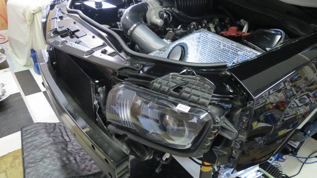

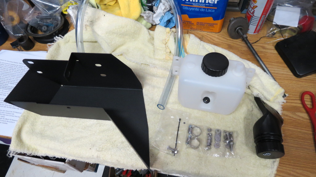

Fascia Removal, Air Scoop, and Remote Washer Bottle Install - Pulled the Fascia and Headlamps off as I will install Dual Color Halo's at some point. Wanted to knock this install off before finishing up Front Suspension, it's pretty straight forward and easier with the level of disassembly I have. Got a clean cut on the Shroud using tin snips. Elected to mount the Filler Bottle to the outside of the CAI, and run the fill hose through the CAI so I don't have to take off the Glass Top. This is a clean installation, and will definitely increase some air flow to the hungry Blower.

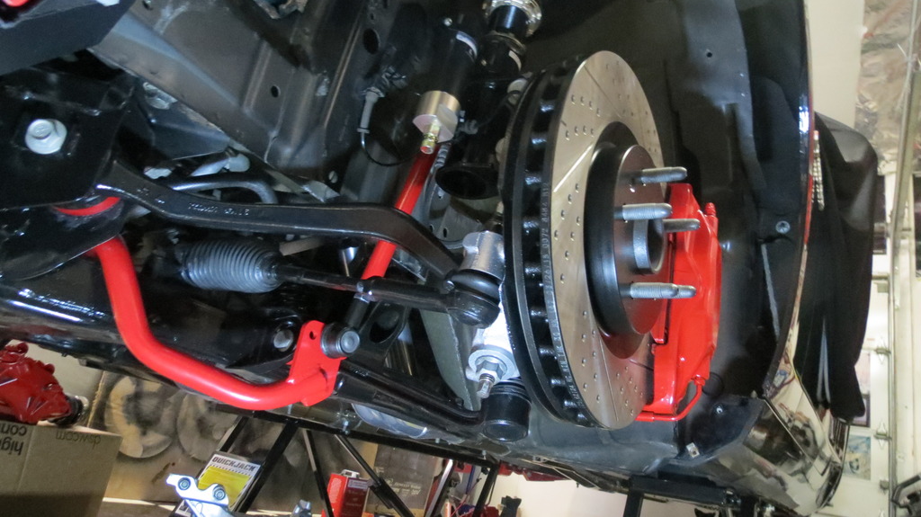

Calipers repainted and finally got my Camber Plates. Time for final assembly.
