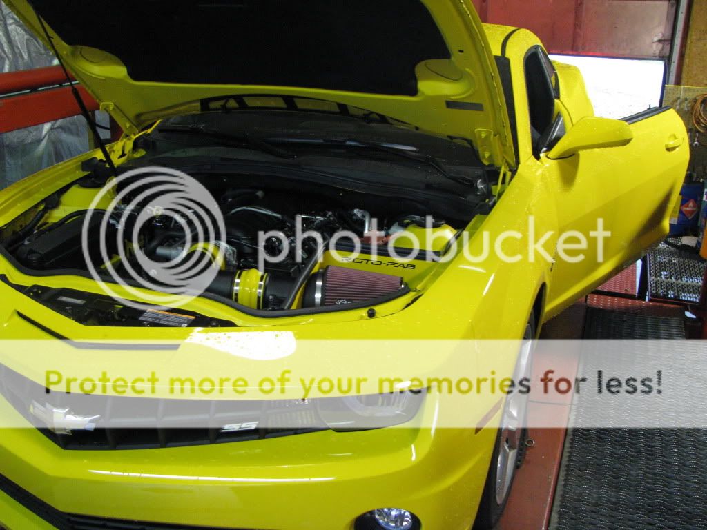

Roto-fab CAI LS3 dyno results
Well, we spent another Friday on the dyno, this time with an LS3 car. First, I would like to thank Bob and Brent at EPP for squeezing me in their schedule...again. Also, I would like to thank Dave for allowing us to test with his car. FYI, the car was completely stock before adding the Roto-fab CAI system. I don't have all of the information in graph form at this time, so I will inform you on some pertinent numbers as I explain the testing.

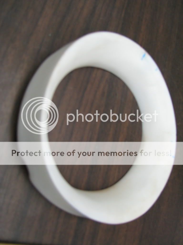

In addition to HP and torque, we monitored all of the same numbers as our last test session. This time we tested the stock intake first as it was already on the vehicle. The stock intake peaked at 369.1 HP and 368.5 ft/lbs torque. Avg HP was 342 and avg tq was 287.

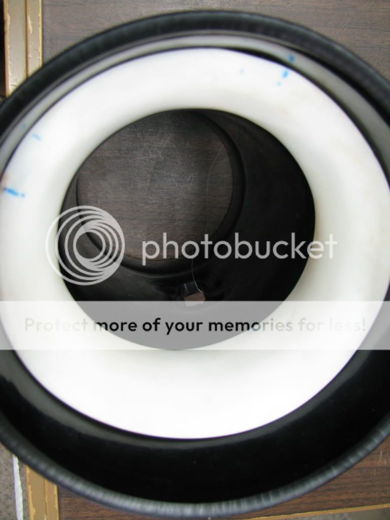

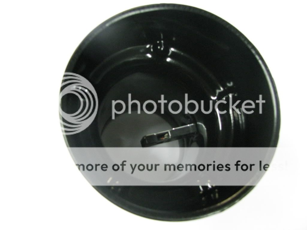

Along with a head to head comparison of the intakes, we also experimented with our MAF housing entry. We molded a "test plug" which would allow us to experiment with the air presentation to the MAF sensor. Our theory was if we were seeing some turbulence at higher RPMs due to the entry of our original MAF housing configuration, we would see the difference (improvement) with our plug. The first pic shown below is our original MAF housing entry. The second pic is the test plug, the third is the test plug inserted in the MAF housing.
The first pull with the Roto-fab CAI was performed with the plug in place as it was easier to install outside the car. We would later be able to remove it to test our original configuration. The first test was started after only a few minutes on the dyno to reach coolant and oil temps. During this pull, fuel trim was +.8 which is identical to the last stock intake pull. In spite of that, our peak HP was 378.9 with a peak of 392 ft/lbs tq. However, we did see high knock numbers on this run though-5.9 @ 6k. Next, we ran a 7 minute drive cylce on the dyno going through the gears and mixing up the RPMs. We then drove a few more minutes to reach our test temperatures before starting the pull. After all of the dyno driving, our fuel trim # was +3.9. This pull had a peak HP of 383 and 376 tq. The knock #s went way down and power numbers further increased after our drive cycling. We then removed the plug and made another pull. Our peak HP and torque remained the same.
The next several pulls involved testing with/ without our plug and performing drive cycles in between for "learning" time of the different configurations. At best, we saw an additional 2 HP with our test plug.

With the Roto-fab system, we saw a peak gain of 14 HP and 8 ft/lb tq. with an average gain of 12 HP and 10 ft/lb tq. Again, these are numbers very consistent with what our customers have stated.
Our test numbers were quite consistent with both the stock intake and the Roto-fab, so I am very confident they show accurate results.
