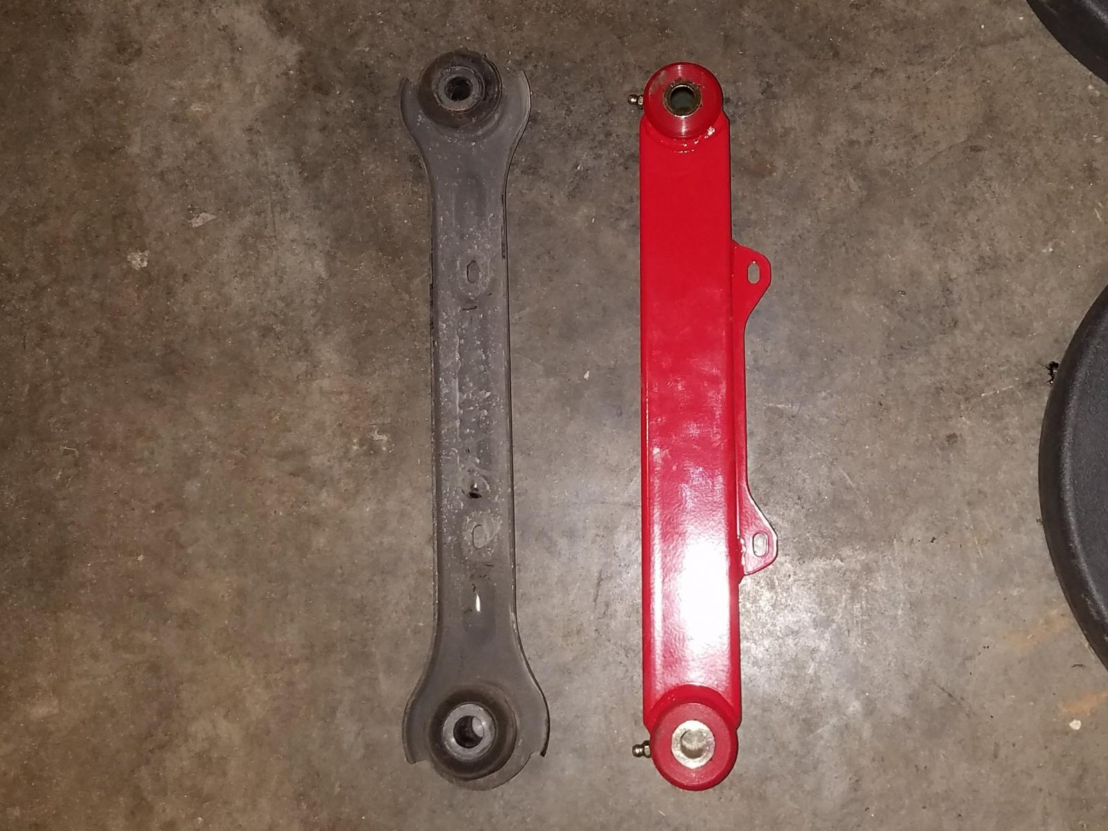

Next, I got some trailing arms and toe rods from BMR, with polyurethane bushings for the arms. Here is a side by side comparison of the OEM toe rod and the piece from BMR. Way stronger looking!
Getting the OEM trailing arm bushing out of the spindle was not complicated, just a little tedious. I used a puller that I bought at Autozone and modified a little to push the bushing out. After it was out, the poly BMR bushing went in with a hammer. Here was my puller

Here are all 3 parts installed.

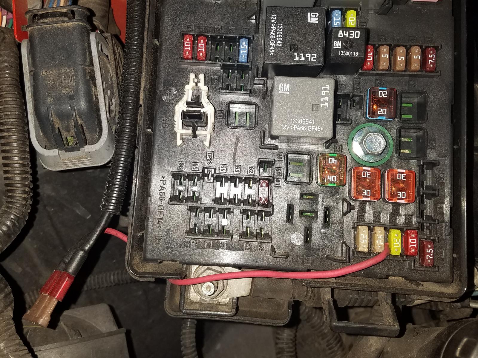

The first line lock I received had a faulty solenoid. After speaking with Hurst on the phone, they immediately sent me a replacement and didn't require me to send the faulty one back. I called a buddy over and we put it in. We used the connectors and wiring that came with the kit, but also used heat shrink for the connectors.
We spliced into one of the empty fuse spots in the fuse box, and ran the wires through the firewall and inside the center console.
