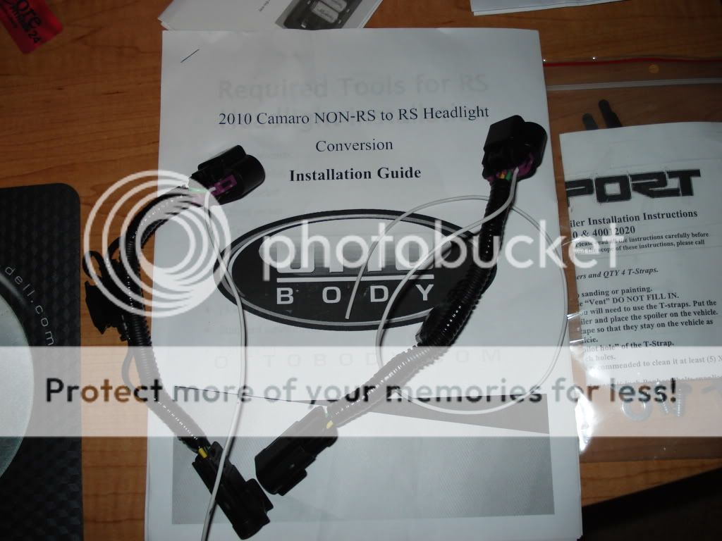

This is what you need from Otto Body
Just send him an e-mail, he'll set you up!
tcotto65@gmail.com

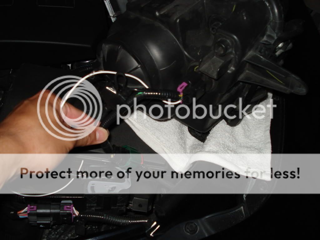

Their wiring harness has the plugs so all you have to do is pull out the old headlight, put in the new RS headlight, plug the factory headlight plug into the Otto Body wiring harness and then the wiring harness into the RS headlight. The white wire is for the Halo, and for that they said to cut the middle wire on the turn signal bulb and connect it to that.
Here is and RS headlight powered by their wiring harness. I didn't connect the halo yet since I won't get my other headlight until Monday.
