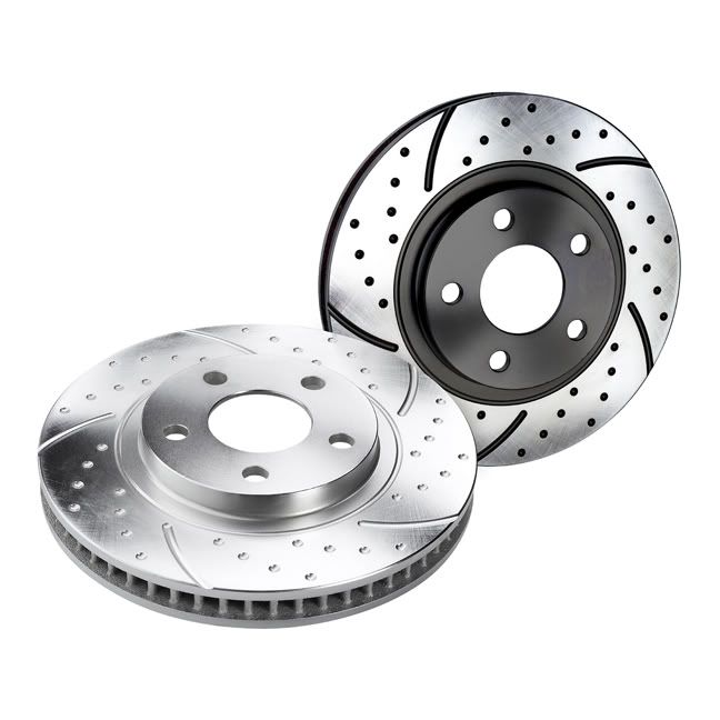

Posts: 739
Here is a pic of there Dimpled drilled!
SupremacyCustoms is offline   Reply With Quote
