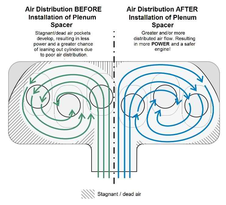

What is a plenum spacers and what does it do?
A Plenum spacer is a special spacer that sits between your plenum cover and intake manifold. Its main purpose is to improve air distribution (like our twin throttle manifold) between cylinders by slowing down the air speed inside the plenum chamber. As a result there is less of a pressure drop inside the plenum chamber between cylinders, and less air momentum, resulting in better air distribution and power. The change in airflow characteristics is shown in the diagram below.
Not only will our spacer help you make more power, it will also help prevent any costly rebuilds through dangerous lean outs that occur with these standard manifolds in high horsepower/boost applications (due to poor air distributions).
In addition to improving air distribution between cylinders, the increase in plenum volume also increases low down torque.
Made from the same thermal resistant composite material as our manifold insulators, means that further horsepower gains are to be had due to the reduction in air temperature. For further information about the material properties please check out our manifold insulators on auction
Attachment 336634
What's Included
Plenum spacer, longer plenum screws, and gasket maker. Basically everything you need for the insulation
What about installation?
Installation is very straight forward, requiring only the removal of your plenum cover to install the plenum spacer.
