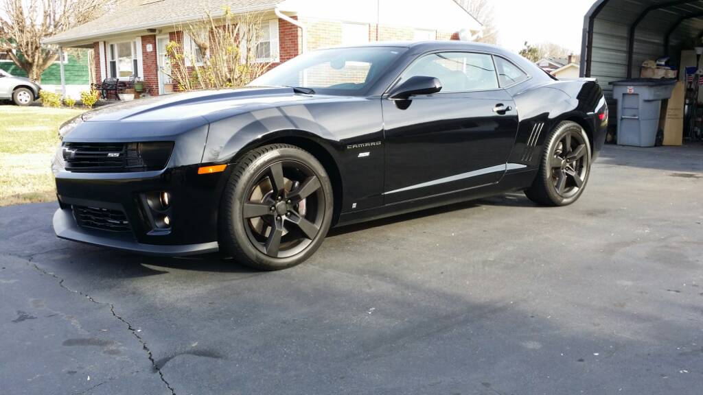

Best price for black and grey are at a hardware store. My 4 cans were $5.99 each at Home Depot. I checked out Pepboys and they had more colors. $7.99 for black & grey, $10.99 for pink, red, blue, and the gloss coats.
Here are my 2014 LS wheels sprayed in black. Did this 2 Saturday's ago but wanted to wait until I washed the whole car to get a photo.

Those look nice dude.

I didn't like those wheels until now.
