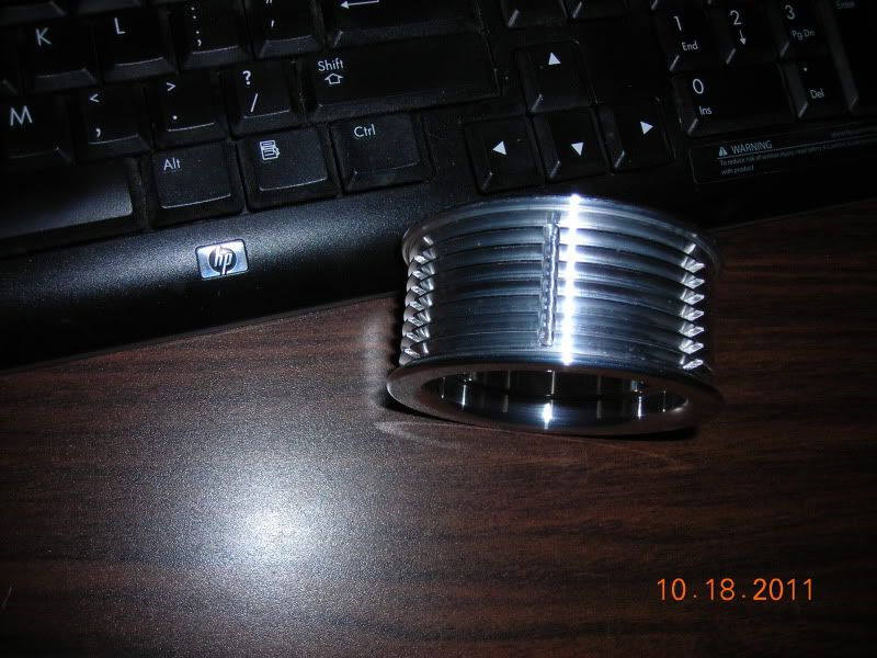

The rip pulley has cuts in the pulley giving a small edge to grip the belt.
You could just try to use a rip 2.8 and see how it goes. What belt you use is a big one too! Everyone has a kind of belt they like. I ONLY USE Gates HD Fleet runner "Green" belts... Strongest I have found and very little slip.
Over driven crank might not be the way to go if your never going to forge your engine. But if you are hands down go OD cog.
The problem being that if that pulley produces the boost a 2.8 is supposed to PQ will not be a happy camper!!

Originally Posted by jrpxxii View Post
This might help some of you trying to figure out what the psi should be with pulley swap:
The stock boost for any Magnacharger TVS 2300 Supercharger Kit installed upon any 2010 - 2012 Camaro 6.2L V8 with a 3.80" Magnacharger Pulley installed on it is only 6 psi at wide open throttle.
- 3.60" pulley: expect 2.0 psi. more boost over stock pulley -Total boost 8.0 psi
- 3.40" pulley: expect 4.0 psi. more boost over stock pulley -Total boost 10.0 psi
- 3.20" pulley: expect 6.0 psi. more boost over stock pulley -Total boost 12.0 psi
- 3.10" pulley: expect 7.0 psi. more boost over stock pulley -Total boost 13.0 psi
- 3.00" pulley: expect 8.0 psi. more boost over stock pulley -Total boost 14.0 psi
- 2.90" pulley: expect 9.0 psi. more boost over stock pulley -Total boost 15.0 psi
- 2.80" pulley: expect 10.0 psi. more boost over stock pulley -Total boost 16.0 psi
- 2.70" pulley: expect 11.0 psi. more boost over stock pulley -Total boost 17.0 psi
PLEASE NOTE: If running Long-Tube Headers, you will lose 2 PSI of Boost and to gain that back, choose a pulley 2 sizes smaller!
WARNING: The only way to install the 2.70" Pulley is to have the Jackshaft Housing machined down for it to fit properly. Some Jackshaft Housing Castings are made differently in sizes and do vary, as to what the smallest pulley you can use without maching. The smallest size we recommend is 2.80", without any machining performed on the jackshaft housing casting area.
