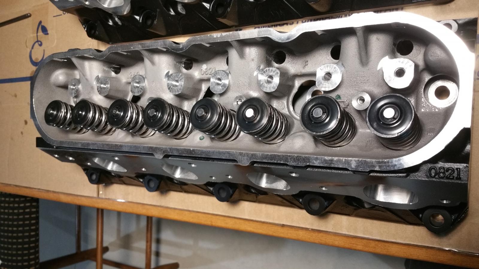

That's a good spring but I'm not a fan of dual. They add weight to the valve and lack the control of a beehive. Problem is that at .650 there aren't many beehives that accommodates that. Lazer and i have changed out stock springs/retainers for psi 1511 and ti retainers and that loses 1lb in the valve train. But thise springs are only good to .625 lift. A double spring/steel retainer would add weight to the valvetrain even vs stock
Did you use atleast use ti retainers?

Yes, ti retainers...

If you think your having valve control issues i would chuck those springs in a hurry. Maybe even look at a cam that's nice to the valve train.
My friend runs a comp conical spring on his dirt ls motor that would probably work for you. He runs them with stock ls3 valves and a hydraulic cam to about 8200 rpm.

Thanks for the advise, but I'm happy with my set up. It's safe and reliable... and when I want more I open the bottle....
