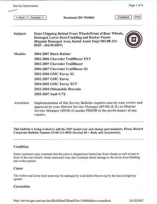

FWIW -
There is precedence that GM will admit fault with paint chipping issues, but only as a result of design flaws that cause road debris to be thrown up off the road. With the shape of the TB body being what it is in the lower portions this was a prevalent problem for that model, it didn't however get any attention until the TBSS was out - I suspect b/c enough SS owners cared enough to complain where standard TB owners probably didn't. The addition of 20" wheels probably only made the problem worse as well.
Obviously different issues on different vehicles, but something to lean on... they may eventually issue a TSB for camaro paint chips... it just won't be in the first few model years.
The fix for the TBSS ended up being a rocker panel repaint and application of clear bra film... I took advantage of the repaint around 12,000 miles but the clear bra stuff looked terrible so I just had them leave it off... the TSB could only be performed once per vin anyways so they didn't care.
For reference:
