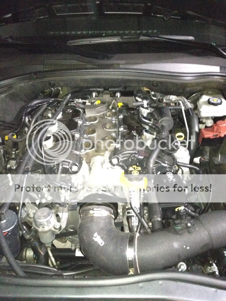

Ok...engine is reassembled. Pretty simple install back onto the engine, the back bolt was hand tightened because of obvious reasons, also the other two short bolts in the back, couldn't be installed back on because of the elevated position of the IM. The one thing I couldn't install back on was the front bracket/post that sits on the left side of the TB. Pictures attached.
The only thing that was weird is that, the bolts Mace sent me could only be fastened using a hex wrench/L-Wrench. So I had to hand tightened them as well, very carefully, I figure I can take it to a local garage and have them make sure it's tightened to torq specs I have a torque wrench, but I don't have the bit with the right size.
Now to performance, took her for a drive and HOLY CRAP! The boost in power is insane, last time I felt such power upgrade was when I installed the LTs. I noticed that the RPM range is a tad big higher while cruising, not a whole lot but a little. The dead spot between 2000-2200 RPMs is gone from gears 1-5. And most importantly the tire marks to pavement test was OUTSTANDING! Fishtail and all

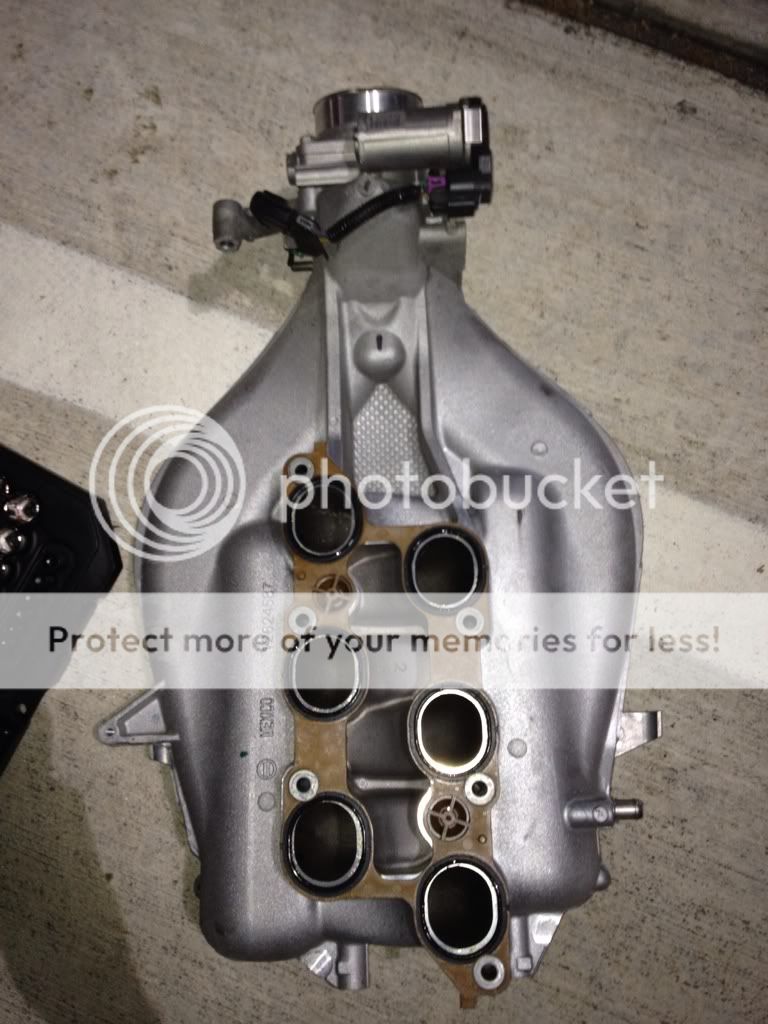

Everyone's seen this....
Underneath the IM....

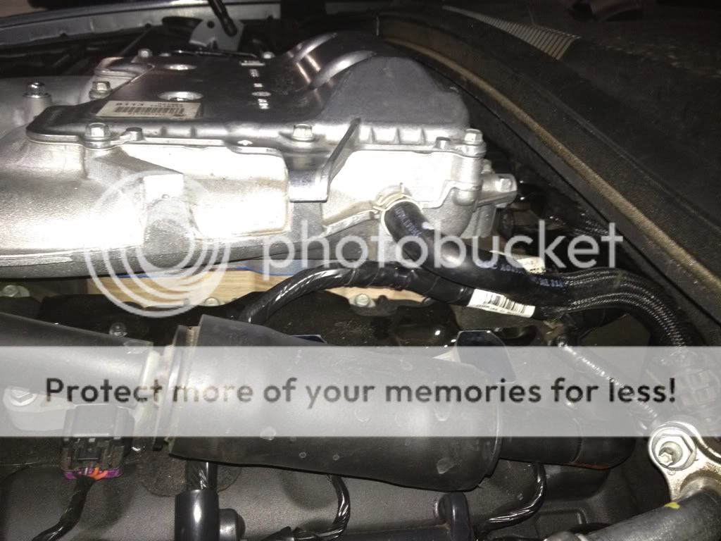

Insulator attached, being cured....

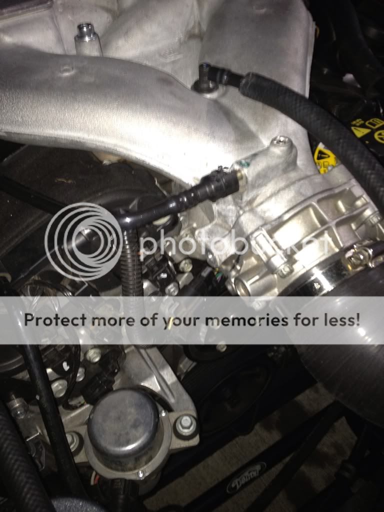

Back on to the engine, notice the black bracket in the rear, I guess I can't use that anymore....

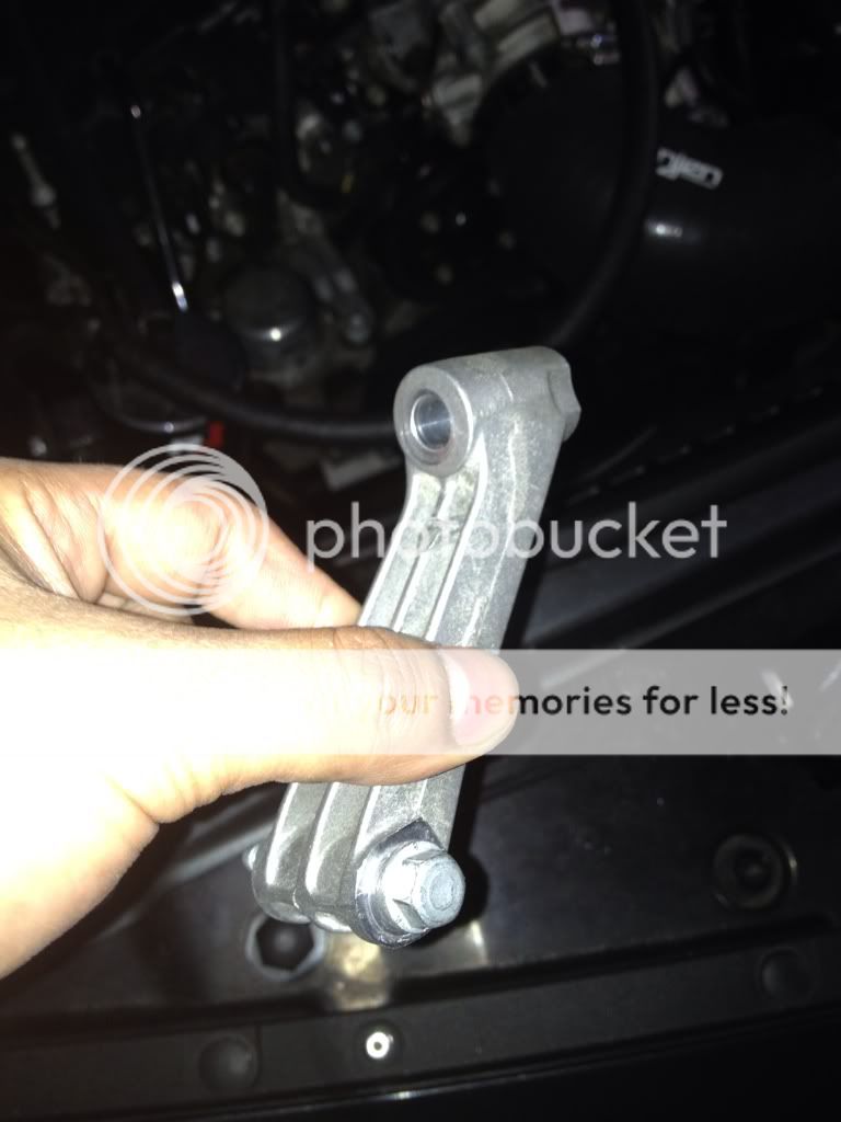

The front bracket I was talking about....
This is where it usually sits....

I made a little 1" extension for the back horizontal bolts to allow re-attachment. Place them on the manifold before putting it back on the engine with a washer between the IM and new bracket to keep things inline.
Then just loosen it and let it swing down to bolt to the orig. hole. Took some effort but was able to use the driver's side- not enuff room to get to pass. side tho.
Did the same with the front TB attachment point.
