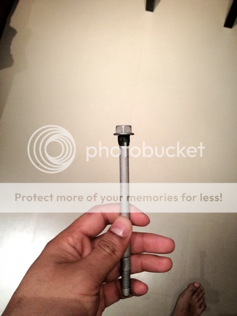

Btw.....have a question, these are the stock bolts from when I removed the IM.
Is that black stuff needed when I install the IM back onto the engine? I figure the RTV took care of whatever the black stuff was doing before.

That's like the equivalent to an exhaust gasket. It's there to keep it air tight. It seems GM incorporated that idea onto almost every engine bolts on the LLT.
So do I need to put that back in there? LOL

you should..I'm sure its there for a reason lol.

you sure it's a airtight thing? I thought they were there to resist engine vibration and to help keep them from backing themselves out because of the vibrations.

Hmmm....well only like 4 of them had it, I think the ones on the plenum cover, but I lost one will taking the stock bolts out. Think Home Depot/Lowes has em?

I didn't even notice those rubber rings on my bolts. Ooops. I never swapped them.
