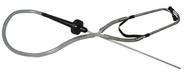

Take a long screwdriver or even a broom handle and hold one to your ear and the put the other end in contact with some part of the motor and you can better hear what is going on. Move around to isolate the area where the noise is comming from. Just be carefull around the belts and rotating componants. They sell auto stethoscopes but this works just as well.
