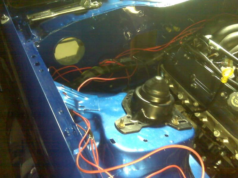

Does this count as a "little" progress?
This is love at first site, if I have never seen it before:
Ok, I think some of you guys are going to be really jealous with this next part. The reason I say that, is because not only did I not have to loosen the motor mount pedestals, or the motor mounts themselves, I also didn't even have to jack the car up off the ground, well partially anyways. All I did was jack the rear axle up off the ground about 8", left the front tires on the ground, and did a lot of lowering and then man-handling the motor and transmission on the hoist and lowered them down together from the top. Both bolts for the motor mounts went in without much problem. In fact, the driver side one went in right away, and I just had to have my friend push down on the block a little while I knocked the passenger side bolt in with a rubber hammer. Easy as pie.
Sorry for the crappy BlackBerry pictures, I am definitely going to clean her up this week and take some really good ones with my Canon DSLR. I've been using my phone to take pictures of most of the progress because it's so handy to use instead of swinging around an actual camera.
Ok, and one more positive note before I begin with the negative that I found tonight.
The hole I cut for the shifter seems to be just right. I cut it in the correct spot, it could be a little smaller but I think the lower shift boot will cover most of it.
Ok here's the negative. Am I the first person to try using the Alston Racing sfc's and the Spohn T56 crossmember? The reason I ask, is because I haven't come across anyone else with this problem before. I'm thinking I will need to notch out a chunk of the mounting face of the cross member to clear the front of the sfc. You can see how bad it really is, there is like a 1/2" gap between the frame rail and the cross member, creating horrible ground clearance, as well as me not being able to bolt down the cross member all the way without breaking it. I'll wait to get some input from you guys before I start hacking away on it.
This should be sitting flush with the frame rail:

I have never heard of that brand of sfc. I use the Spohn SFC's and crossmember, the SFC's from Spohn weld up in a different location than those ones.
Thats about the size of the hole I cut for my shifter. Mine might have been a bit narrower but yours looks good.
Congrats on the easy install, too few of car projects go that way.

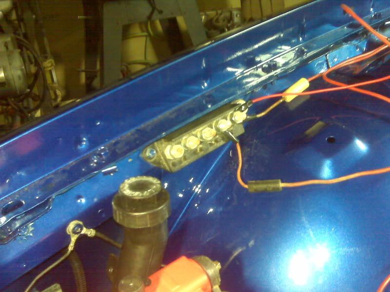

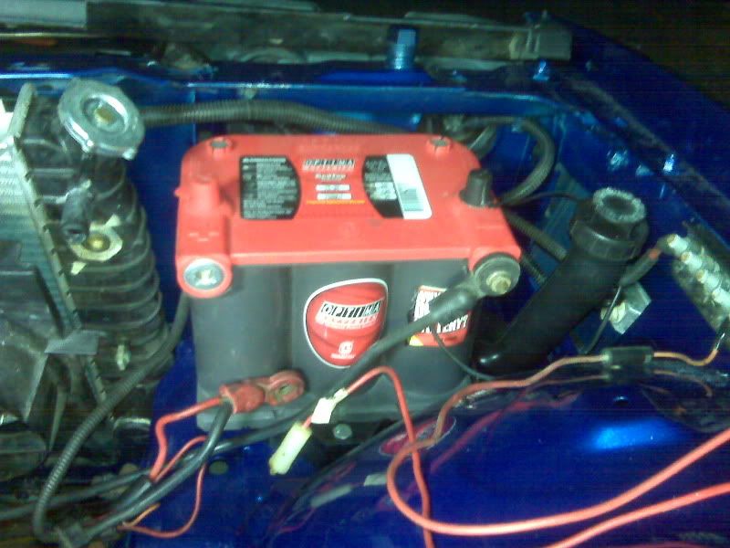

I'm pretty sure that if I hooked up the 12v wire to the alternator, and installed the pushrods and rocker arms (and other misc things like radiator hoses, PCV system, etc) I could fire this baby up! I'm working on figuring out what a few wires go to in the swap harness right now, there's about 3 or 4 of them that I haven't finished up yet. It's getting very close, and with Vet's Day on Wednesday, and my work being closed (bank), I think I'm going to get very close to test-start this week. Cross your fingers for me.
Here's a tease at what I got done tonight. I mounted a power distribution block by the battery so I can run the positive battery cable to it, and then feed all the wires in the harness that need 12v from there. I will be putting loom on all the wires that go to this, so it will clean up nicely. I am running all the wires under a fender brace on the passenger side and then behind the block.
Here you can see that I ran the battery terminal cable behind the battery and the length fits perfectly where I have the power dist. block mounted. It wraps behind the battery by the headlights and comes back by the filler neck for the coolant overflow tank. This terminal went to the alternator on the stock setup, but since it would be hard to get it to stretch to the LS1 alternator, I'm going to run a wire from the back of the alternator, behind the block around the passenger fender like the rest of those wires and to the dist. block. I think it will look nice when done.

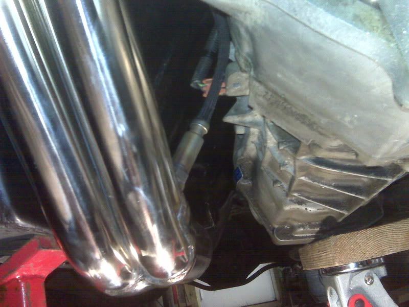

Got a lot done tonight. The passenger side header is on, I put my Stage 8 locking bolts on with the locker plates on both sides, re-installed the fans after I did some more trimming on the shroud and zip-tied the fans to the radiator. I also wired up the fans and put loom up the wiring all the way to the relays, so that looks nice now. Also, ran all the 12v wires over to the power distribution block and got some loom on them, still have more cleaning up to do on that area. I'm going to order some parts for a CAI this week, and install the pushrods and rockers, and finish the fuel line and then it should be ready to fire up.
Just some pictures of the passenger side collector clearance with the transmission and the o2 sensor, and some other various shots of my progress tonight.
