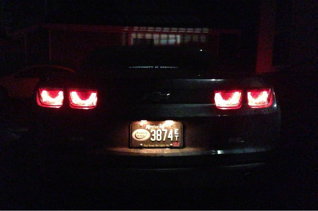

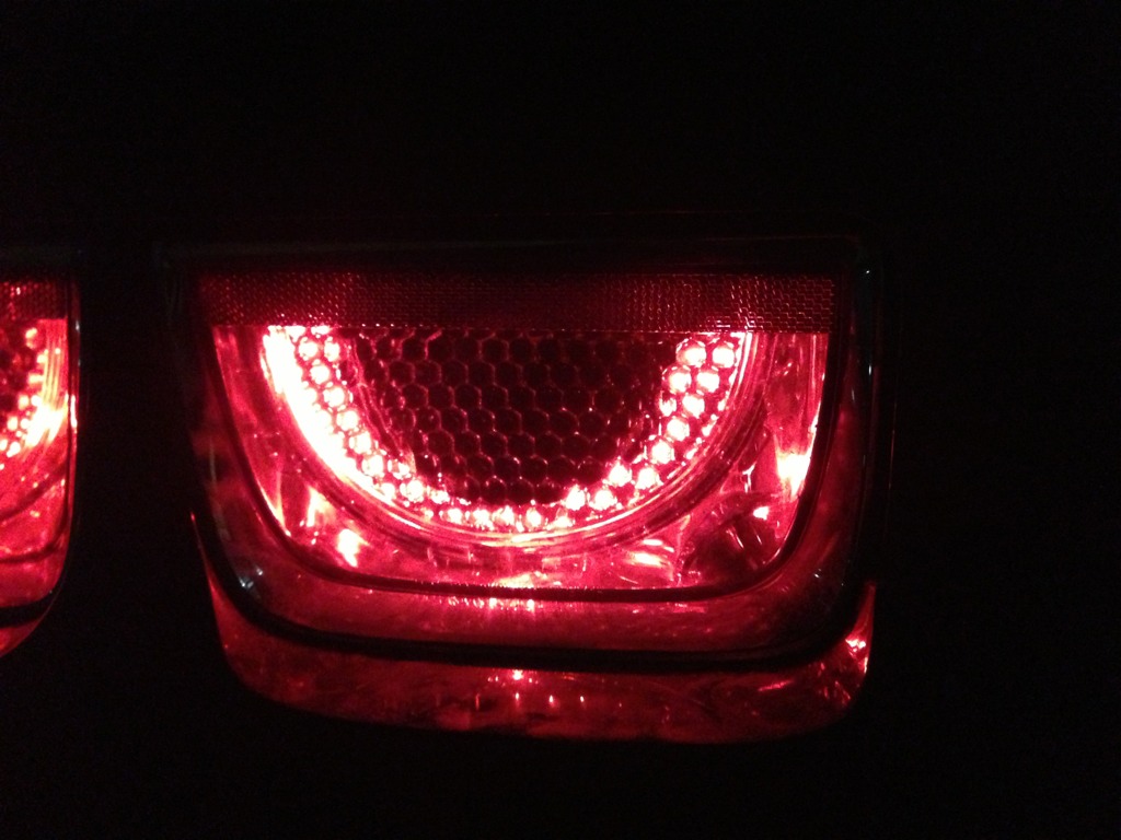

Here's a few more pics of mine. Not the best of pictures by any means.

@ BudMC
Very nice. Thanks for the close up pic as well.
