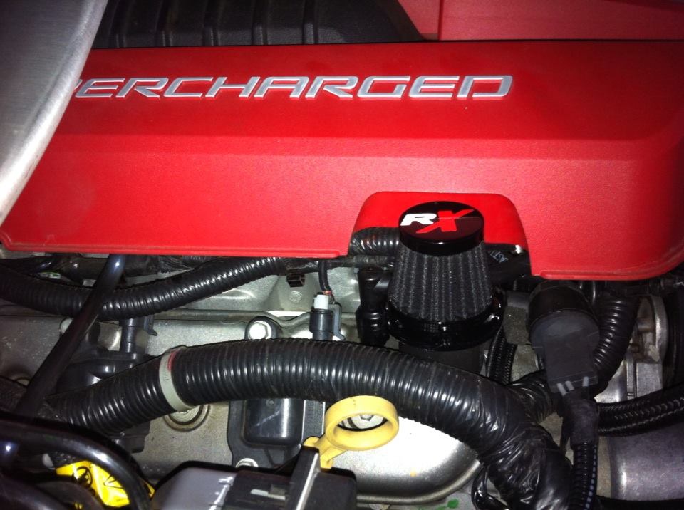

This is a crankcase breather with a one way check valve to vent excess pressure. I installed this on my car because I noticed some oil on the back of the motor where it meets up with the transmission. since putting a crankcase filter on my car, I have had no more oil in that area.
Roto-Fab CAI, Texas Speed Headers, Texas Speed X-Pipe, Texas Speed LS3-B Blower Cam, Metco 9.10" Crank Pulley, Metco 2.5 Upper Pulley, ID 850 Injectors, LPE Ported Throttle Body, Alky Control Methanol kit, E2 Catch Can, 610HP / 608 Torque.
I fail to see how an open breather vent helped what sounds like an oil leak. Likely any remnants of function of the crankcase ventilation system have drastically changed with this open breather. OEM's must use closed crankcase vent systems per the Federal Clean Air Act. These crankcase vent systems function based on calibrated orifices and fresh air vents fed with filtered air. They are designed with a very specific purpose and are crucial to the long term emission durability and general engine durability. These catch cans and open breathers look slick but provide 0 benefit.
Blueclyde is offline   Reply With Quote
running 15 lbs. of boost...I think that it pushed some oil past the rear main seal. I was not running a catch can or a Crankcase breather at the time, now I am and there is no more oil in the area that I had originally spotted it in...Cleaned with some break cleaner and its still dry. it mush have had some benefit.
