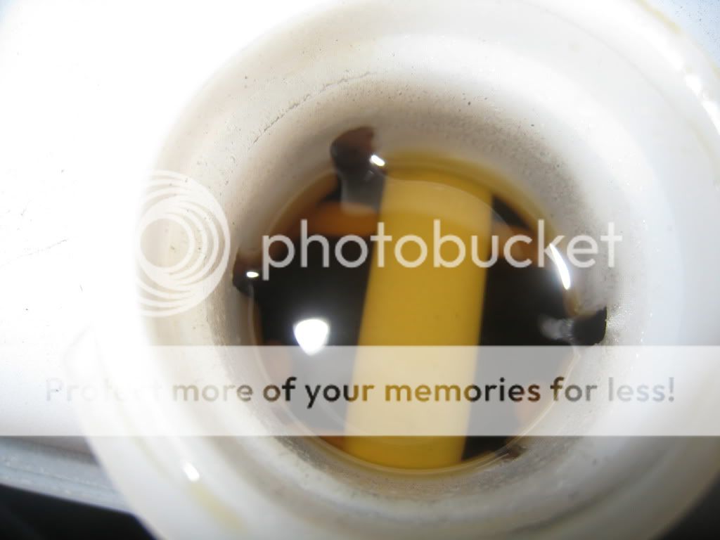

Back from the dealer and of course they can't find anything wrong.....OPERATING AS DESIGNED.......huh? What really pisses me off is I told them the shifter is very notchy, binds and has gotten stuck half way into second before. They said they couldn't duplicate the problem and it's operating as designed. Ok, now it's time for a video:
crunchy! turn up the volume.......
How does my fluid look?....

Service tech at local dealer claims the "notchy" feeling is due to "beefy" synchronizers and is normal. Is this BS? I don't know. My drivetrain warranty is already history due to mods, so I think I will simply wait for something to crap out and replace with aftermarket once the aftermarket clutches get to a design point where the chatter/noisiness has been designed out.
