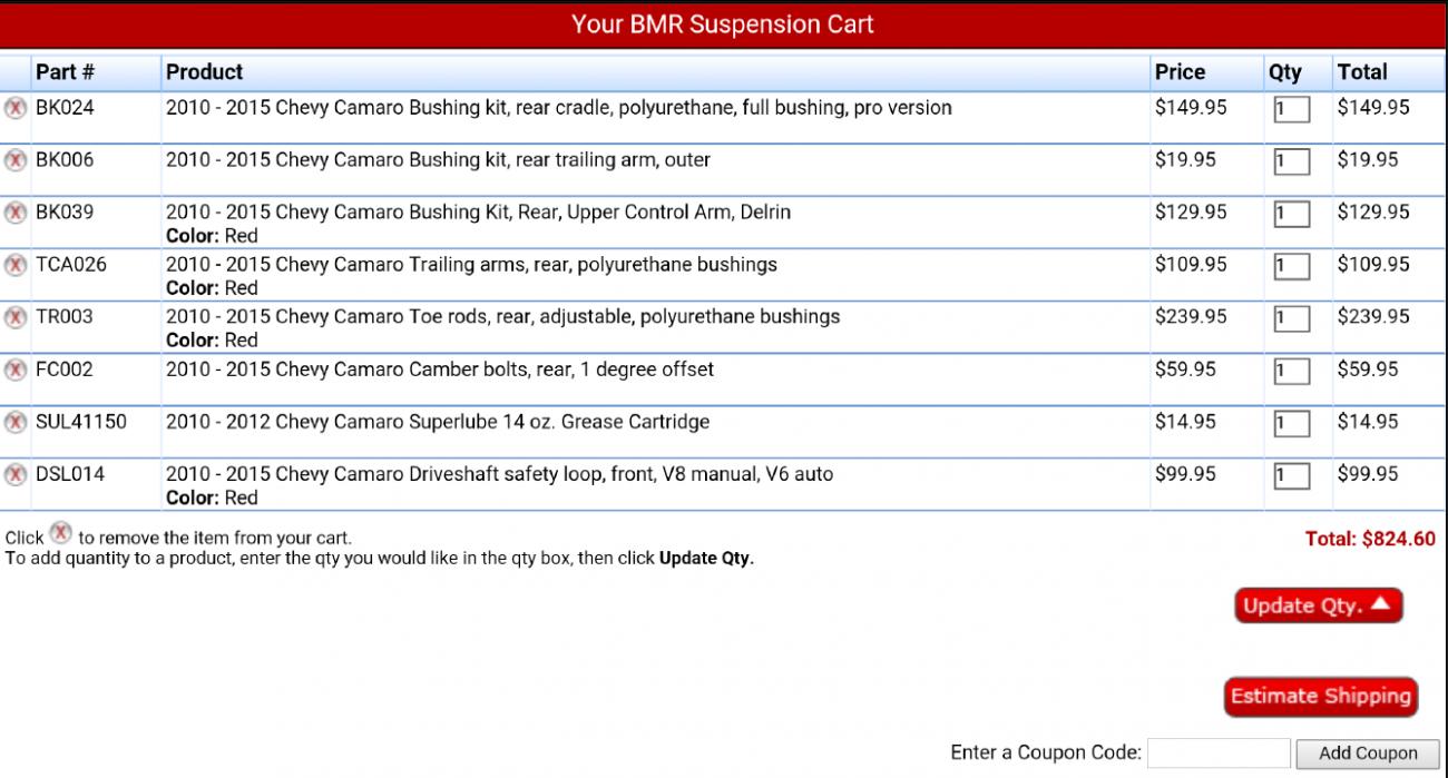

So I took advantage of BMR's black friday special today and ordered all my suspension parts for when I get the SS cradle. I was originally going to order non adjustable toe rods but T.C. with BMR said that a lot of customers end up needing the adjustable ones later on especially on lowered cars. I have my doubts if I really needed them or not but I went ahead and got the adjustable ones. Also got a driveshaft loop and some camber bolts. Wasn't planning on spending that much but I did save over $200. With shipping was going to be almost $950. Thanksgiving price... $703 shipped! I feel like I got a good deal.

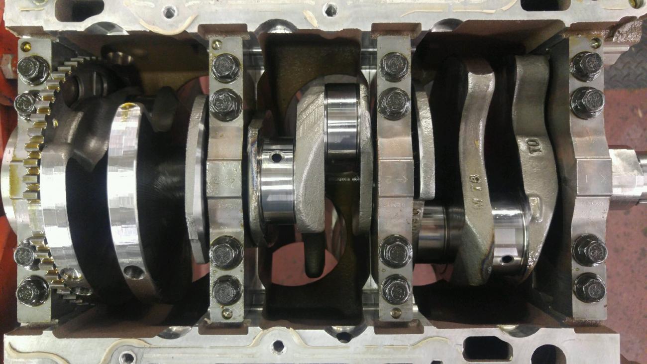

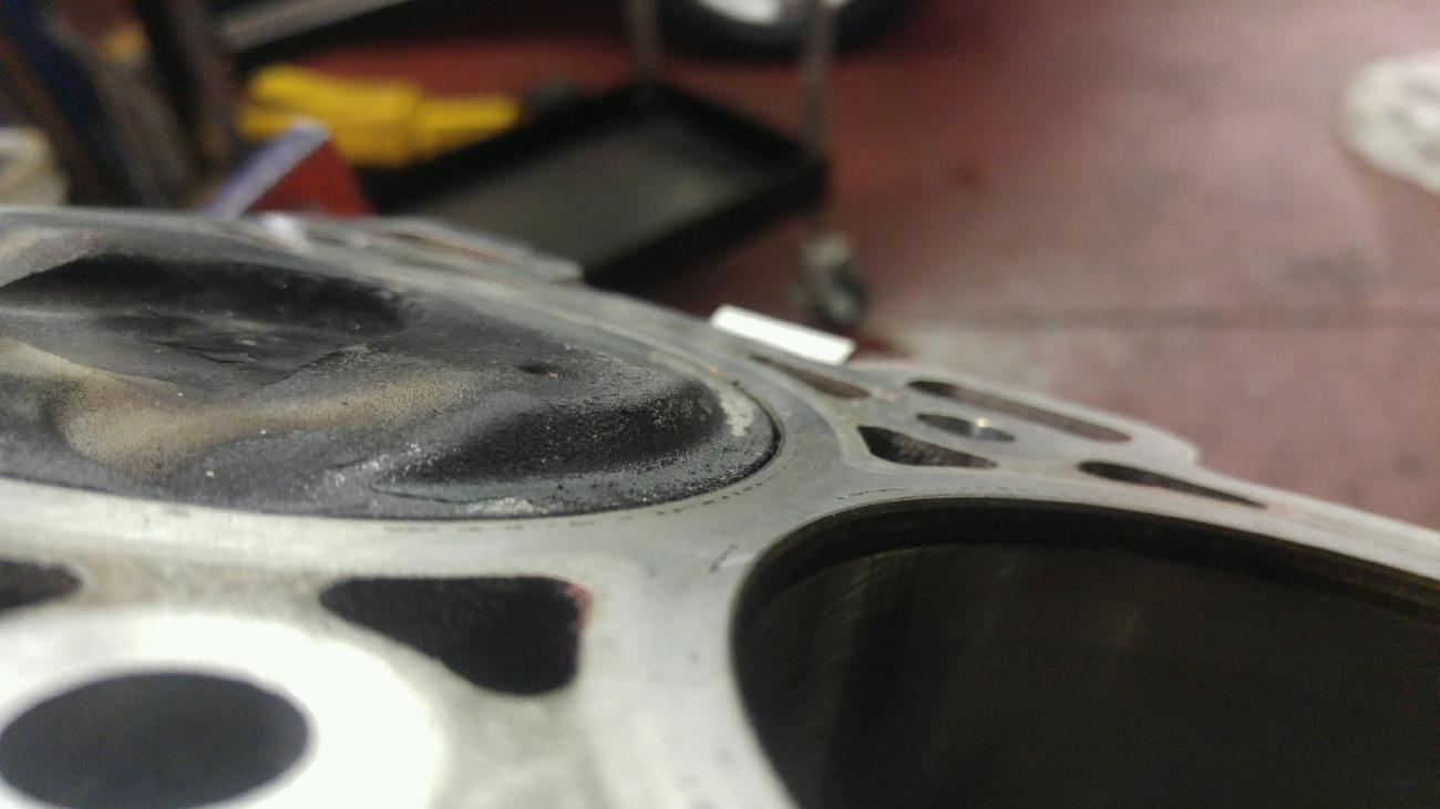

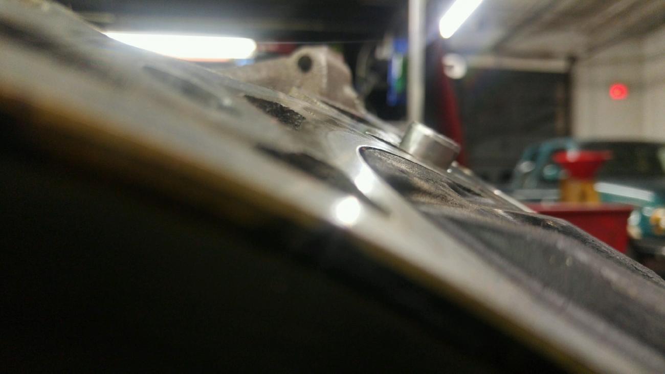

So now that I have this new motor apart, I think all the rods in my blown motor were slightly bent. I need to dig them back out and start measuring them all.
Before with my bad motor, test fitting Jason's rods would put the tops of the pistons at zero deck height while the factory rods had the pistons around .020 - .030 in the hole. So I assumed the new rods were longer. No doubt they were longer, you could see it when I hung both rods from the same wrist pin.
Well when I pulled the heads off this '15 motor I was surprised to see all the piston tops even with the deck. EXACTLY like with Jason's rods before. So I hung one of these '15 rods on a wrist pin next to Jason's rod and they match up. So unbelievable to me, ALL the old rods had to be bent. #6 was definitely bent you can see from the pics I posted a few pages back.
So I've pretty much come to the conclusion that my engine failed from compressing oil and trying to hydrolock at 7000rpm. Oil that was collected in the intercooler. Because when I pulled the boost tube and intercooler there was tons of oil in them. Too much oil to have been puked out when the failure happened. The intercooler had oil up to the bottom of the silicone couplers. I was getting oil going into my air filter at WOT, I didn't think it was that much but it might have been more than I thought. Just collecting in the intercooler. #1 was the cylinder that failed and #1 is the first cylinder to be reached by liquid. Just makes sense, the ONLY way rods get bent like my #6 rod is compressing a liquid. #1 prob got some of that oil at full boost and rod gave. Just my theory but no doubt rods were bent.
Here's pics of this '15 engine and the pistons being flush with the deck.

More pics

You are correct in your evaluation of this engine failure. I have built turbo motors all my life and on everyone of them, in order to avoid the issue of the intercooler collecting oil and/or condensed water, you simply drill a .040/.050 diameter hole in the lowest point of the intercooler and as close to the outlet as possible. This will completely eliminate a slug of anything getting into the intake. Never had a problem in the many, many builds I have done over the years. And don't believe anyone who says you will loose any significant amount of boost because you won't. Yes, theoretically but you couldn't measure it without extremely sensitive instruments. All condensation of any oil/water will automatically be expelled out of that tiny hole as it accumulates. I have seen so many blown motors due to this one small oversite.
