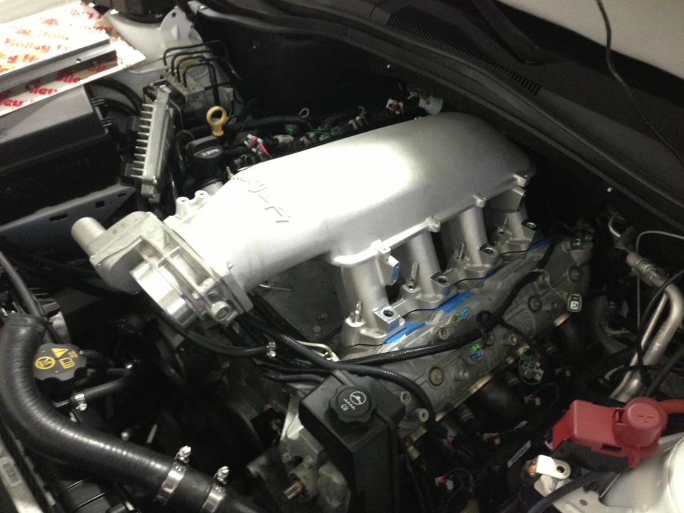

I have a friend that shortened the runners on the intake to make it fit, without having to cut the cowling. I would love to see how it performs with the shorter runners.

LS-3, ProCharger D1SC

Originally Posted by Nightmare2012 View Post
Any possible way of keeping the wipers with this intake?
Only way I see it is with the last pic in the post above yours. He cut the runner lengths to clear. Not sure how much that would affect low end tq but at least it fits.
Attachment 574464
Would be great to see some results of the shortened intake, a nice job was done modifying it!
I'm sure in a boosted application it would be great but am wondering about N/A. The runners are probably similar in length to the center runners of a single plane carb style intake.
