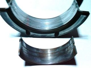

Originally Posted by POS Dakota View Post
Wideband? I don't need no freaking wideband!!!!!
I did this a while back by not paying attention.
damn! you were running rich too hu? sucks to hear the bad news. what did youy end up doing?
A much bigger badder rebuild of course.
That happened on one of my chryslers a few years ago using that SCT Bullsh...
One thing I can't stress enough is the importance of tuning ON THE DYNO. I'll never install someone's guesstitune again. And you have no one to blame but yourself if you do and it goes bad.
I just laughed it off and placed a very big parts order that night...you know, to make myself feel better.
