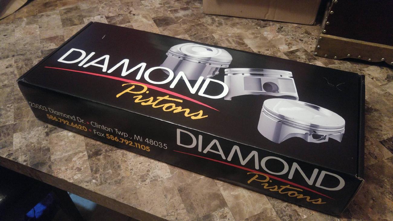

My pistons came in today, everything looks good so far. I'll have to do a lot of measuring tomorrow and see how the pins fit the rods.
They threw in an extra piston for only $50 which will be nice to have just in case. So that brought it to $1,250 for the set of 7 pistons, and rings, pins, and retainers. That was a little more than I was expecting but they are coated and gas ported so that added to the price.
