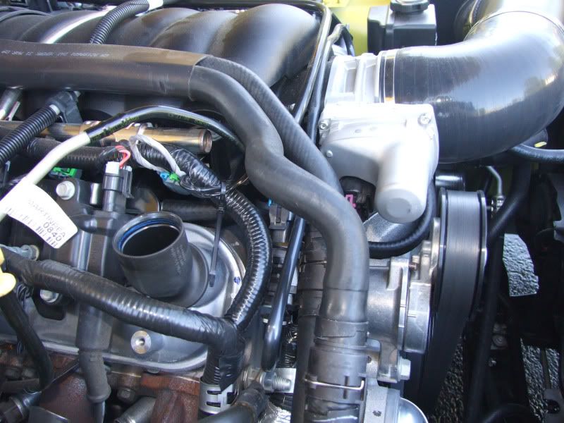

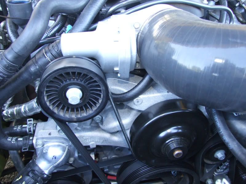

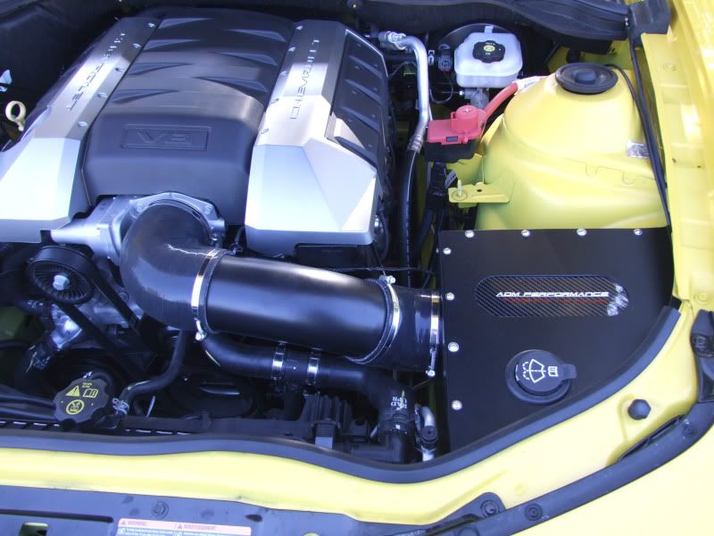

Okay, here's some pics of the install. First the whole engine bay.

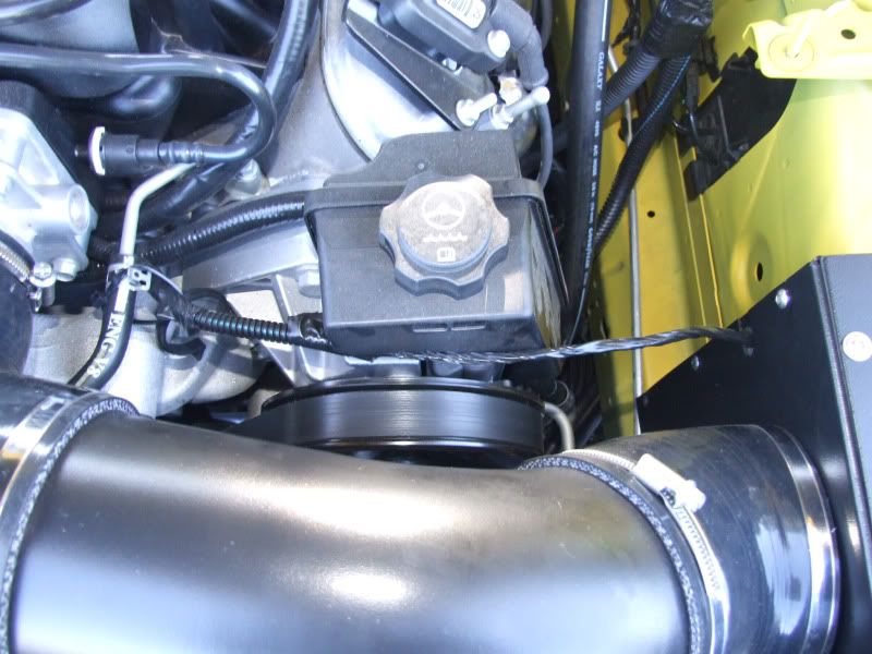

Next is the MAF wire harness. Ended up very taut. Oh, you can also see where I relocated the jump-start lug - it's right above the power steering cap. There was an empty slot for it and one already there a few inches toward the rear.
Next is the PCV tube. Note how it touches the block between the two pulleys. Not sure if that's ok or not; instructions didn't say clearly.
Lastly the PCV tube routed under the wiring harness to the manifold.
The MAF wiring and the pcv tube are was concerns me the most. If the way I've got needs to be adjusted please let me know.

i routed my maf wire behind the powersteering pump seemed to fit and look better back there and had some slack i pulled the clip off the water pump neck also and put it around the other wires running behind the p/s pump also onthe pvc hose before connecting the 90*elbow to the tb i pushed the hose under the tb in your picture its right below the lowerleft tb mounting bolt and it will come out behind the round part sticking out of the tb away from the belt tensioner hope this helps you any

I tried putting the hose there first. That's when it popped out of the 90" hose. I checked it again cause the picture makes is look like it's touching the upper pulley, but there is actually over an inch of clearance.
Excellent pictures guys.
I want to make a couple changes to both your Installs.
The N/A car(car with no supercharger) needs to loosen all the hose clamps ans rotate the 45 degree hose more straight up and down not more toward the radiator hose like the pic shows.You will notice the 4" powder coated pipe will want to find its way into the 90 and 45 degree slightly more.
Also on this car I will have to agree with the s/c owners reply on running the maf wires on the backside of the power steering pump as it is a better idea.
(you will need to remove the tye wrap)
Also I like to see the 3/8 valve cover vent hose tyed to the Throttlebody Wiring just aft of the connector by .1-.2 inches.This will hold that hose better away from the pulleys and what not.
The valve cover is not a ground(it is completely rubber isolated).Here is were we like to put the ground stud.
ON THE S/C CAR
I would also rotate the 4" powder coated pipe and 45 elbow a bit more aft away from the upper radiator hose.
All these items will be added to our instructions as they are very helpful.
Andy

A pic of the install completed
Andy
